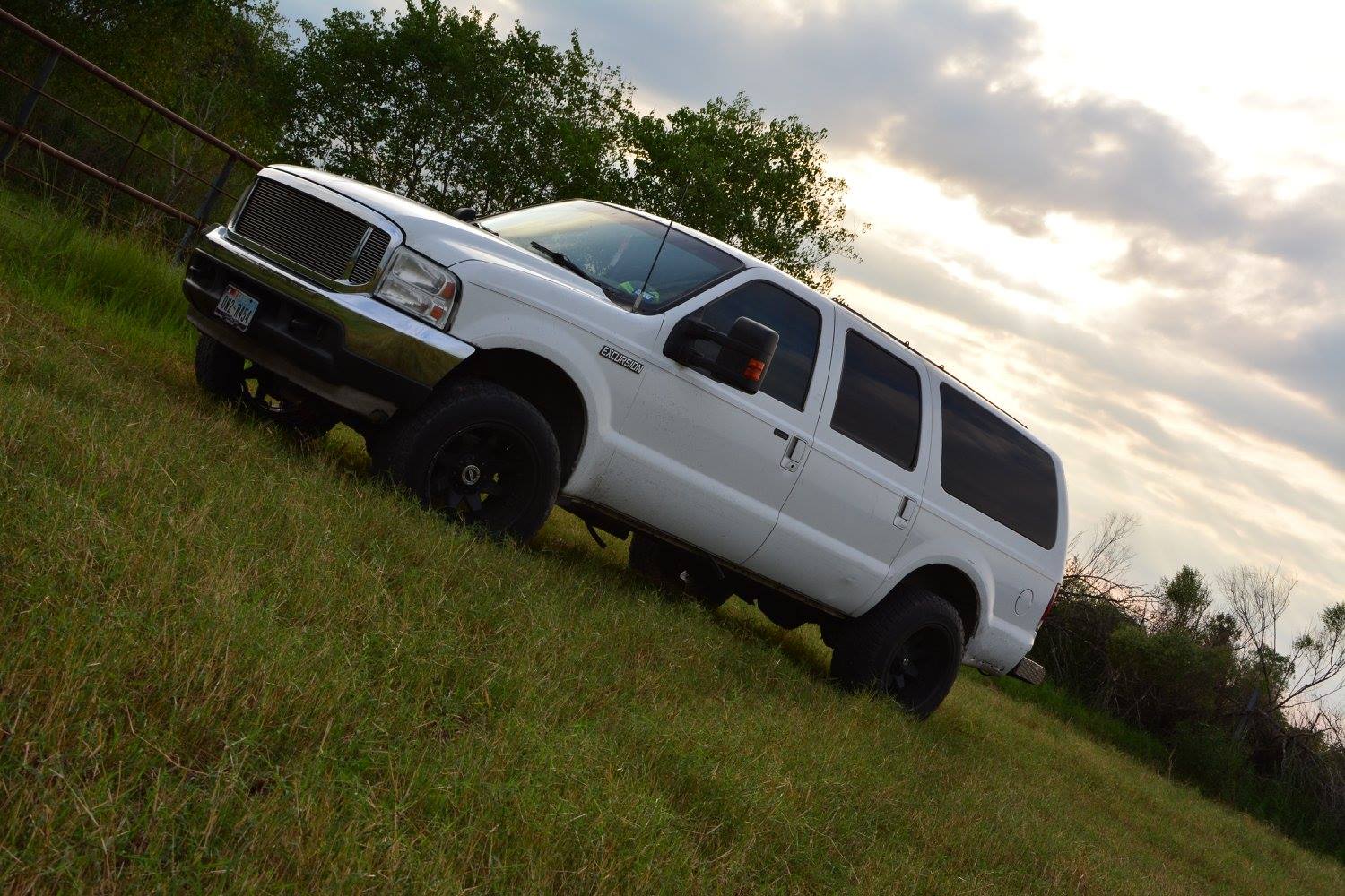

Here's a pic of my EX with I believe a 4inch lift.
325/65's (33in.) tires.
Don't mind the fat-azz in front :D
So that should fit fine on stock height.
Shot of the tire and well.

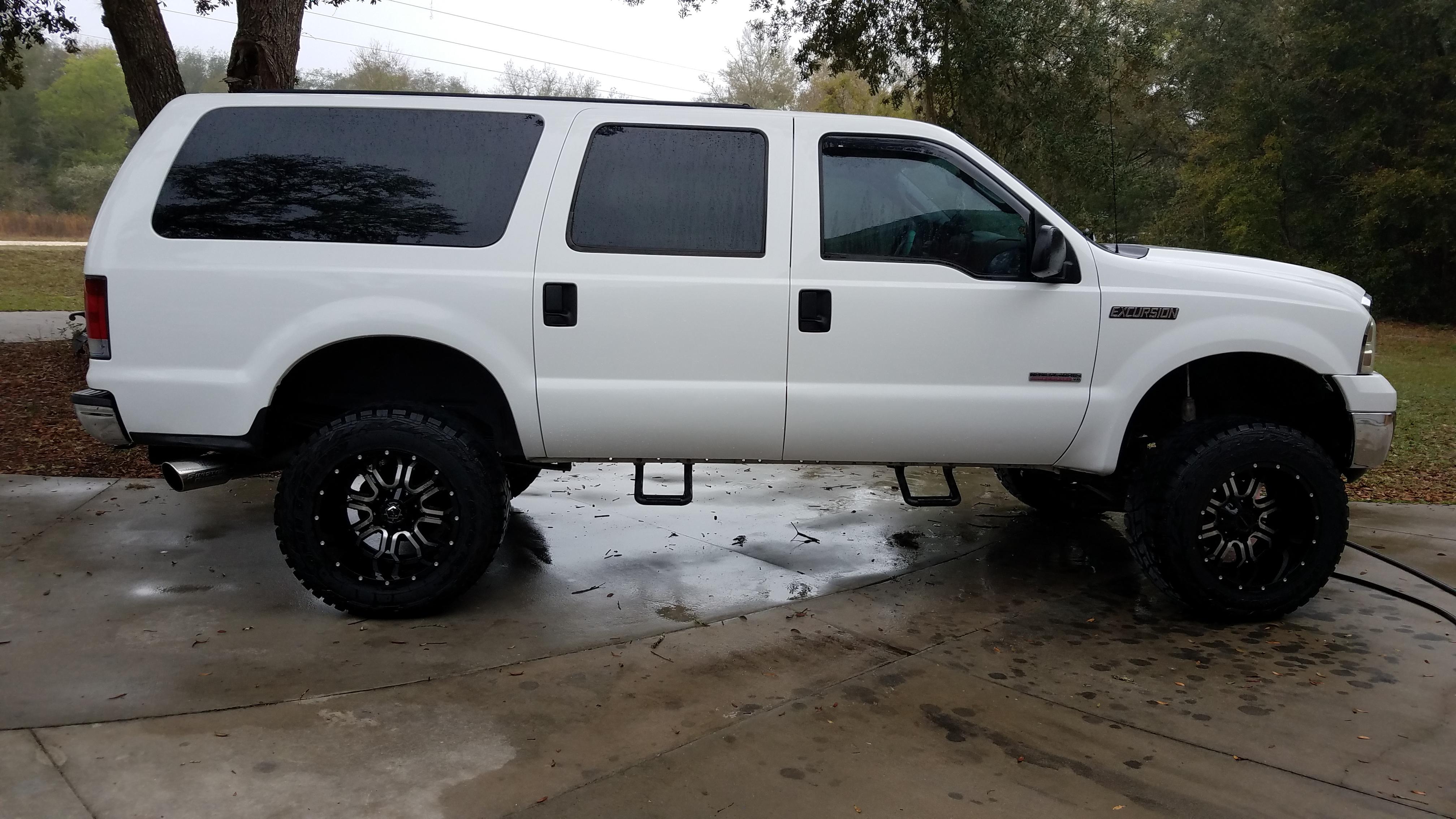

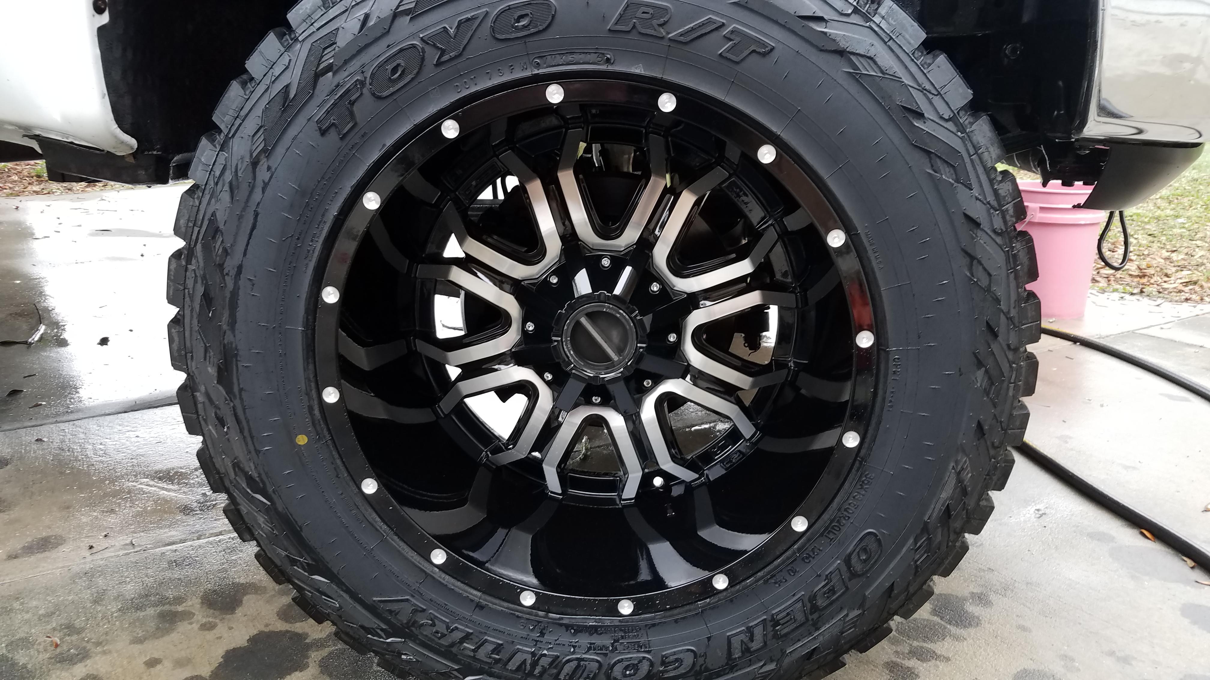

I already lifted my excursion it on superduty 4inch lift wanted stiffer front springs have 20x12 tis with -44 offset with toyo RT 35 13.50 20 had shim front bumper half inch inner fender slighty rub by door able unbolt drill new holes slide back half inch bottom of fender slighty massage in to clear no rubbing even full lock i have leaf spring front end it 05
Ebolton
Mar 22, 2017
Florida
20x12
Few pictures of it
