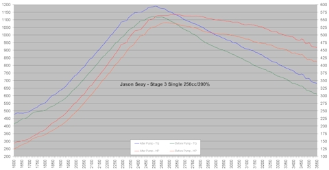

Nice numbers! Makes me curious what my injectors are gonna put down when i get them.
On a side note, when i first looked at that graph i thought something was off considering that the lines crossed at 2650 RPM. Then i realized they are scaled differently :doh:

So no gain from better pressure? Still 566 is awesome. I'd slap a s483 in front of that 38r
I updated the graph with numbers I took the same day before I installed the pump and after I installed the pump. Also, keep in mind that it was about 80º yesterday and humidity was pretty high.
Yeah, the 2:1 scaling makes everything look a little odd. Your crossover point becomes 2626 RPM, not 5252 RPM. :thumbsup:

Isn't there usually a wider RPM gap between peak TQ and peak HP? Awesome numbers anyways!
IMO yes there usually is and tq peaking early IMO puts that much more stress on the engine. Having the tq curve look more like a gasser with a curve up to a peak rather than a sharp curve up @ low RPM and then flat lining out like a more typical 7.3 curve.
That is exactly how I asked Matt to tune my engine as well.

Thats frickin awesome. Is this tuned with safety in mind or is.this tuned with performance in mind? What Im really asking is.does the relative closeness in peak hp and peak tq mean that the motor is.taking a beating down low or is that an old assumption that just doesnt apply here? Reason I.ask.is.my truck is.headed this very direction. You will most likely be tuning it too Bill as Im running your tunes now and I.want to learn/start tuning.my own junk after I get to this point.
