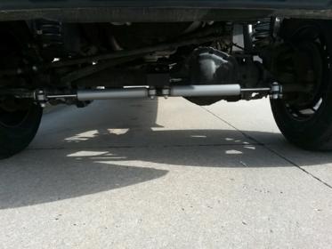

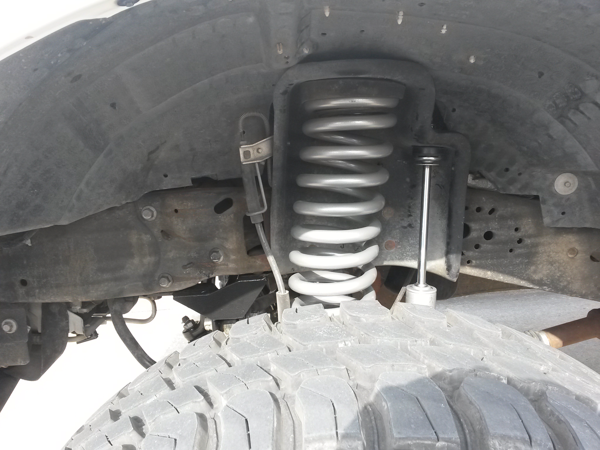

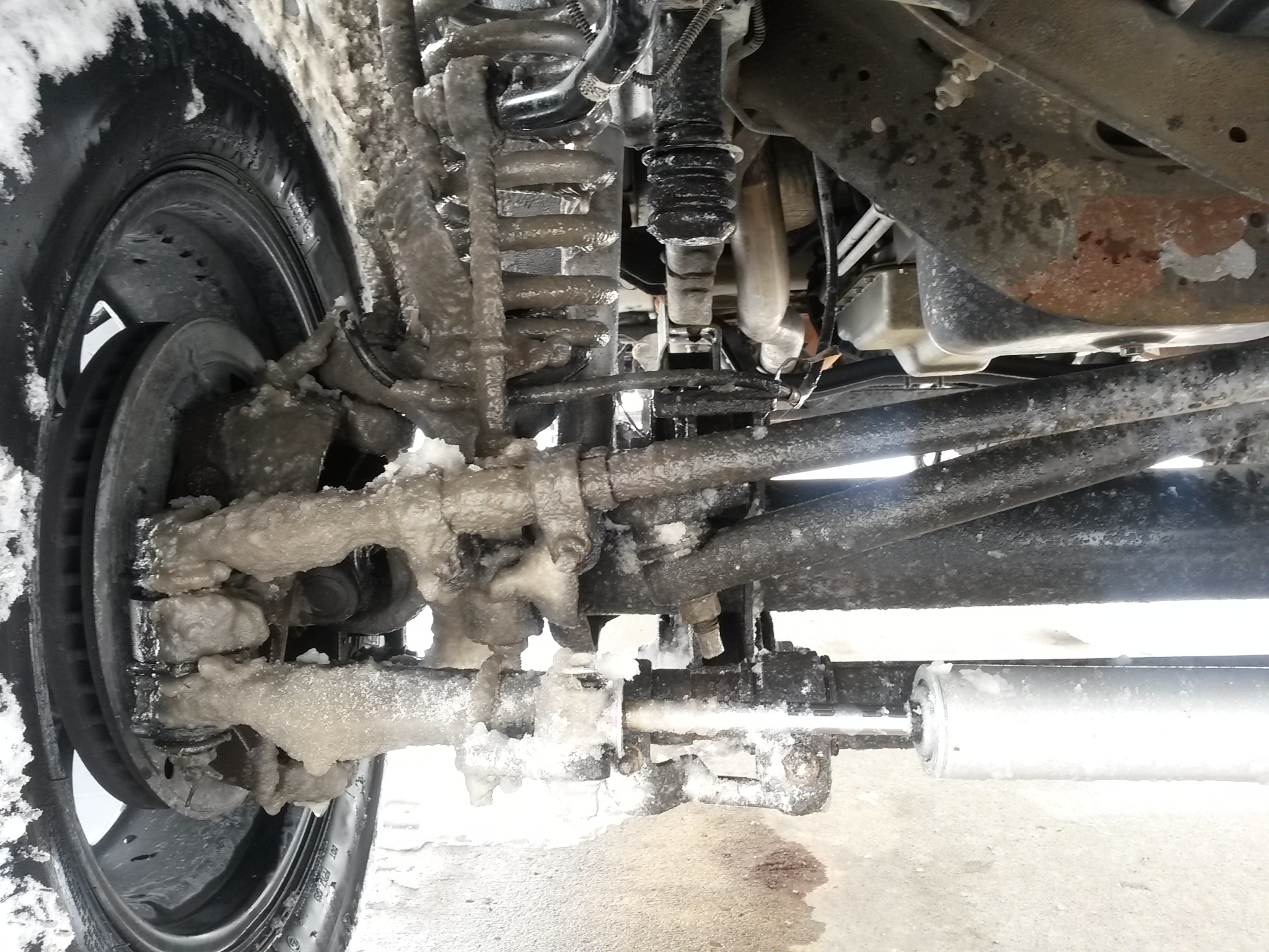

I didn't take my truck back, springs didn't come in... but here is a shot of each spring and the steering stabilizers... I'm going to get a video of me shaking the springs with very little effort..is that normal? Doesn't seem like it would be!

Is it "possible"... that the drop pitmen arm isn't needed with the 4.5 inch kit or they put the wrong one on? Just asking questions... Put a tuner on it last night, don't do that with front end problems! ALMOST messed up my wheels by a curb because the beech is all over the road from the motor torqueing. It's parked until the other stuff comes in for the front end.

The angle of your track bar compared to your drag link doesn't look right to me. Take a close up pic of your track bar drop bracket and your drop pitman arm so we can see what you have. If it is purely bump steer (only happens when you hit a bump) you most likely have a geometry problem between your track bar and drag link.

I was just looking at the rough country kit on their site, and noticed it comes with a track bar drop, but does not come with a drop pitman arm, if that is accurate, then that will definitely cause bump steer. You don't drop one without dropping the other.

You need to put stock pitman arm back on and make sure the offset washers on the track bar are to the passenger side. The track bar bracket does not drop the track bar but moves it over to keep draglink in line with the track bar. The bracket is same on 3 and 4.5 kits because it uses offset washers to move the bar over to recenter axle. With the way it is setup now you are having bump steer because the two different angles of the bars.

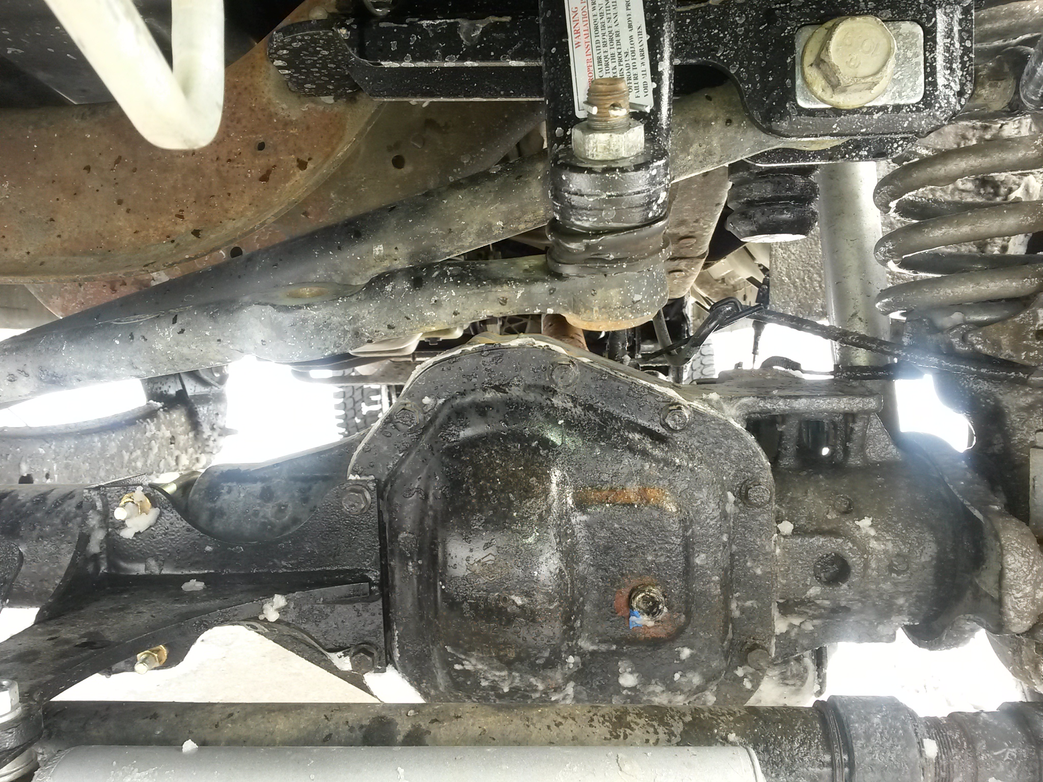

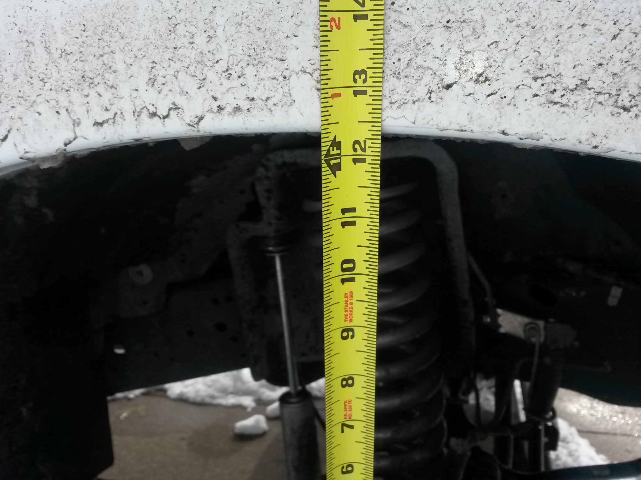

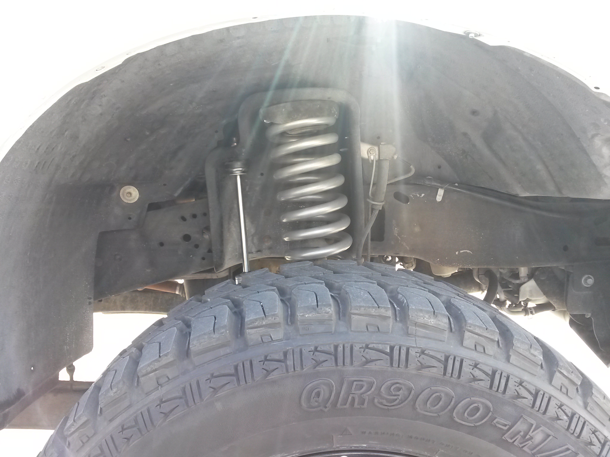

Here is some pics...anyone else have a 4.5 lift with 35's that can measure the gap from the tire to the fender?

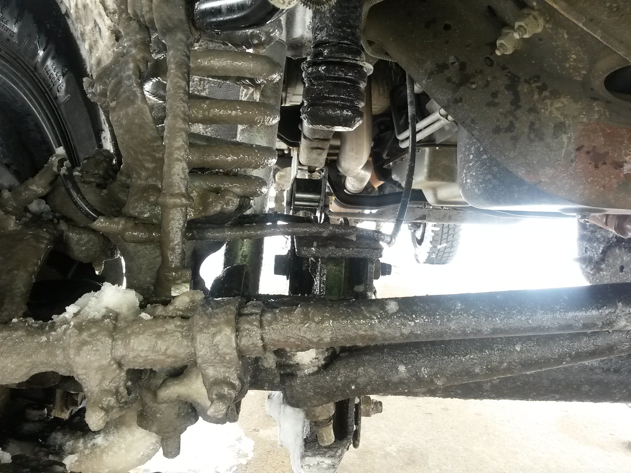

Couple more..anyone see anything weird?

NotStock
1,274
Tucson, AZ
You have a drop pitman arm but no drop track bar bracket. That was the track bar bracket they have for leveled trucks. You need the correct drop track bar bracket for the pitman arm.
junglejoe
Jan 11, 2015
399
Mo
The guy said he switched out the drop track bar bracket... so it doesn't look like it?
nvrsatisfied84
Jan 22, 2014
33
rough country does not use a drop its a offset track bar bracket on the 3 and 4.5" kit to retain the stock pitman arm. Put ur stock pitman arm back on and it will be fine ive done these kit with no issue's
junglejoe
Jan 11, 2015
399
Mo
Ill have him put the stock one back on tomorrow, was suppose to switch the springs out just to see, I'll have him do the pitman arm first. I just don't have time to or I would have done it myself. I will report back with results..
