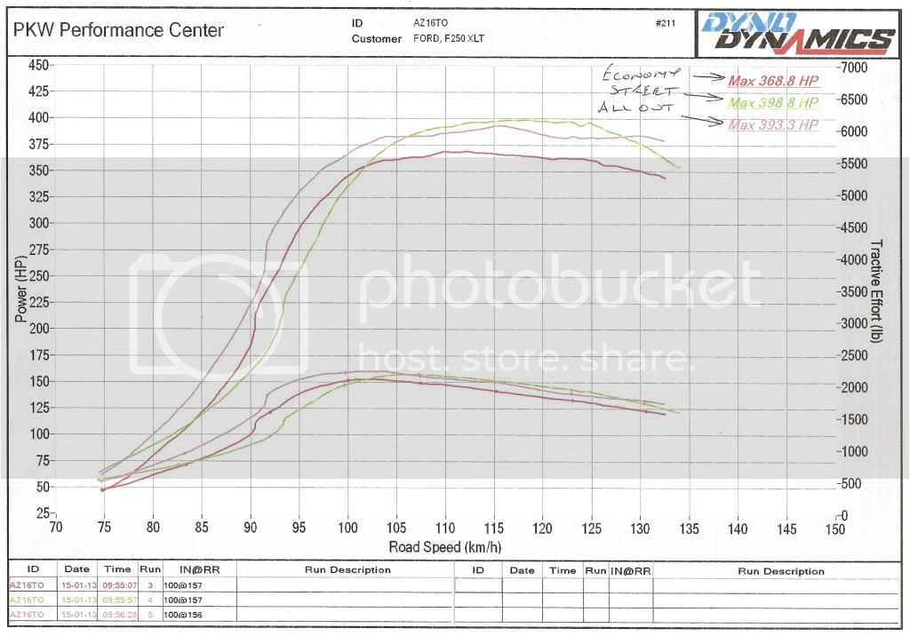

Now the reason for this witch hunt was my original dyno run where I was struggling to get 400HP. And that # was achieved on my Economy tune. The other All Out and Street tunes were worse.
Spoke to Matt and the questions were raised regarding Boost - Fuel and HPOP.
Now when I did the dyno I didnt have AE running so there wasnt really much I could tell him. Here is another run I did this morning. With that and the other runs I have attached, do you think those aspects have been answered.
I dont want to book the dyno if Im not ready.
Here is the original dyno sheet to jog your memories. And this mornings run is attached

That looks a lot better... ICP is only slightly low but not leaving 100hp on the table low. It should pull pretty hard on that run.

Ok then onto the dyno I go. Before I book it what am I looking for regarding the dyno. I have heard about loading up the dyno. How much load will I need. And am I still doing the runs in Third with TC locked ???

Have you run it on the street or at the track? You need to get a baseline on the street to see where boost is and such. That way when it makes 10lbs less boost on the dyno you'll know it wasn't loaded properly.

All that AE data is running on the street, but I understand what you are saying Matt.
