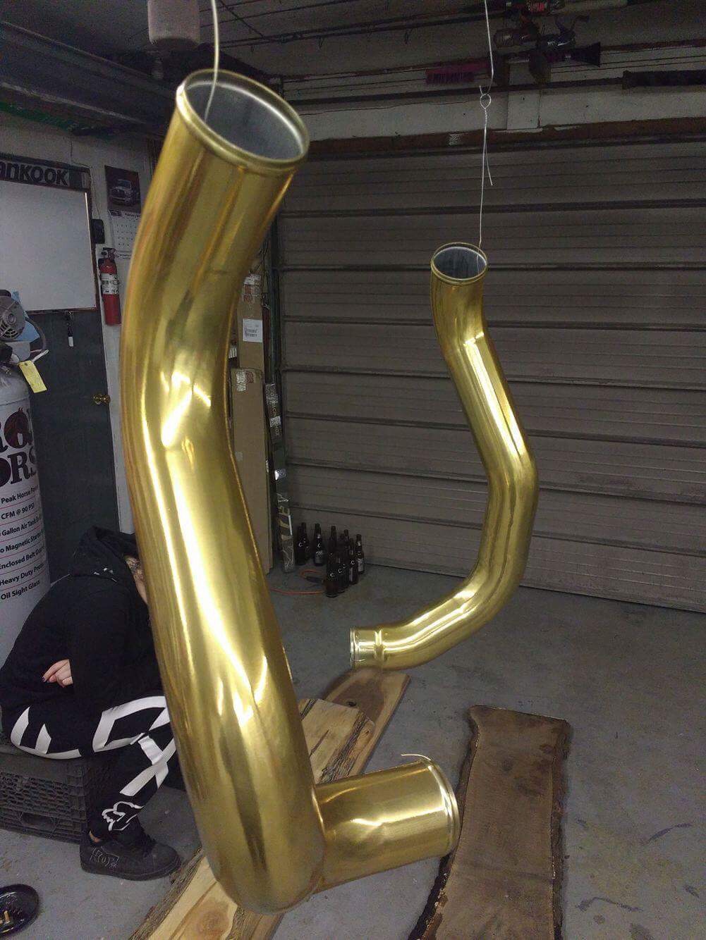

If those are the sinister made cac tubes check the cold side to intake horn placement. I had a set that were so far off it had to be cut, rotate, couple back together.
Haha I thought so [emoji23][emoji1362] but they're from a local shop in Indiana so hopefully they're good. They seem to be really good quality. Time will tell once everything gets thrown on.

Starting to get everything back from powder coat. Warren didn't have anymore 150% nozzles I guess so they told me my injectors will be shipping out this week sometime.
