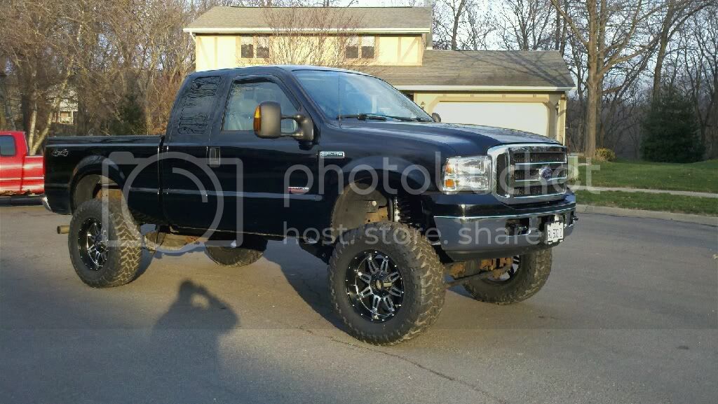

This is the post I'm talking about. 305/55 clear no problem on stock height no leveling kit needed.
