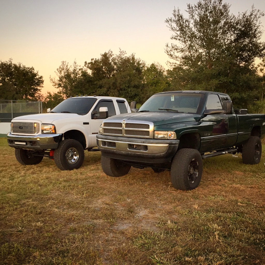

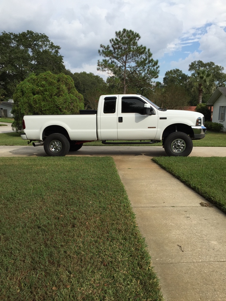

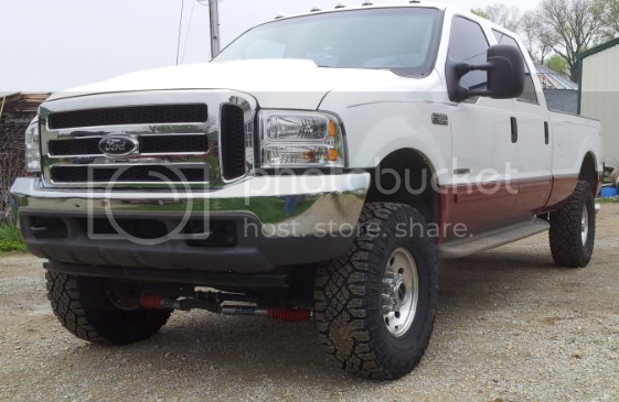

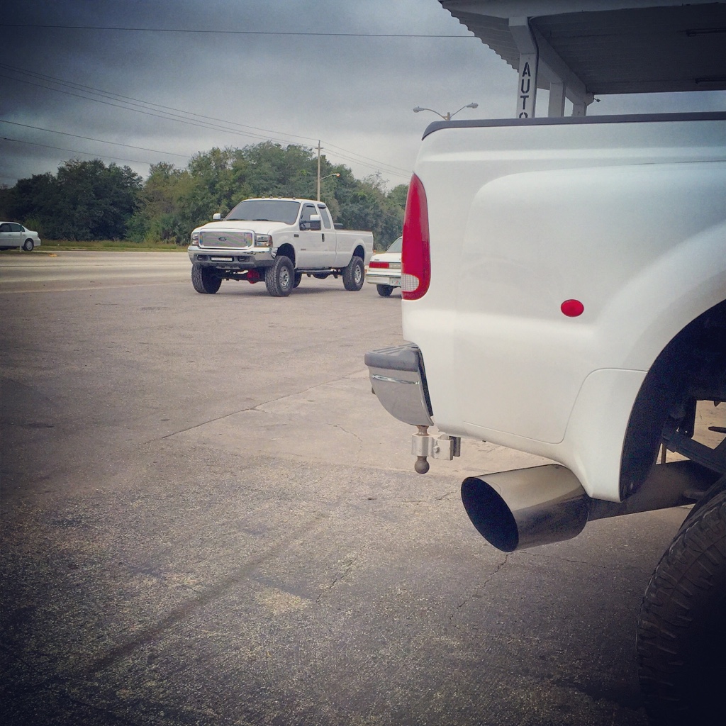

Looking for pics of 35 inch a/t tires on stock 16's. Not sure if I want to put a/ts or m/t on the truck since it is 90% hwy driving just from an aesthetic point of view.
