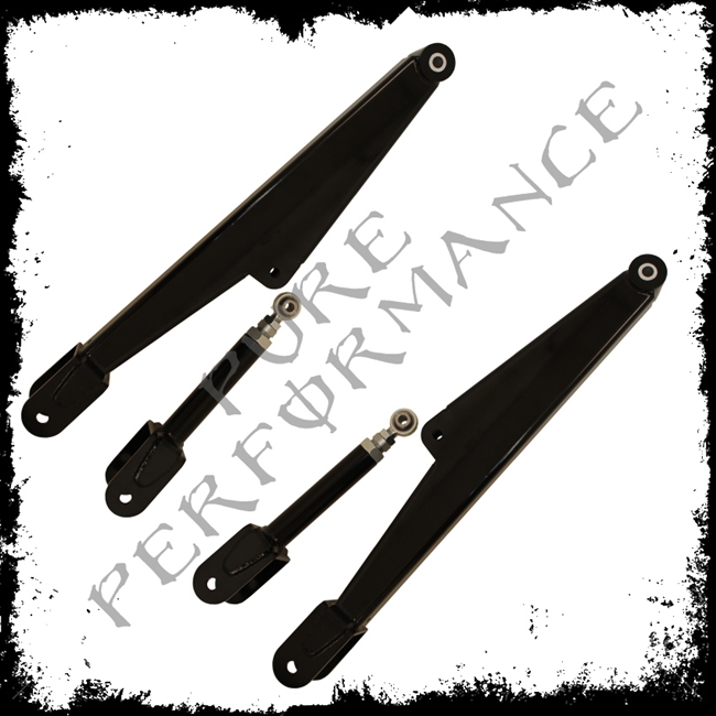

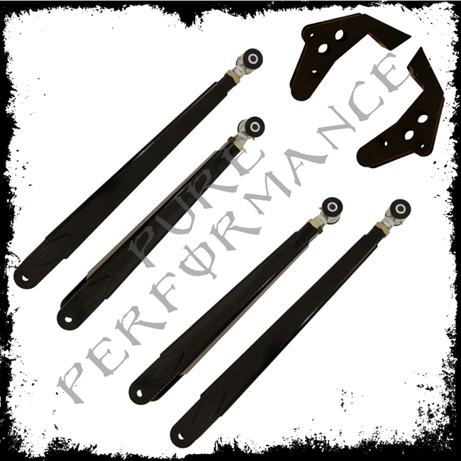

Pictures of the new quick adjustable arms..no more having to remove a link to adjust Castor.
