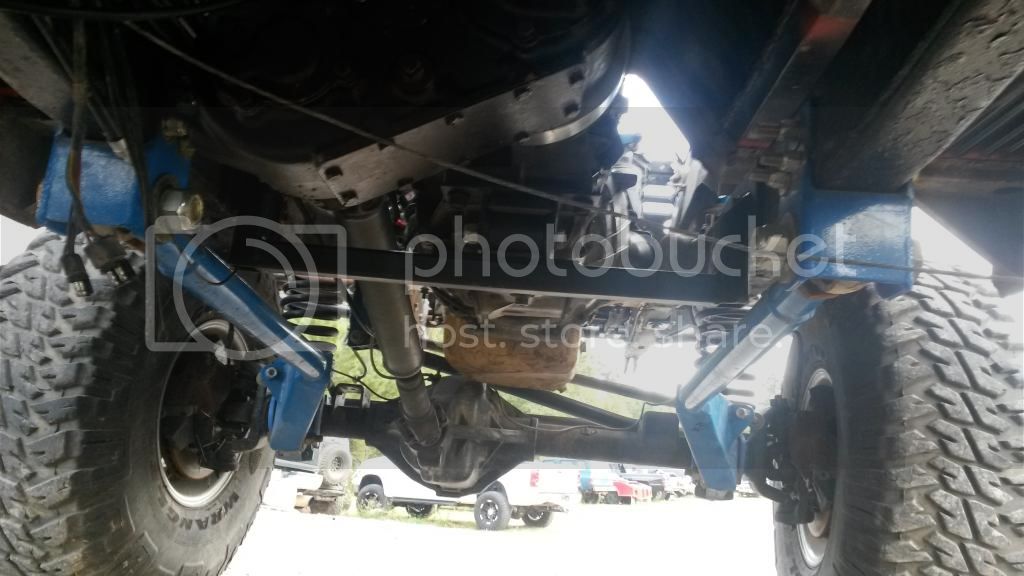

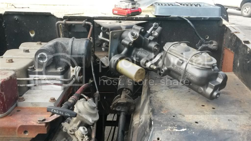

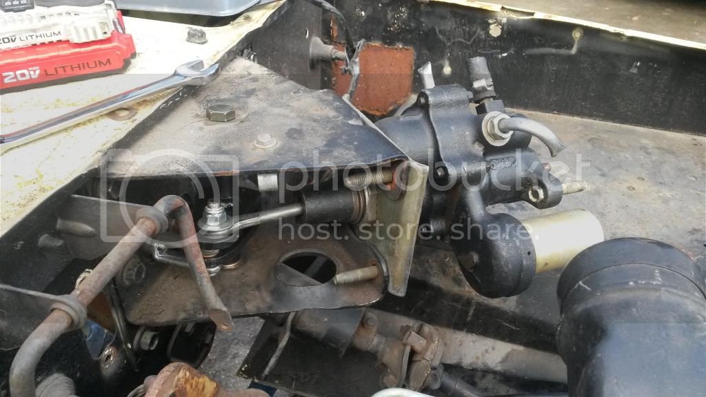

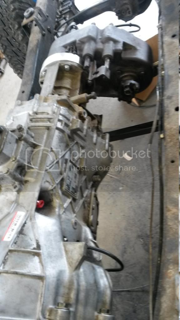

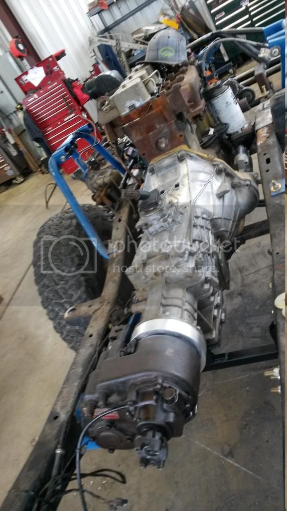

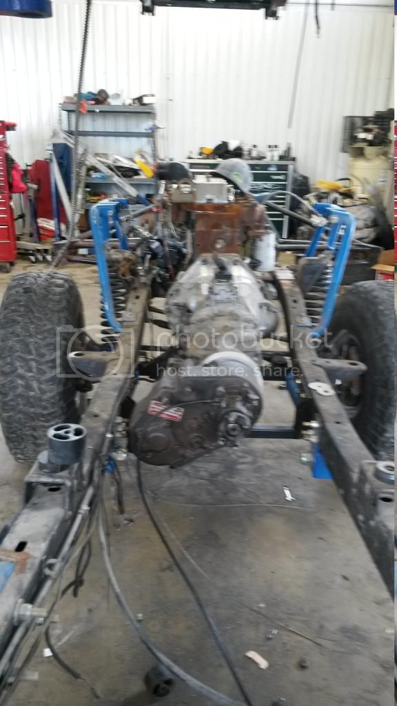

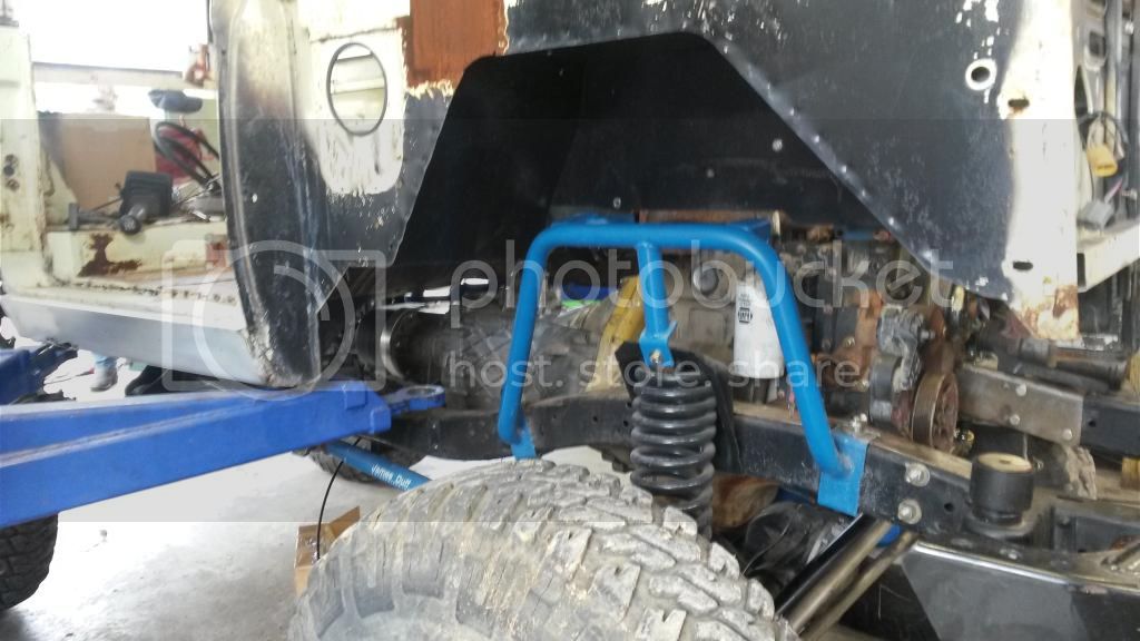

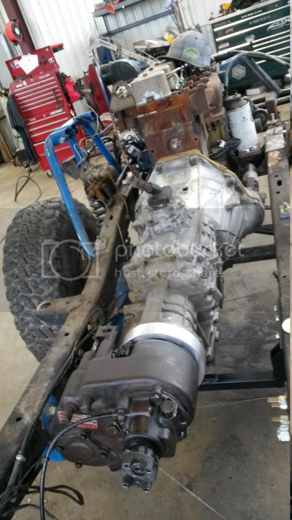

Well finally got everything together....
Had a little issue lining the trans up and had to drill a couple more holes.
Driveshaft lengths are going to be perfect. 31.5" for the rear and 31.75" for the front. ;D

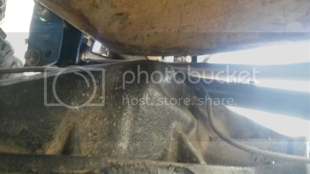

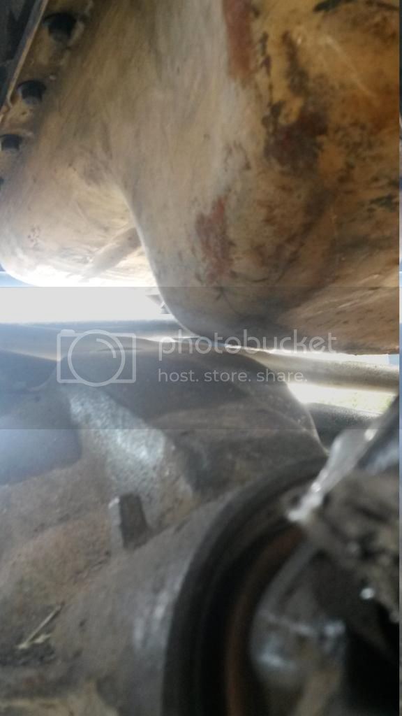

I might have some clearance issues with the pumpkin and oil pan so may have to mod the oil pan a bit.
Sorry this one is kinda blurry

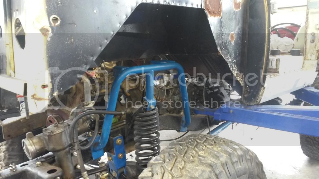

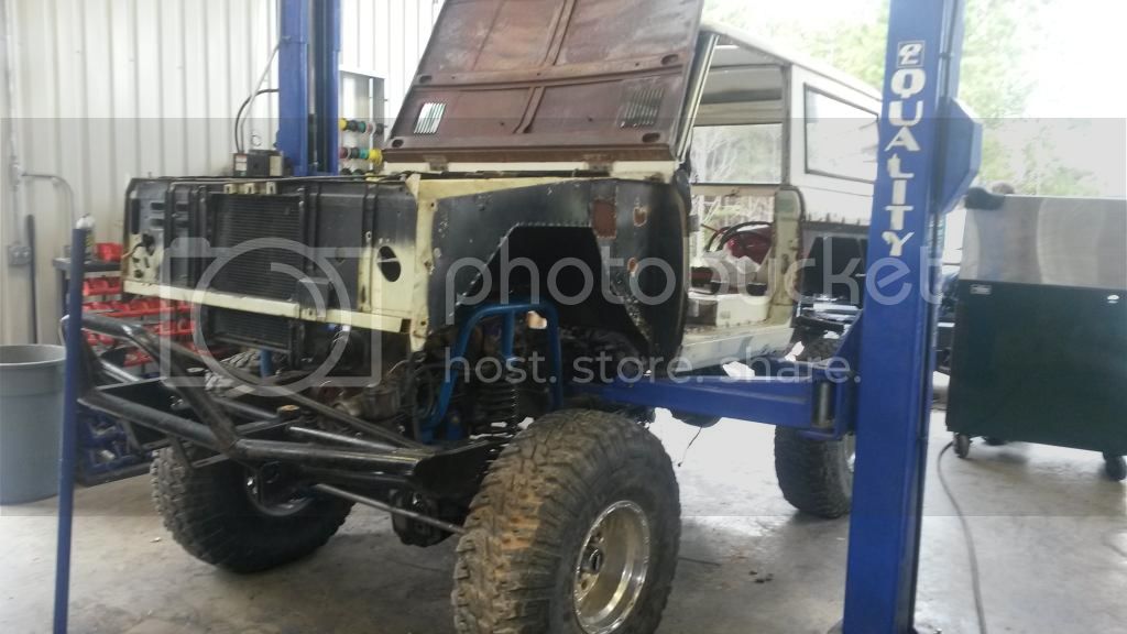

Coming back down with the body...

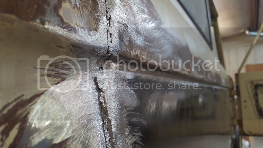

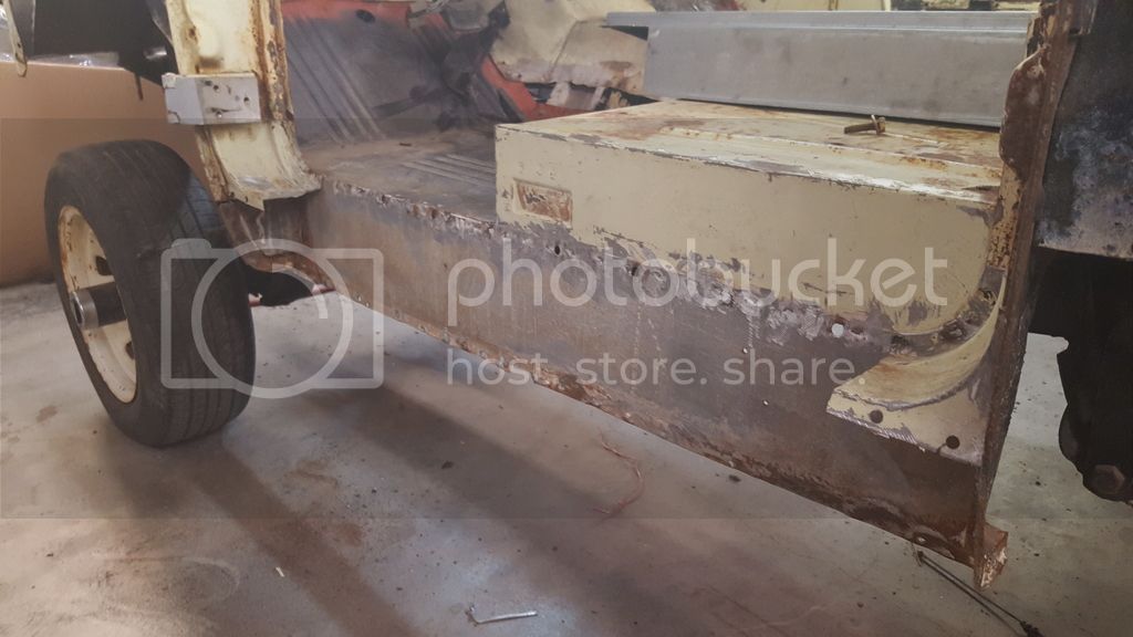

Looking sweet I have a 66 bronco that I kept pondering this idea I finally built a 418 small block ford for it..... keep the pics coming I love early broncos have you ever seen the cut rockers I cut mine and am so happy I did.. no more bashing them in

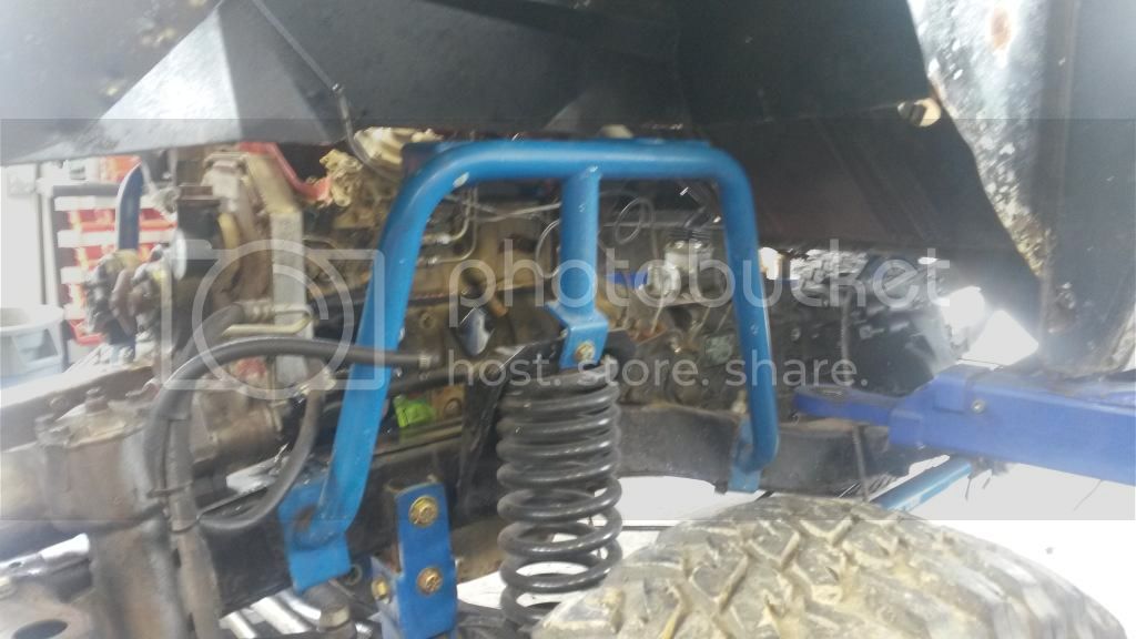

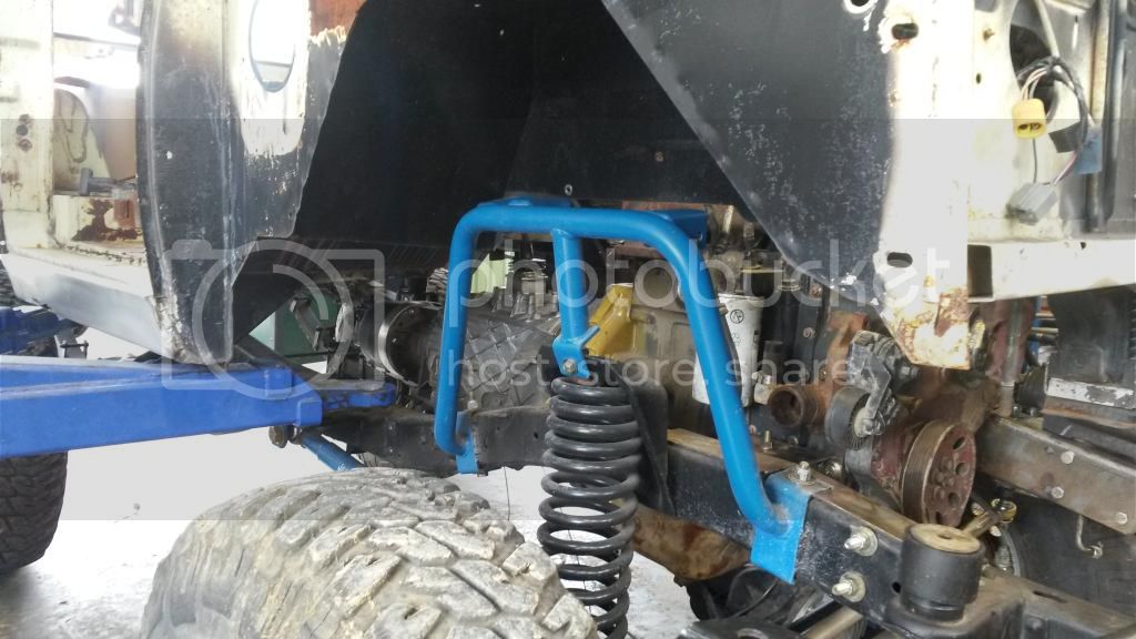

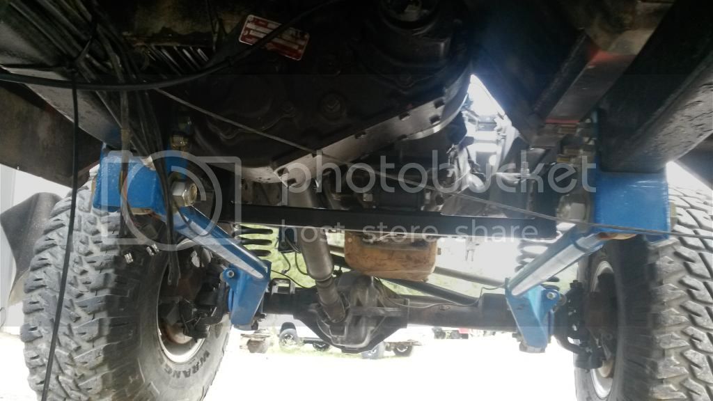

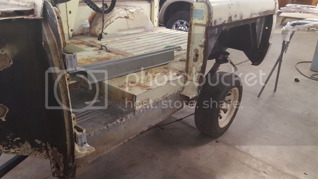

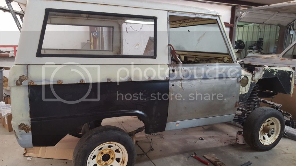

Got my rear bumper
Picked up a cage

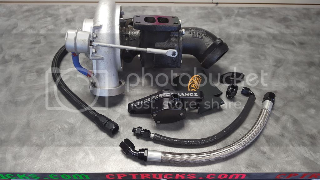

Doing some mock up for my turbo found out it won't fit with the factory manifold....so might as well upgrade Steed Speed it is!!!

You going to pull the head and have it reworked and have the manifold mating surface on the head machined flat?? It would be a shame to have that pretty new manifold bolted to that head. It looks a little uneven in the pics at least. Lol.

What model turbo is that?? It looks like an he351 or hy35 with that exhaust elbow on it. I think I'll be pulling the trigger on a super hx30 or a he221 here in the next month.
