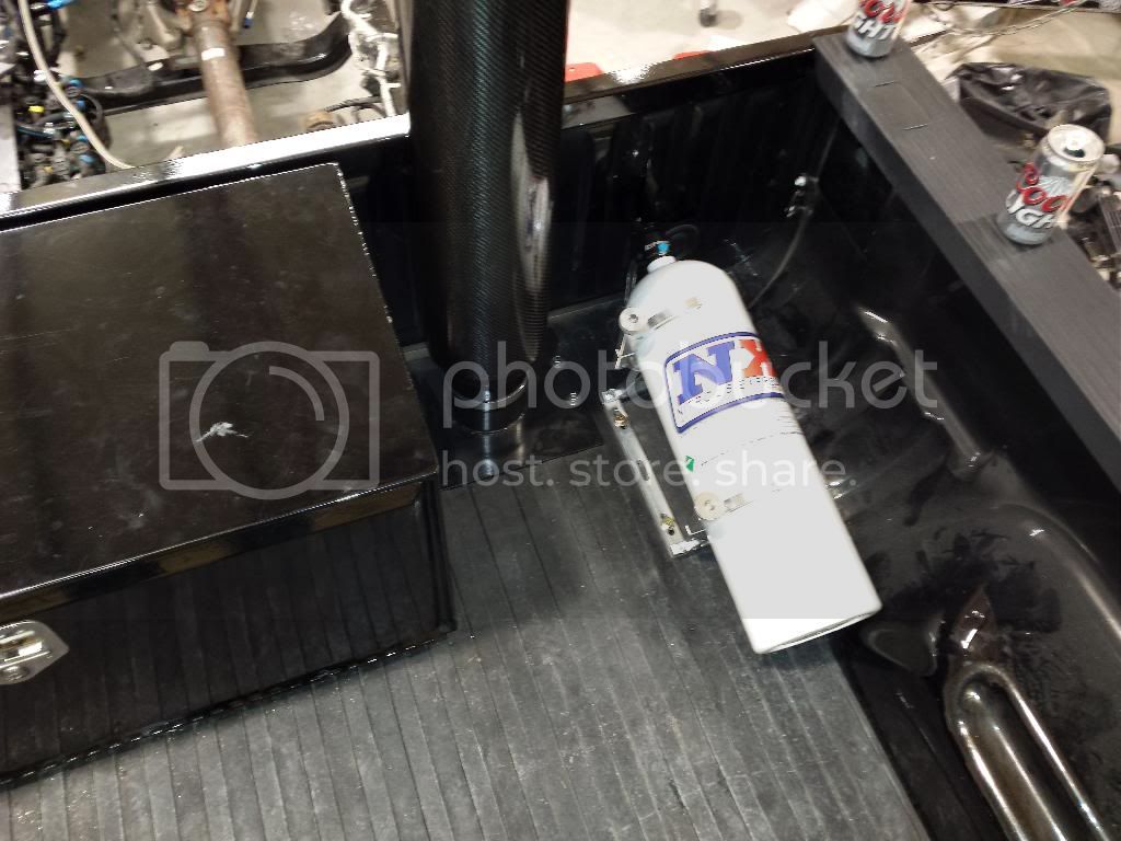

Long hours and a man with a serious amount of drive are the 2 main reasons it's coming together as quickly as it is. Things are moving much faster than I had expected. Morgan finished the fuel system this around noon today and started on coolant lines for the chargers/gates. I finished the battery box this morning with kalebs help. Batteries are relocated to the bed in a nice small light weight toolbox. Morgan should be running wire in the morning if not tonight. Daniel gave Morgan some much appreciated help with the many tasks he had. Kalebs starting to get a twinkle in his eye knowing he'll get to hear it running in the near future.

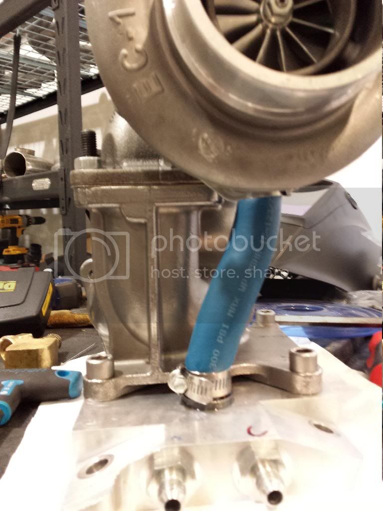

Just have one hiccup with the high pressure oil drain. Will need to make a hard drain tomorrow. Offset is too hard for hose, and too short to make for hose ends..for what I have on hand at least.

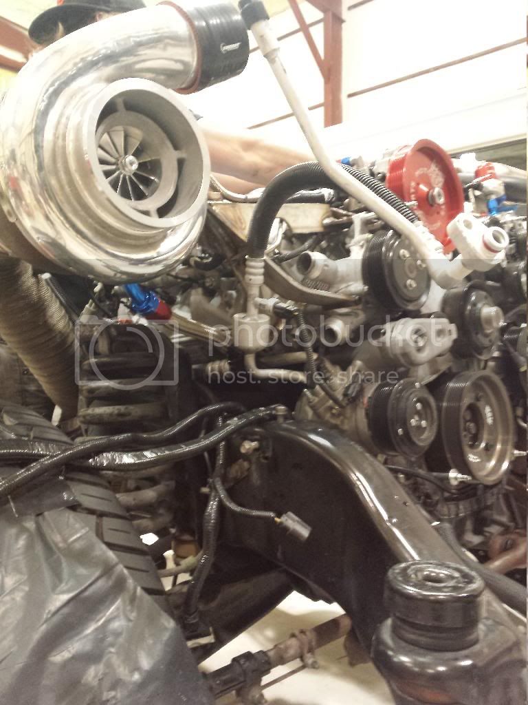

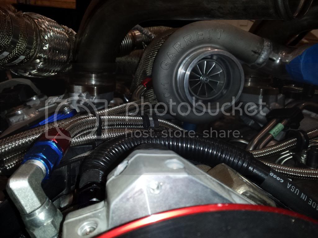

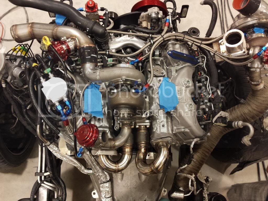

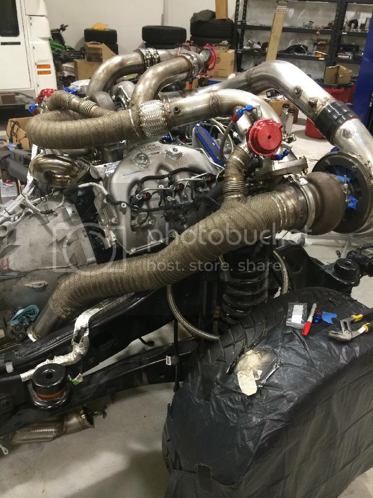

- Batteries are mounted, wires are ran, but not set, waiting on loom
- GPCM and high current fuse box is tucked behind the fender like the IDM in a 7.3, it's pretty cool
- Gates are set, all exhaust piping finalized.
- Factory exhaust sensors are in
- Oil drains are in
- AC lines are in
- Dipsticks are secured and fit nicely.
- Every low pressure fuel fitting has been tightened and double checked
- Turbine heat shields are in
- Power steering relocated
- Additional fuel cooler mounted and coolant lines tied in parallel
Cab is down, here are some shots from the other day
