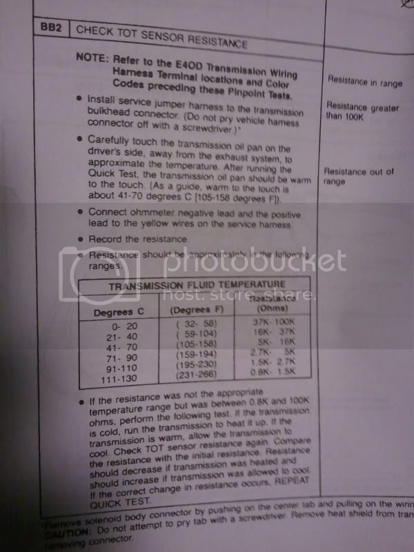

You wouldn't happen to know what pins the two yellow wires are on the service harness would you? I'm guessing 7 and maybe 8.

The problem was in pin#8 signal return wire... Pin# 91 on the PCM harness. The wire was just a little fudged up but enough to put it out whack.
Thanks for the help guys. Dave that saved me some work! Thanks!! :redspotdance:
