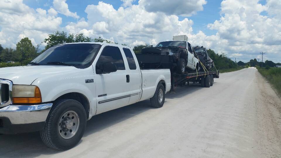

Mine died at 180k, my buddy told me of a parts truck identical to mine that I could pick up for $1000 didn't run but the trans was supposed to be good, went to look at it and it had 380k on it and the guy was the second owner told us that as far as he knew it had never been out, when I pulled it it looked original, I was pretty sketched out about it but for the price I couldn't pass it up at the time, threw it in my truck with a new filter and fresh fluid and I've put 30k on it so far with out a problem, and I am not easy on this truck at all, it pulls heavy quite often (about 25k gross in the pic) does burouts and just get beat on lol I am waiting for it to die any day but I've been impressed with it so far
