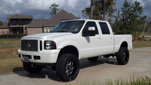

They hang pretty good:
MINK
5,714
London,OH
What offset are they? I dont think you have a wide enough wheel to pull off the 37s with a 8" lift. I like your look now.

Gare I had those on my truck with 37s. Was running a fab tech 6" 4-link. I trimmed MAYBE 2 inches of the bottom corner of the bumper.

Also it looked great IMO with those 37s tucked under there, but your truck is a work of art right now man.
