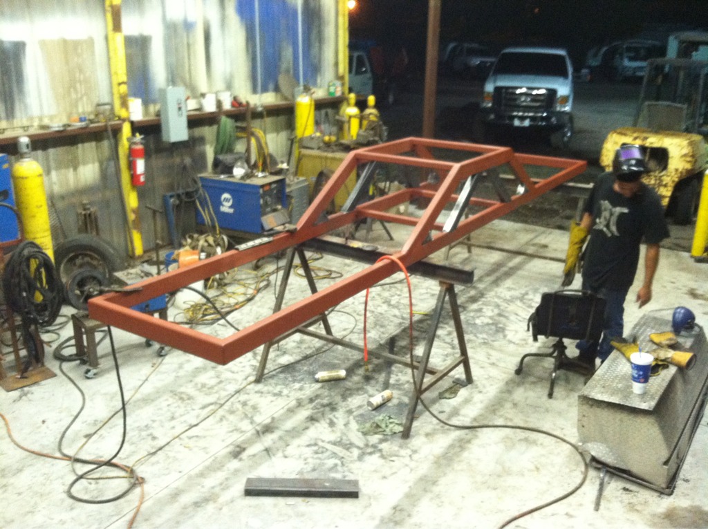

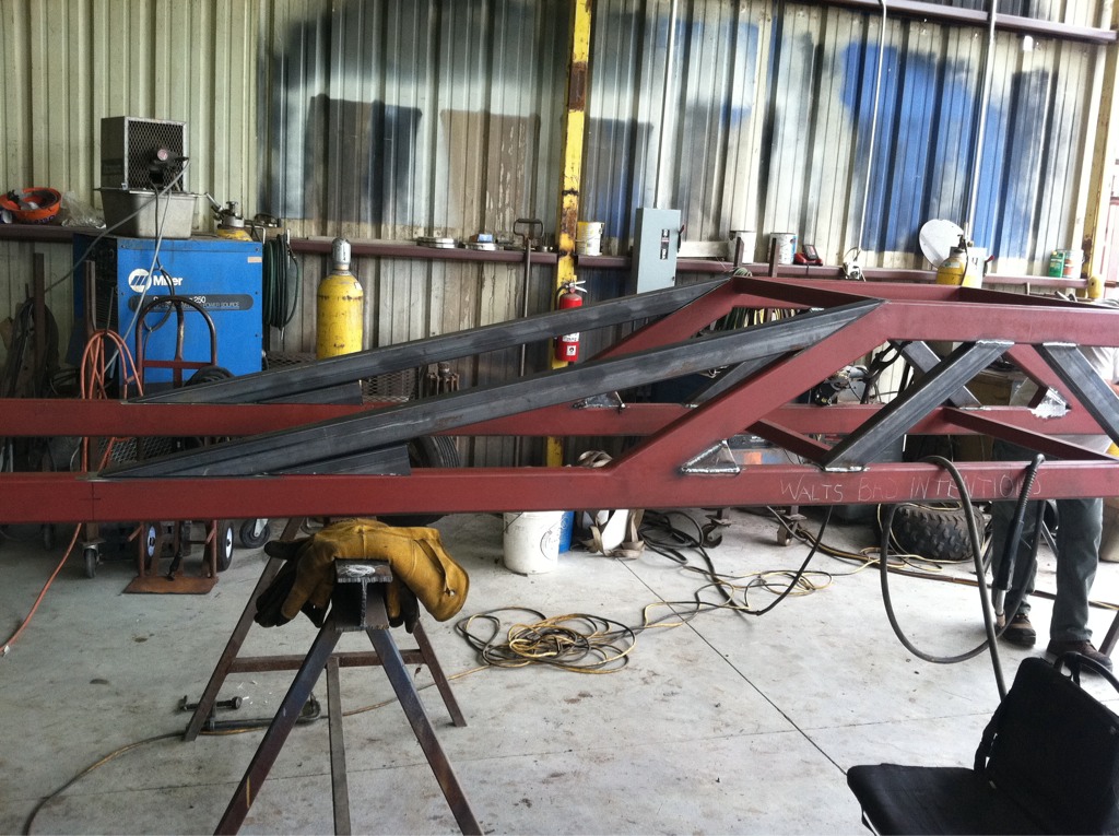

Back on it again!
This isn't being built for show like most of the 4 linked buggys out there. We are gonna find the places it won't go. And it will see a little air time. We are running 18" FOA 2.5 resi coilovers.

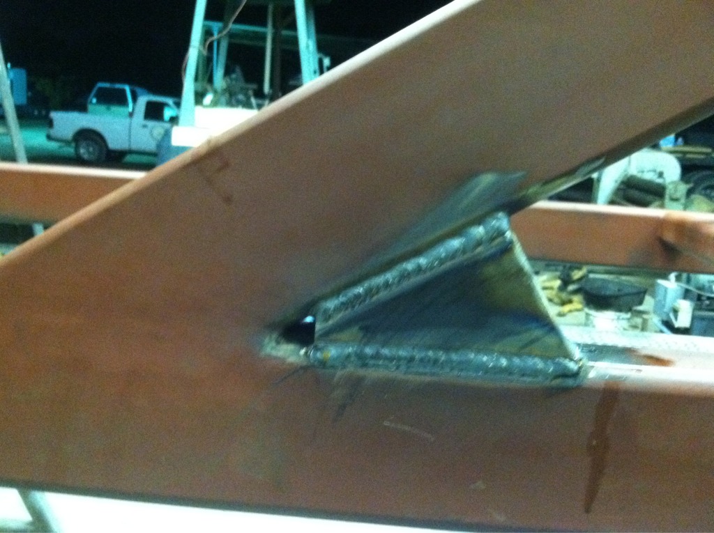

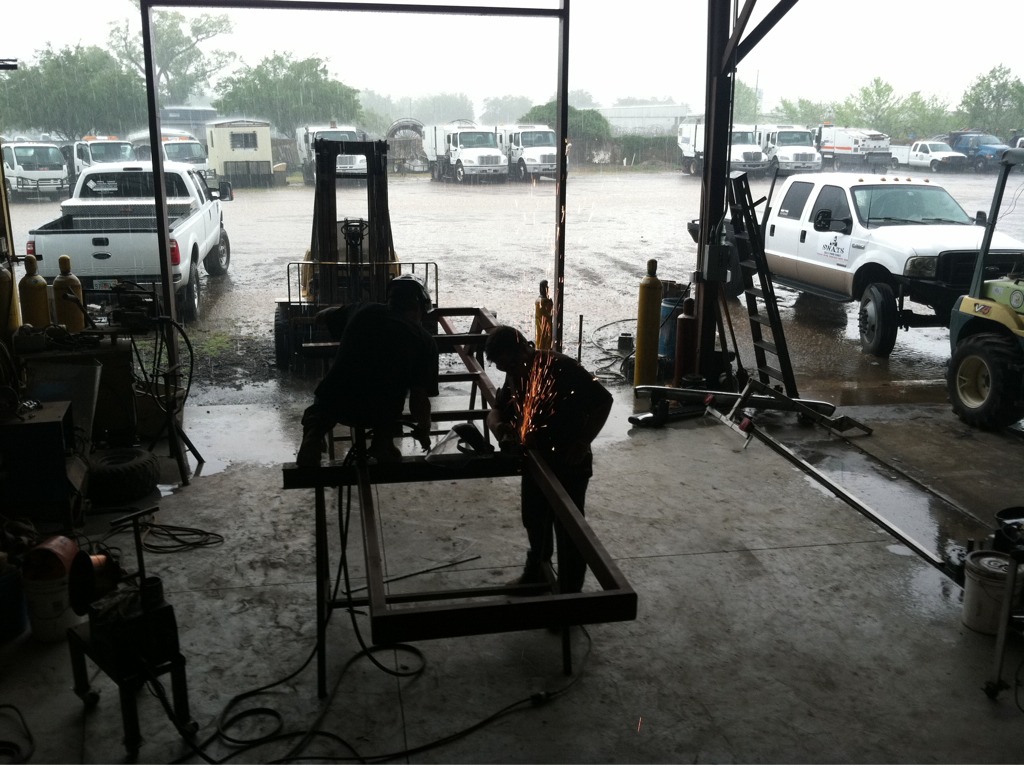

ImageUploadedByTapatalk1334867864.295396.jpgYea pouring! We are blending all the welds from last night. Just two of us building the buggy me on the right
Dtm030
169
FL
What part of Orlando are you in? I'm on the east side (near downtown) and we haven't had any rain.

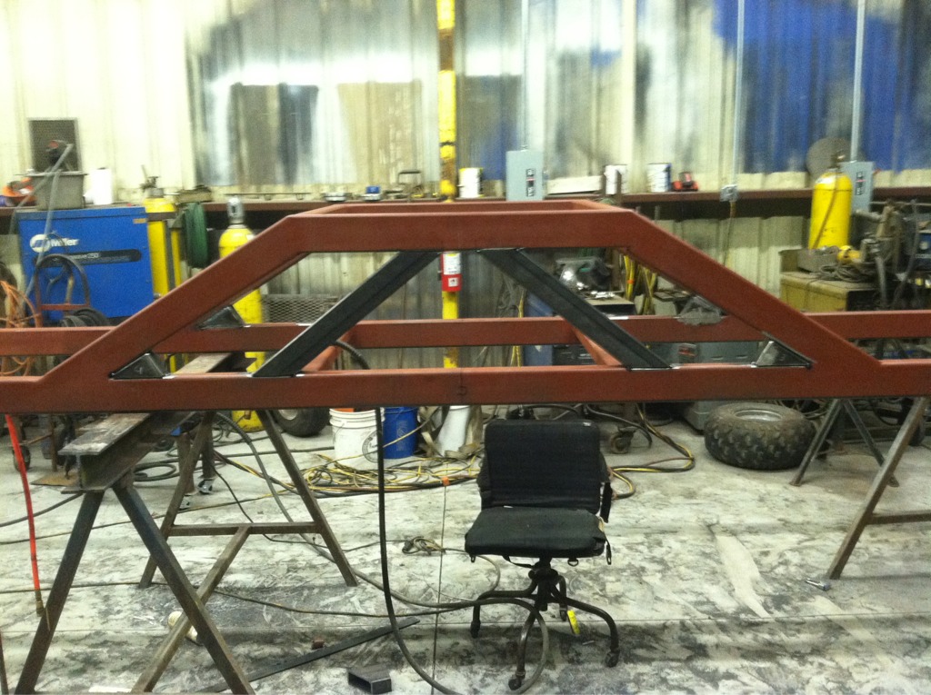

Looks awsome man. Should be a blast in the mud. Those 2 short supports you put in in between the cradle and main frame, if you flip them the other way you will create 3 triangles increasing strength.
/\/\ like this lol. Just something I noticed keep up the photos buddy.

Thats what I am talking about!!!
There should not be any lack of strength in that chassis!

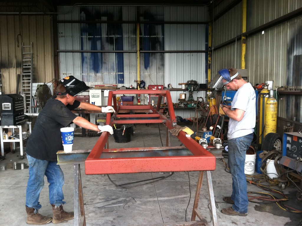

ImageUploadedByTapatalk1335057955.176568.jpgGot a buddy with us today 2 migs while I am tiging it! Frame should be done tonight
