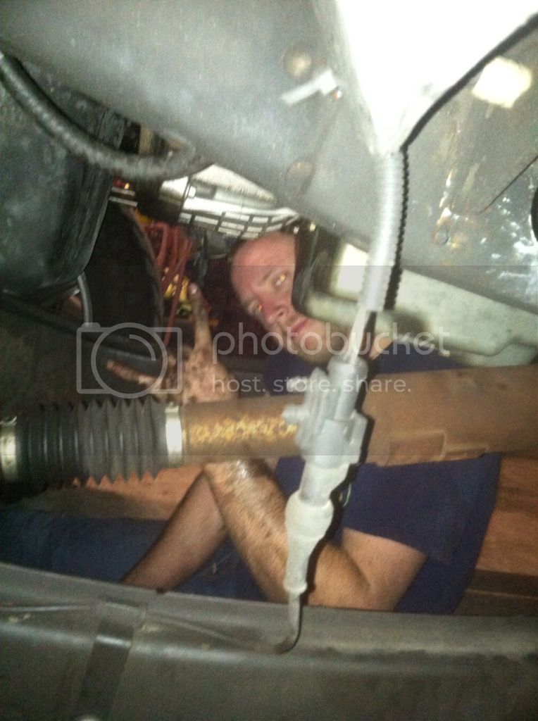

whoa, in this picture, is this how you mounted your drain tube? The drain needs to be facing straight down, no wonder the seals blew out!
Pizza pig
In the Brig (Banned)
Jun 4, 2011
3,715
MD
Looks like every one of these happenings had an unsufficient drain line. Shawn how was yours routed? You guys arent the first to have an mpd kit with this drain line setup and have problems
