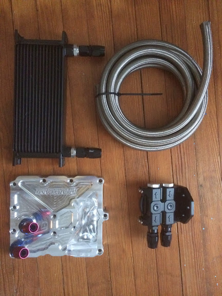

I am worrying a little bit about the size of the cooler I got, but here is a photo of everything but the thermostat which I will be ordering this week hopefully.

What kind of filter head is that? Should the filter heads have a bypass or anything in them?
