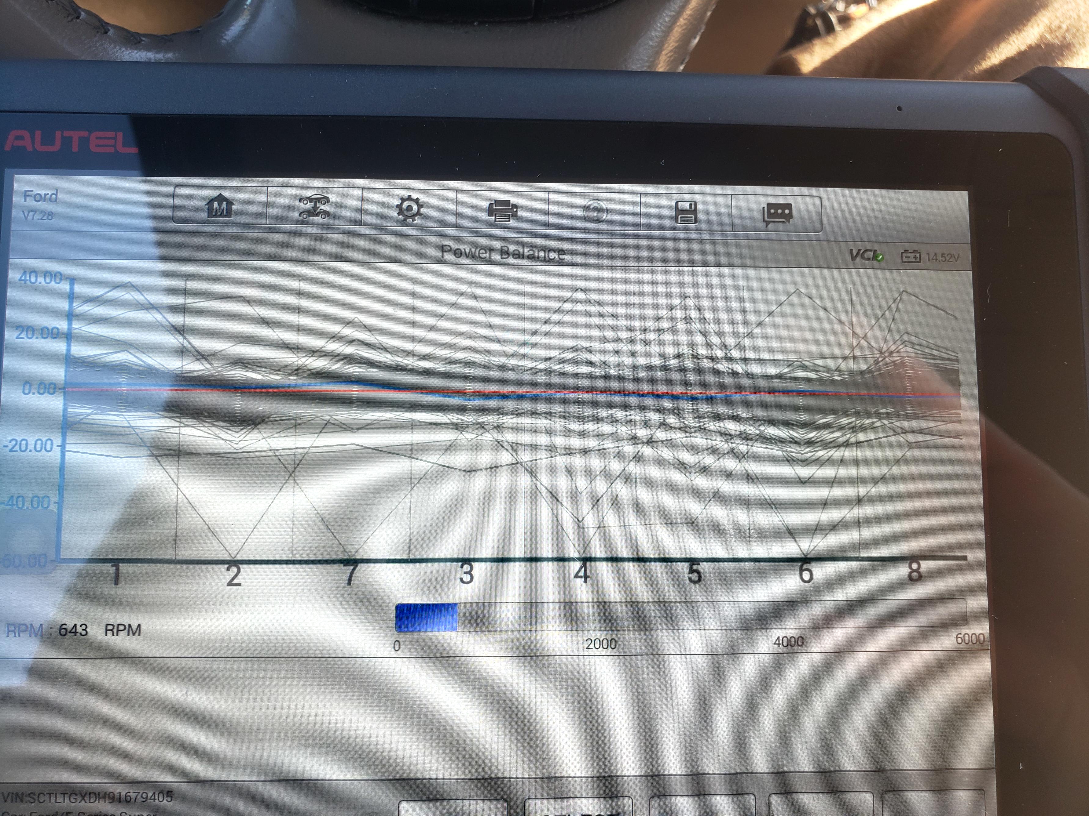

Even though its shaking with the converter unlocked? If I could figure out how to upload it id include a pic of the power balance graph.

20200128_145624.jpg power balance under load with the issue occurring. Compensation was off

It’s not a spoolvalve issue, it’s a weak solenoid. When the solenoid is heat soaked it is weaker.
View attachment 51609 power balance under load with the issue occurring. Compensation was off
I can’t read it.
