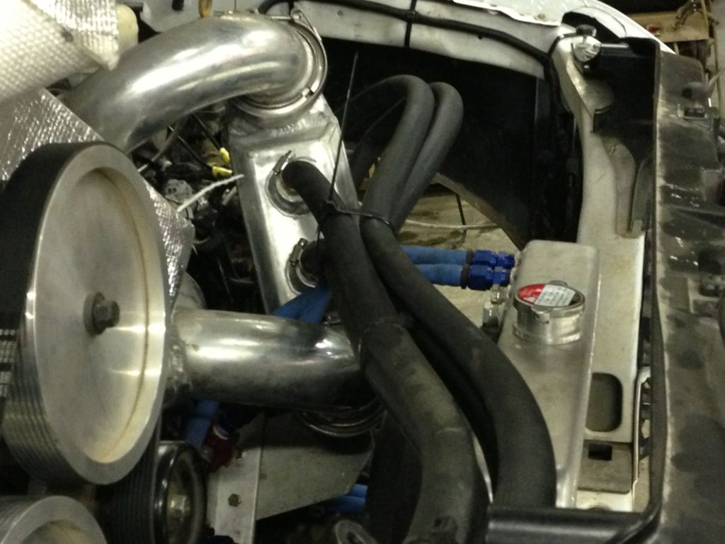

This thing truly looks like a big octopus with all the lines going every where.
Added two bungs to the other side of the after cooler. I wasn't getting the IAT that I wanted on the last pull. Now it has cross flow with two supplies and two returns. Unfortunately the second pump didn't show up Friday so I will be running one water pump. It will still be better than it was.

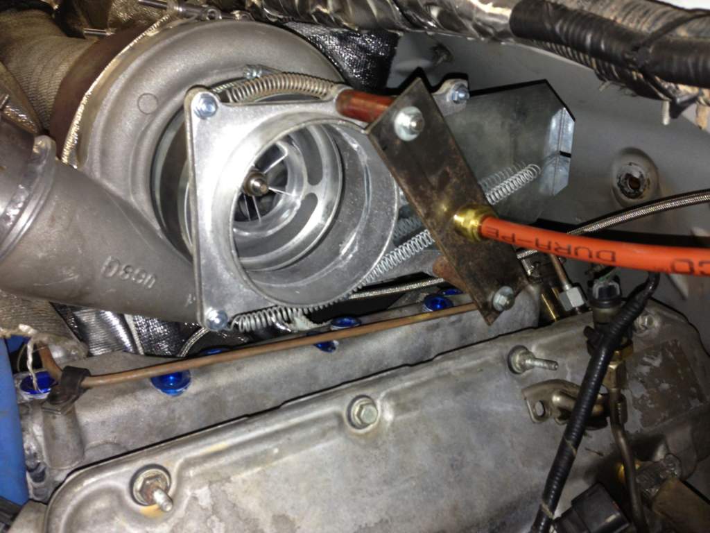

Air kill shut off installed.

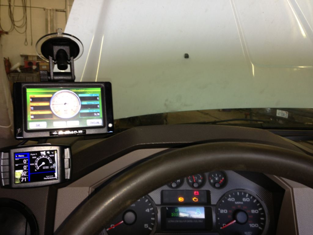

Plenty of monitoring capability. Not shown is the huge 2 5/8" mechanical oil pressure gauge to watch oil pressure on the other side of the steering wheel.
