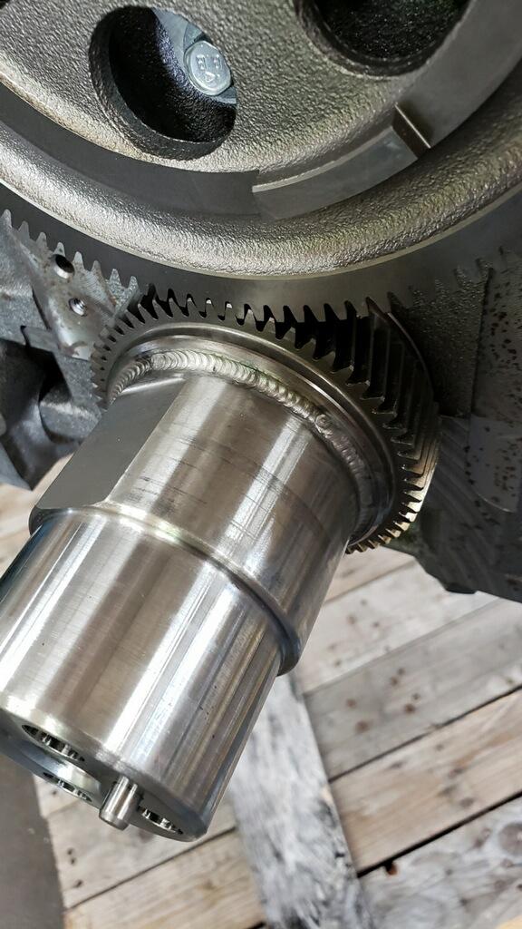

New 2018 6.7 Long Block is in the 17'. Had the crank gear TIG welded and did the H&S Motorsports oil pressure regulator. Just waiting on the fuel system to come back from exergy. The injectors checked out fine and the cp4/10mm pump test we should know by tomorrow. The S480 got rebuilt by FI and a Fleece Cheetah VGT is on the way. I still personally think my 10mm needs rebuilt or replaced so we will see what exergy says....
Hopefully the truck is back together sometime in the next 2 weeks and running. Then off to a new home it goes. I'm jealous of the new owner since the truck will have an even more proper/reliable setup on it than when I owned it, oh well!

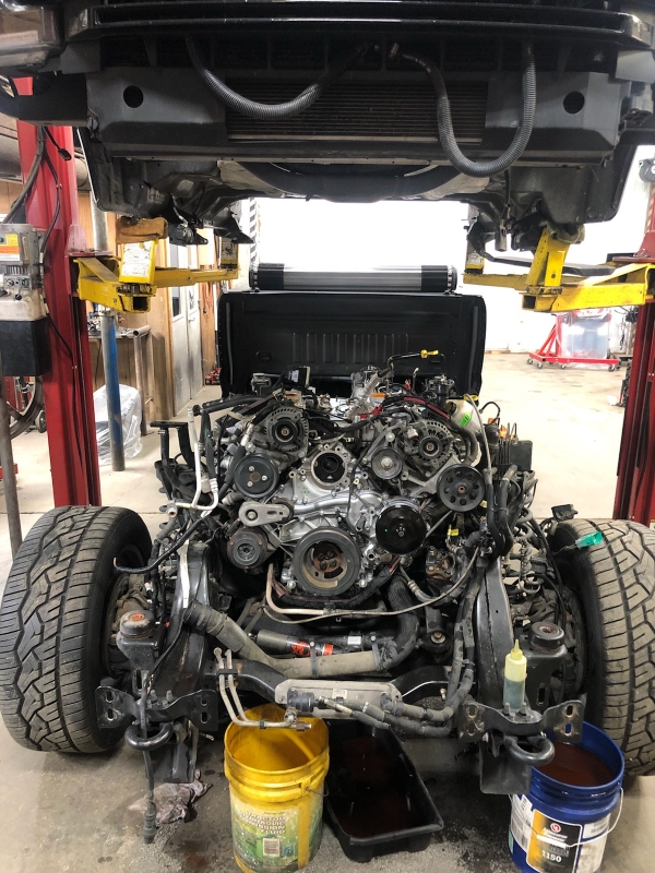

Well here's my old engine that seized. Took the pan off. Bearing material & Metal everywhere. Multiple rod and main bearings are toast. It definitely had a lack of lubrication which signifies loss of oil pressure. Pretty sure my oil pump quit.
