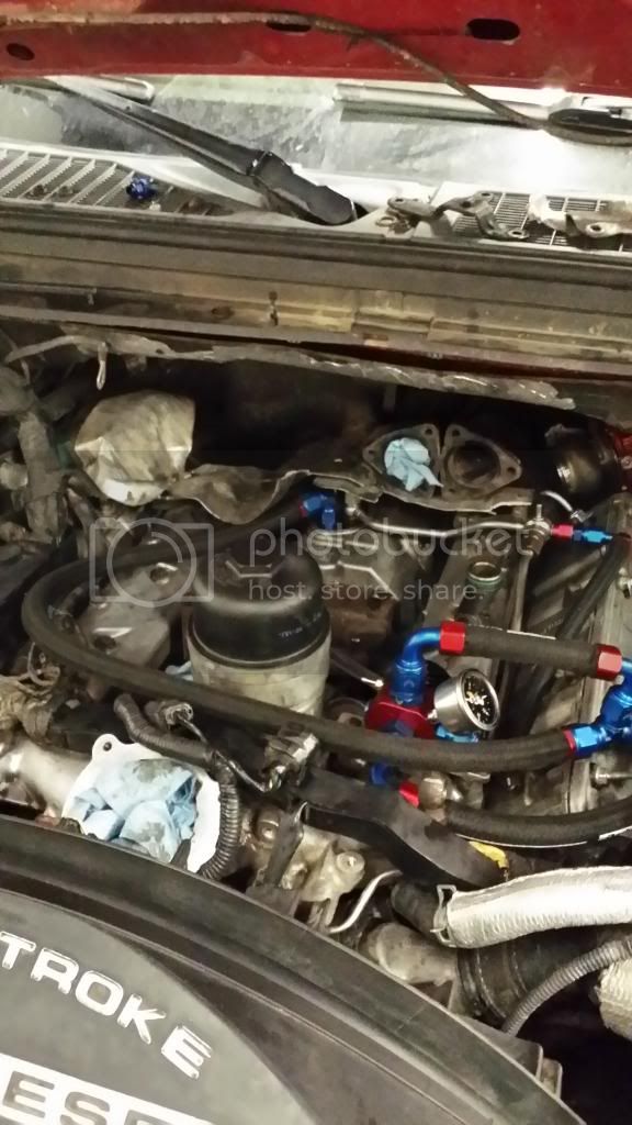

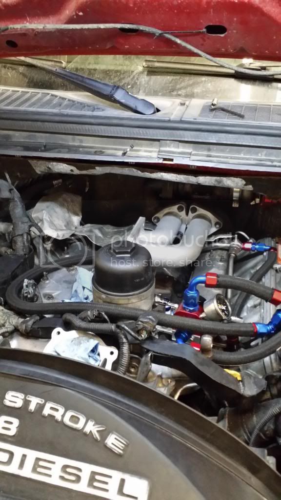

Now time for Pic's; removed the stock turbo's and plumed in my new fuel system before starting on mounting the turbo and such. Credit goes to MPD and Greg for helping me on the regulated return. And thanks Morgan for the recommendation on the Fuel Lab 200 gph vortex pump.
Naked engine bay with the stock turbo's removed (Yes it's possible to do cab off just need to wrestle them a little):

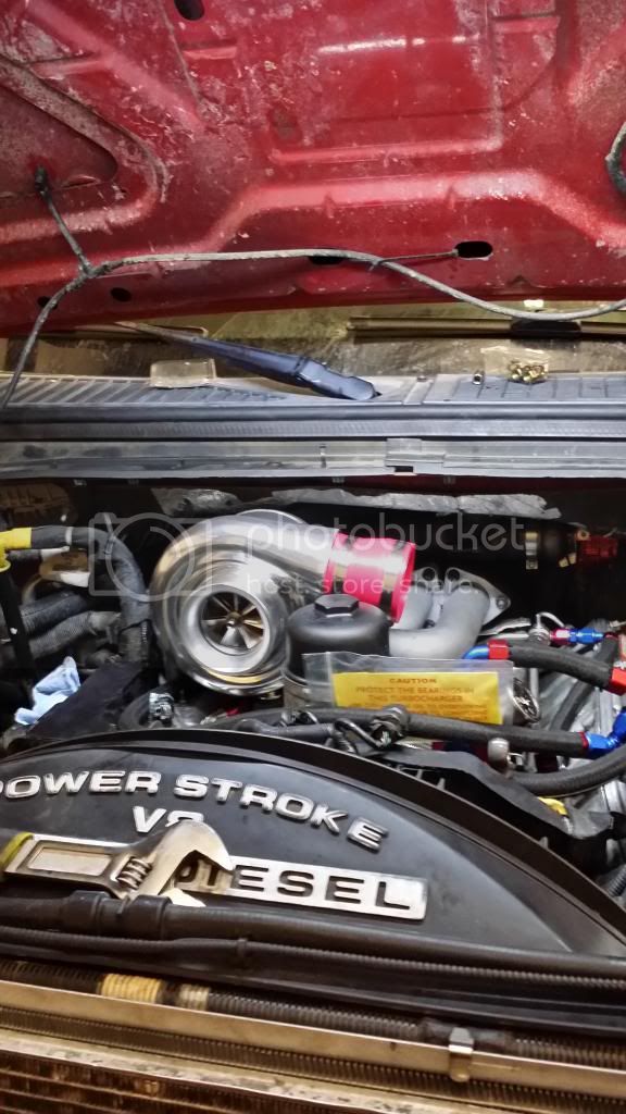

Turbo pedestal from Morgan mounted (I suggest putting the turbine side of the turbo on first then the center section, then compressor housing. I put the turbo on as whole and made for some tight spots). The kit doesn't come with new up-pipe gaskets, so I suggest getting new ones

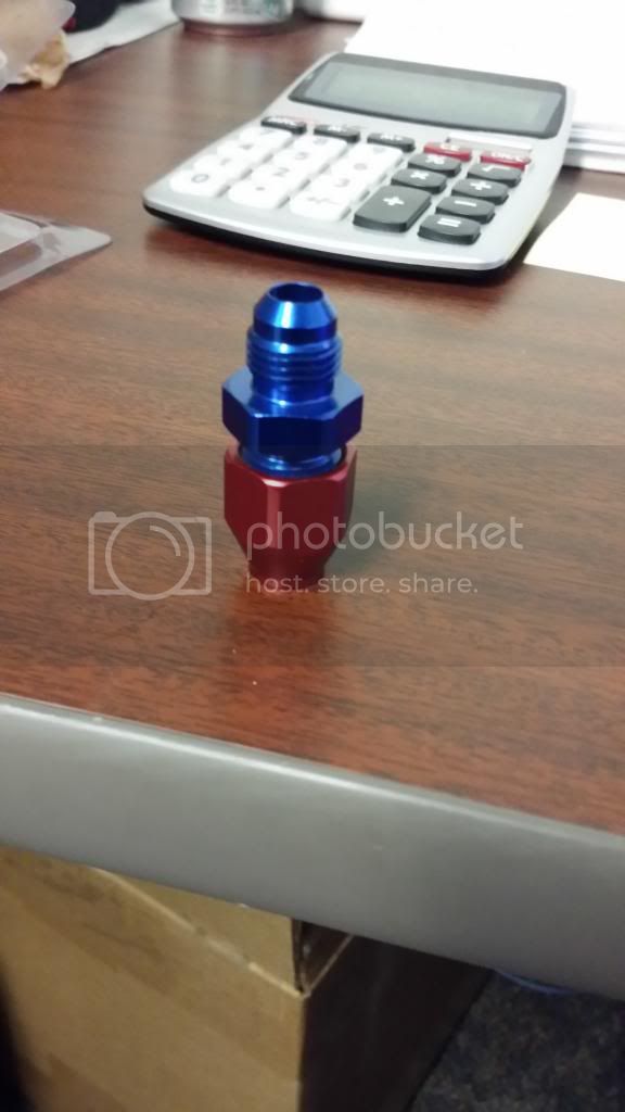

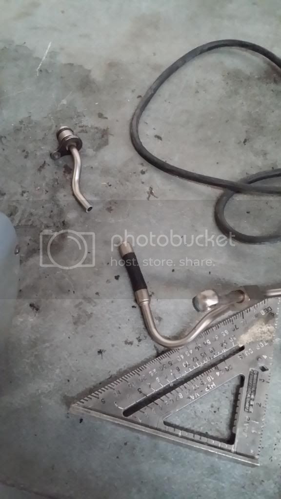

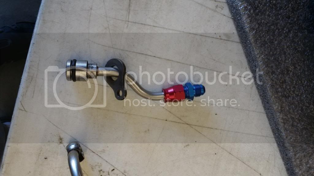

Little modification needed for the oiling side of the turbo, Morgan supplies a fitting to adapt the oil feed line to an AN fitting. In the kit he also supplies nice braded lines and an-fittings (ready to be cut-to-fit if needed but I left them for future application). Just modify your stock oil lines by cutting just before the flexable section of the line shown here:
Fitting that comes in the kit, just normal -6 AN straight fitting:

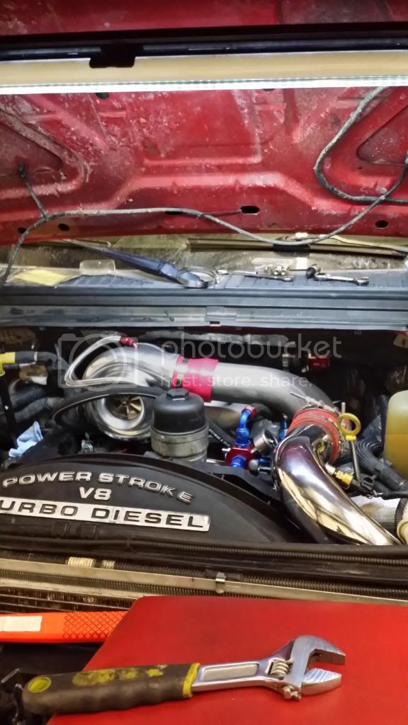

If done correctly, it'll look something like this:

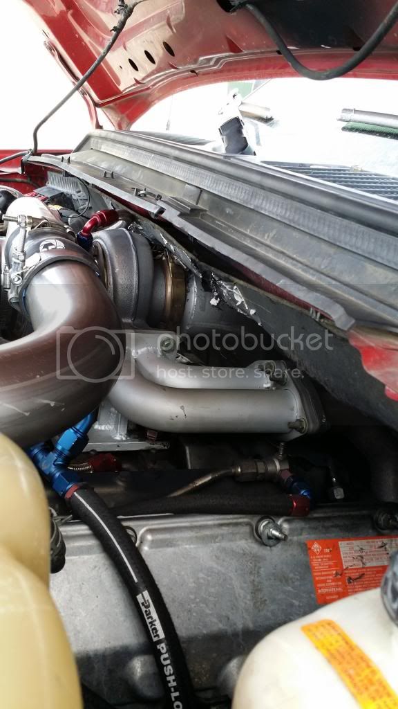

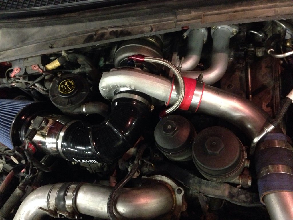

Pic of turbo mounted:

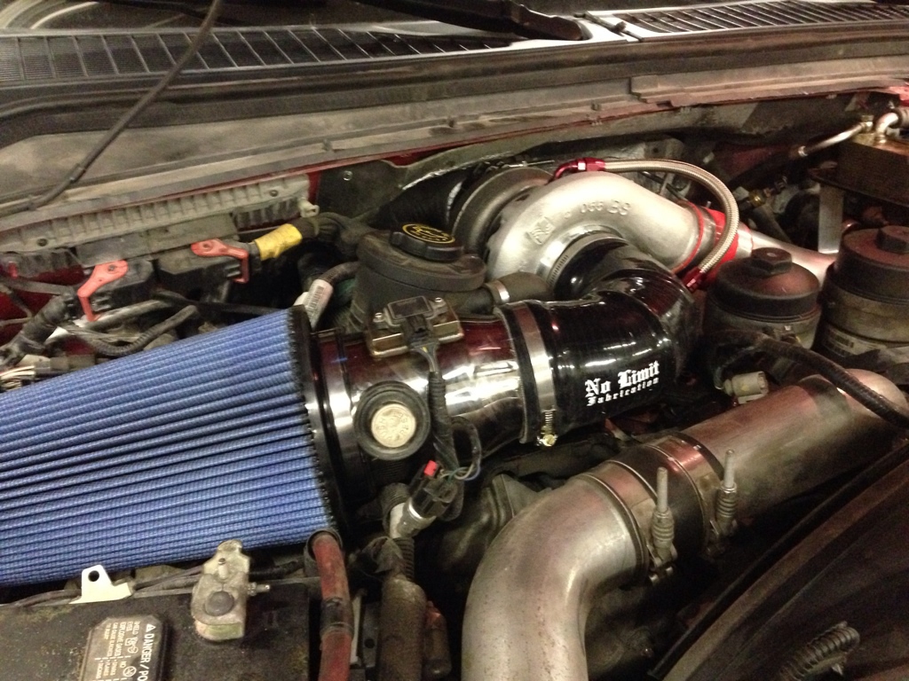

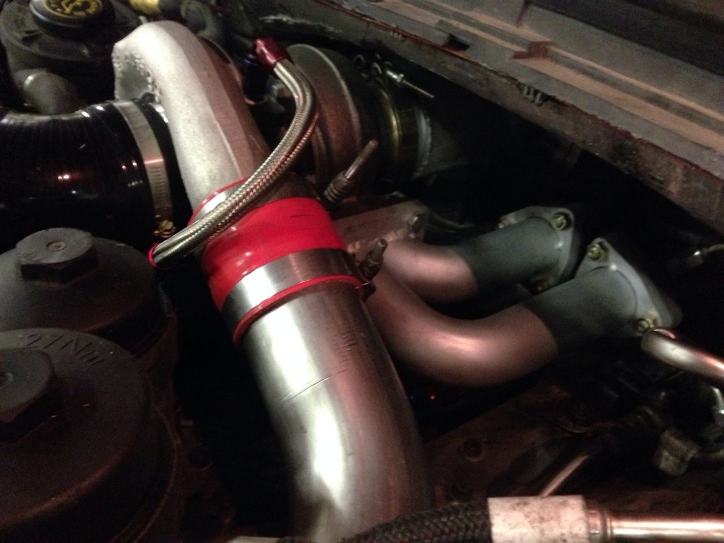

Pic of oil lines in, charge pipe on. Must say, this kit adapts well to the No Limit Fab hot side that Mike produces.

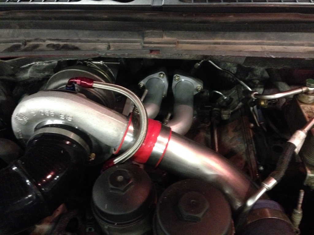

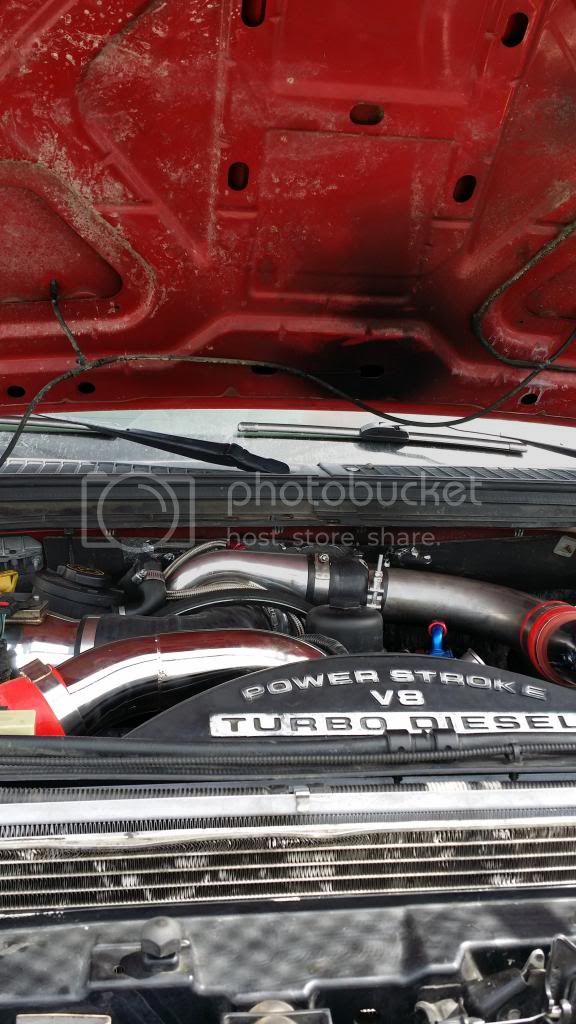

AND VIOLA! ONCE it's all completed it should look something like this. Highly recommend No Limit's Air intake to go along with this kit as well:

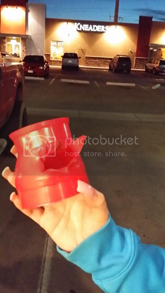

ALSO, make sure you use quality boots when doing this application, the S371 turbo I went with is actually designed for a dmax so the outlet on the compressor housing is a 2 1/2" and the charge pipe supplied in the turbo kit is a 3" (Standard S366 turbos and such are 3"). Check and double check your boots because this thing flat out rips! If not, this will happen LOL:
