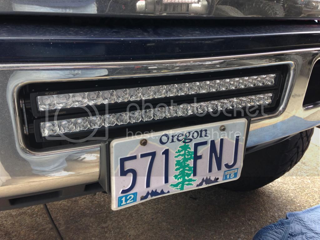

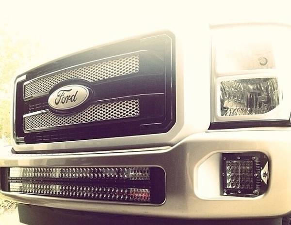

Here's in my 05-07, stacked 20" single rows. The single rows put out nearly identical to what a dual row puts out as it has higher wattage LED's.

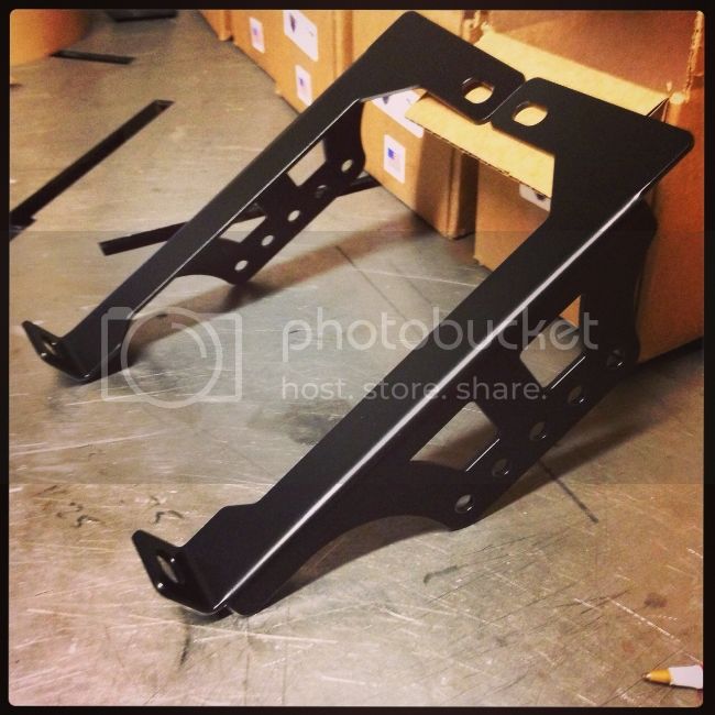

08-10 brackets are available soon for a single dual row, or stacked single 20" lights.

I took them out to get the brackets powder coated. Ill have everything back in later this week and will take some more photos from further away. One is flood, the other is spot beam. The flood beam is plugged into the factory foglight wiring while the spot is triggered with the high beams.

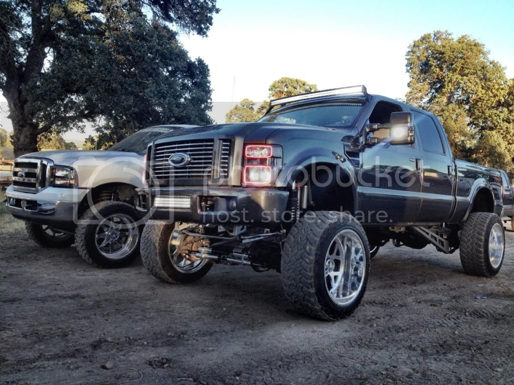

I really wanted to do a quad row led bar but I found a triple instead for a better price and almost the same amount of lumens as the quad row. To mount it I bought (2) 8"x 1" square pipe and a flat piece of metal to form the bracket imagine an "H" figure then I just bolted the bar onto the flat metal bar that runs horizontal I was happy with the results

These bolt to existing holes on the 08-10 trucks and can take a single dual/single row, or stacked single or dual rows.

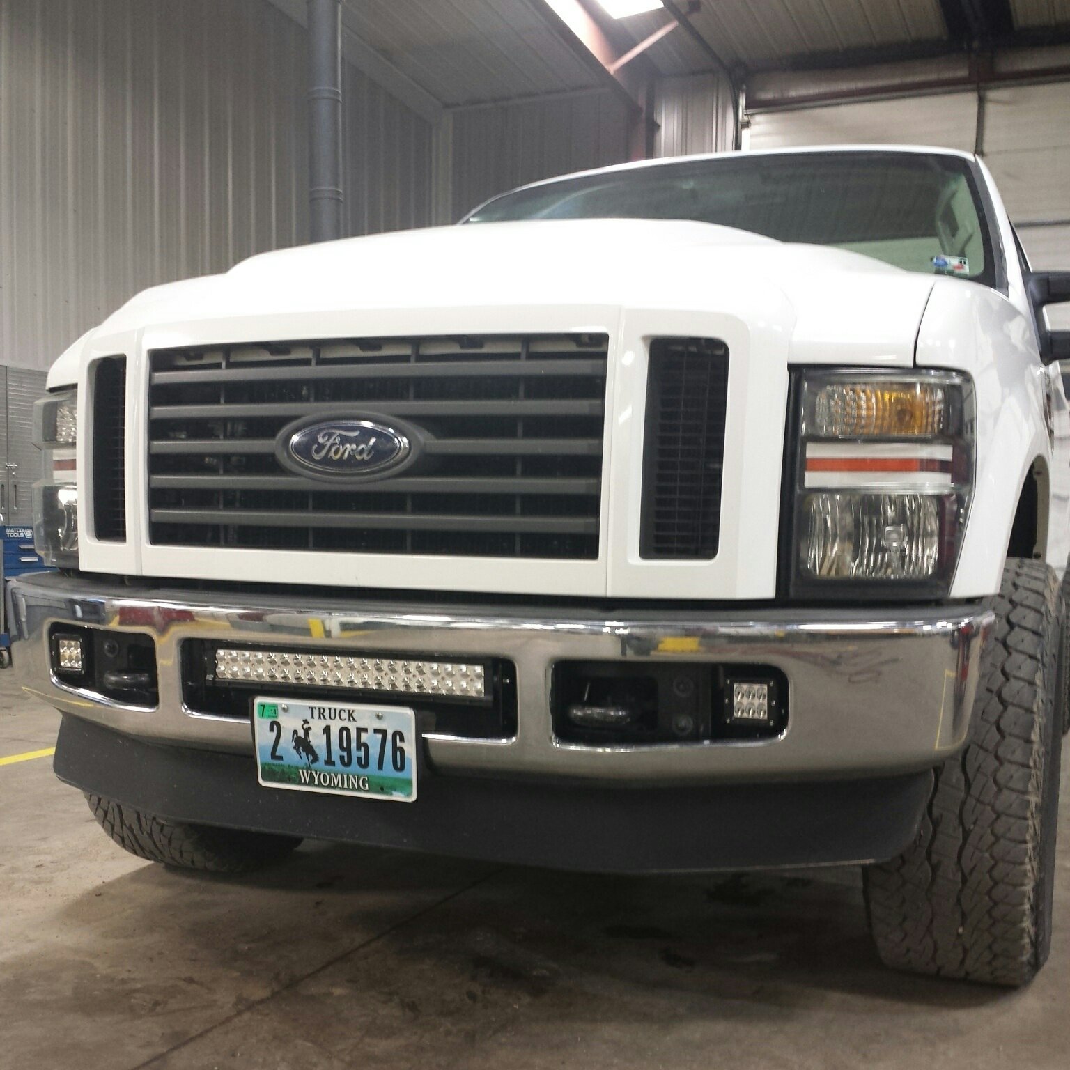

20" lifetimeled with kdfabworks brand new bumper light bar mount .
Bracket fits like a champ an is easy to install

They where done by derek @autobodysolution in modesto ca the projector and hid kit was around 400 the bottom led pods where about 200 for all 4 and then theirs all the red oracle leds thru out amd those where pricey also so all in all they where kinda expensive maybe around 1k but they have a lot going on ill post another pic
Ah...modded license plate bracket. Think this is gonna happen for me now!
kjdavis
Dec 31, 2013
62
:rockon:
Just cut the top of the bracket off above the back clip that hangs it onto the lower bumper opening and run the screws back into the plastic lowering the plate. Piece of cake!

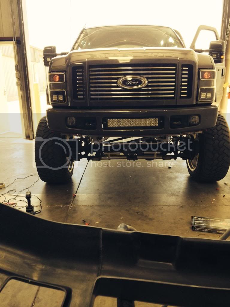

dumb question but... has anyone seen a temp increase with running the light bars? i want to run one in the bumper and one full length behind the grill. just scared that ill block to much air flow
kjdavis
Dec 31, 2013
62
I havent noticed any difference in temps on my truck. If you look at a lot of aftermarket bumpers they block that opening anyway, or put a winch in that spot.
