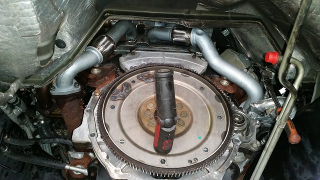

Tossing in a set of Rudy's right now. Man, I haven't done a lot of these 6.4's yet. Trans is dropped, now to fight all the bolts and nuts off. Even with Trans out of the way It's still a lot of work from on top.

This is maybe my third up pipe removal. Once cab off, one cab on Trans in and thus one cab on Trans out. Even with the Trans out there is no leverage. I have had to turn the turbo outlet red hot to bust the bolts loose. This isn't a dirty truck either, it has 62 K on it, figured they'd be much easier. My medium depth sockets are proving their worth here, as are my gear wrench moon set. I think next set will be cab off, I'm tired of this.
So far it's been 50/50 with working on top and bottom, my lift is getting an excersize that's for sure.

a second person is need to r&r the trans. You might be able to handle it yourself if on the ground, but I dont work on the ground and our trans jack is tiny, someone needs to be back there to support the T-case.
Flexplate/TC nuts are 14MM, there is 8 of them
Bellhousing are 13MM, I think there is 8
most certainly need a few 10mm and 13mm sockets and wrenchs. Ratcheting wrenches FTW. Short, mid length, and deep sockets, as well as a good set of swivels. A super strong flexhead 3/8's with long handle.

Ive never went in through the fenders on these. I looked at it today though in between the 2 hours I was hmming and hawing at the idea of pulling trans

can see here the meat and potatoes are still waaaay up here.

Starting to sound like a huge pita. Wish I had the means to pull the cab.
IF you dont have oxy/acetylene, dont do this job. Thiose bolts on turbo will break right off and/or round the heads very easily. Heat is needed to do this, and lots of it.
this was probably my best experience doing this particular job and I still had to bust out the heat wrench.
