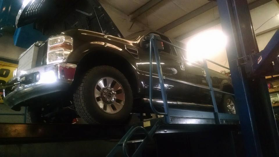

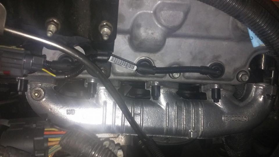

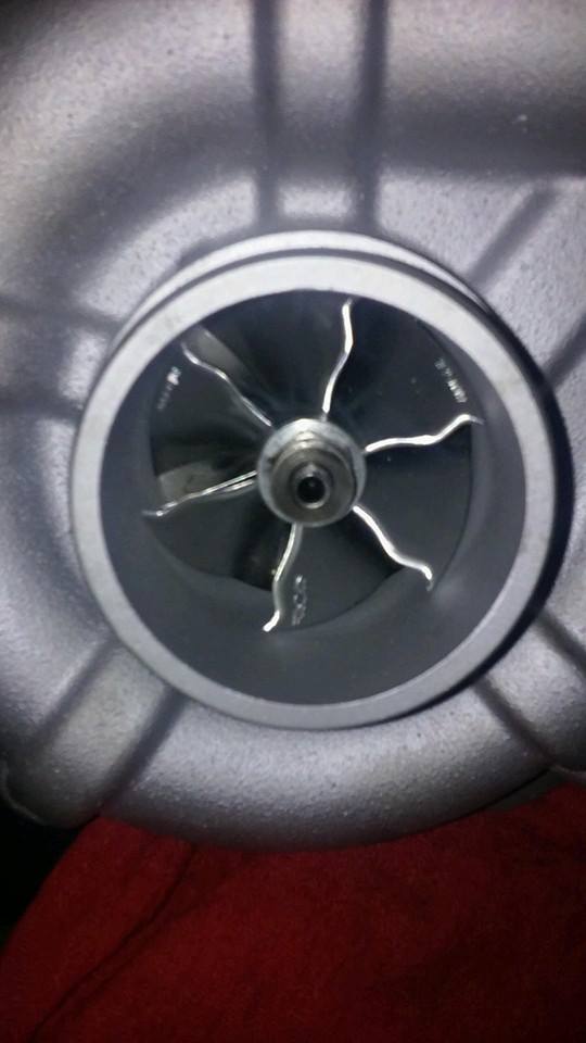

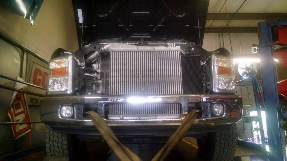

not many pics but here are a few shots

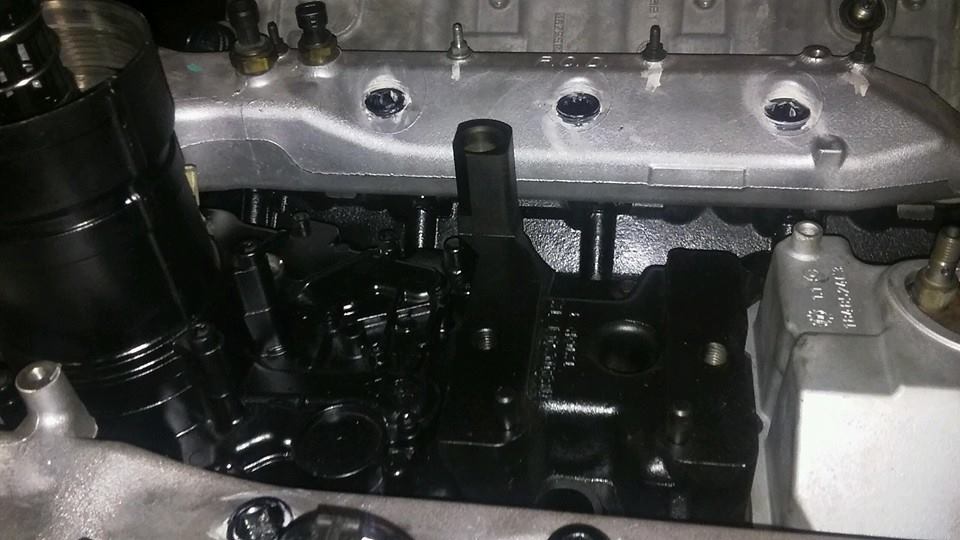

reason for motor build, thumping sound that lead to a broken push rod after tuned for 15mos @ 61K miles.
