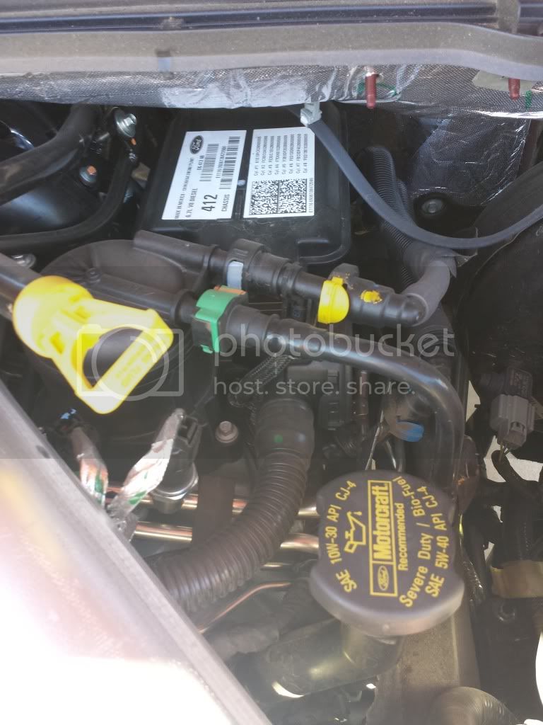

The solid one goes on the valve cover as well.
The hose goes from the ccv to the intake, the solid plate goes on the intake. The replacement plate that has the hole for the hose is where the ccv box attaches.
So stock it goes from the intake manifold to ccv box to hose to intake manifold. Make sense?
I know how it works I just don't see what is gonna block that hole in the intake. Both of the plates that come in the kit that is shown in that picture are both mounted on the valve cover. The solid plug mounts where the box drains back into the motor.
My bad, the first time I didnt see your pics.

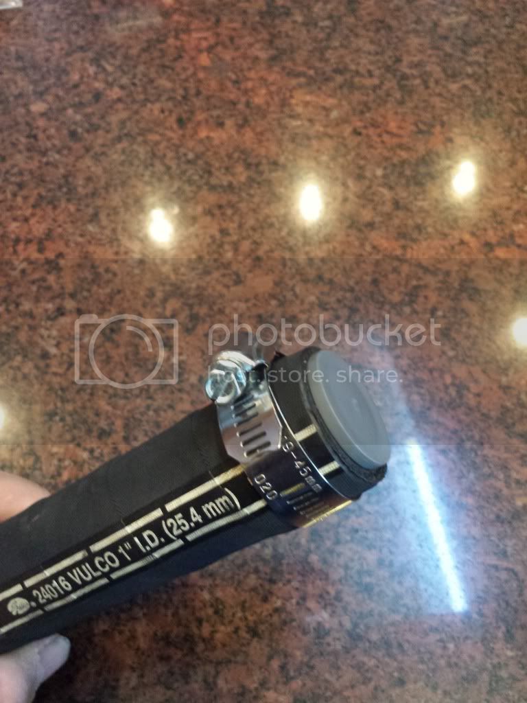

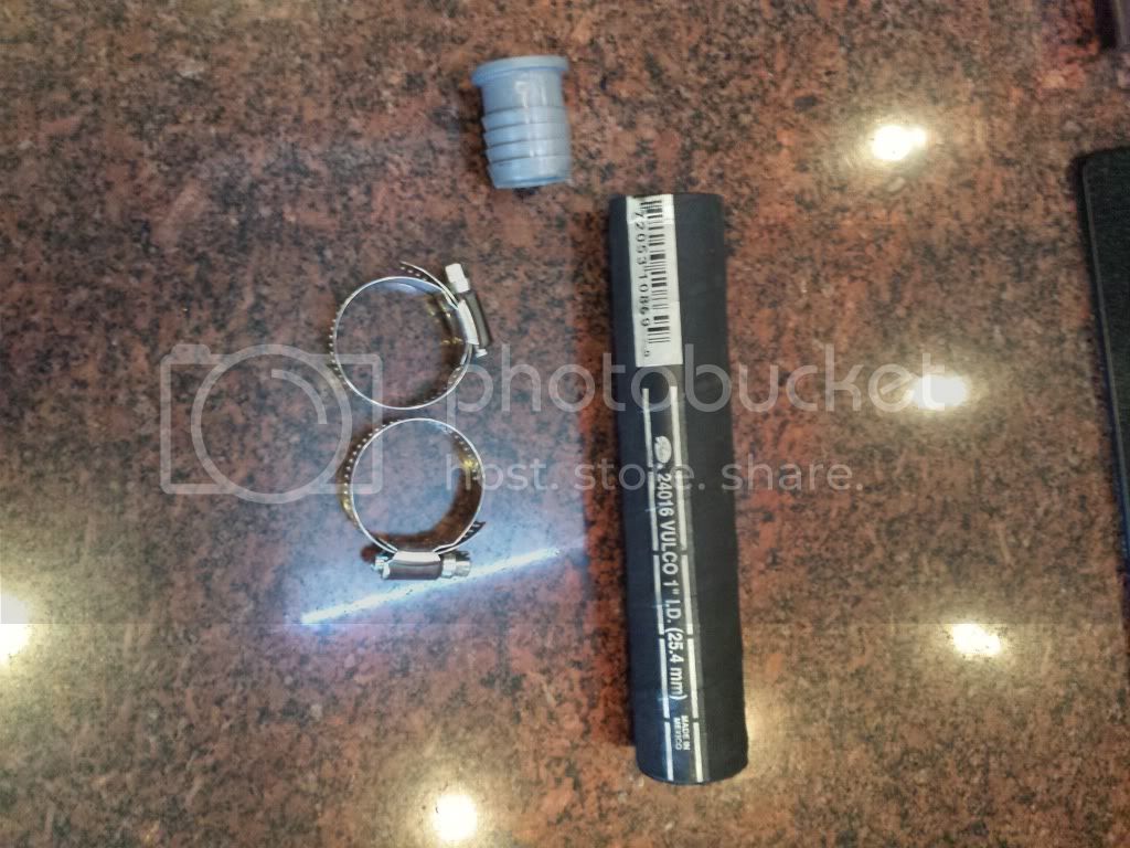

I have looked at all sorts of different hardware stores looking for a 1 inch rubber cap to go over the hole in the intake manifold and found nothing. So I figured that I would have to build something myself.
I took a piece of 1 inch ID hydraulic hose with a plastic plug that I found at a hardware store. I found the hose at OReillys and since I didn't need much he just gave it to me.
My truck is getting a light bar mounted this week so it will be next week before I will be able to install it.
