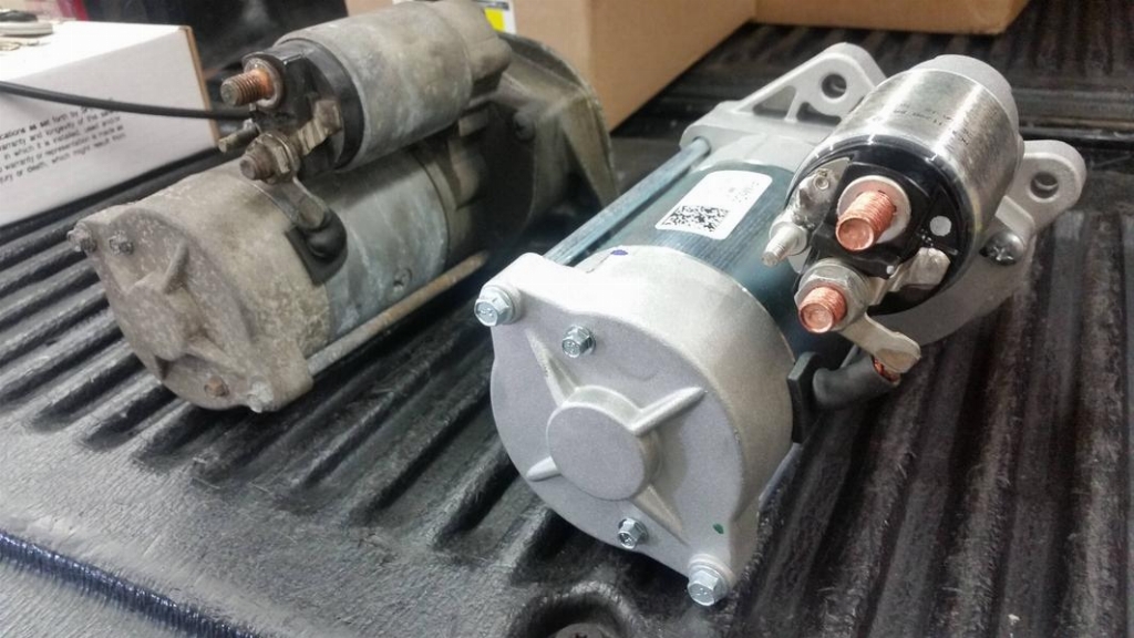

I just did this swap today....huge difference in cranking power. I originally put the SD 7.3 starter in my OBS back in the day. The SD starter started to have a slow death. I would crank fast then it'll slow down. Batteries and cables are fine. So before it totally dies, I put the 6.7 starter in.
Yes, the nose cone needs to be swapped over. You have to take the starter to do the swap but it's worth it.
There are plenty of threads on how to swap nose cones.
I bought a new 6.7 starter from my Ford source.
The old SD 7.3 starter is on the left and the 6.7 one on the right. The nose cone swap wasn't done yet. But you get the idea.
I highly recommend this.
