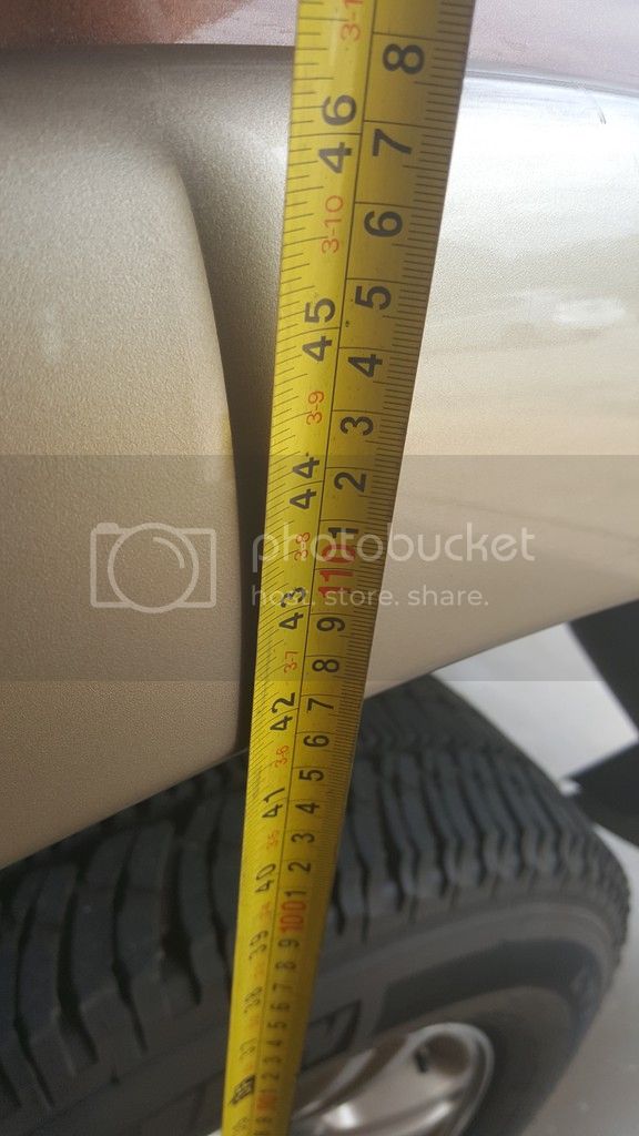

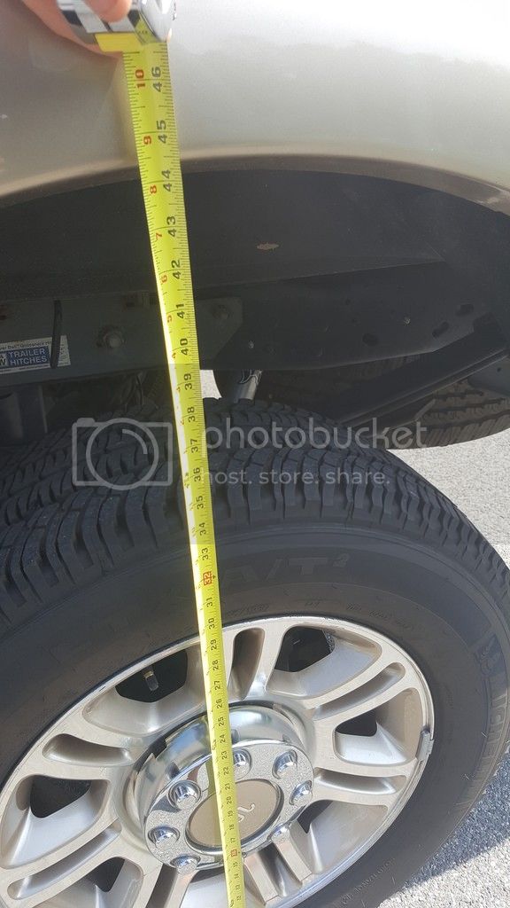

Stock with stock tires:

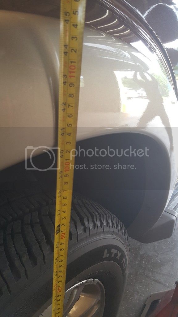

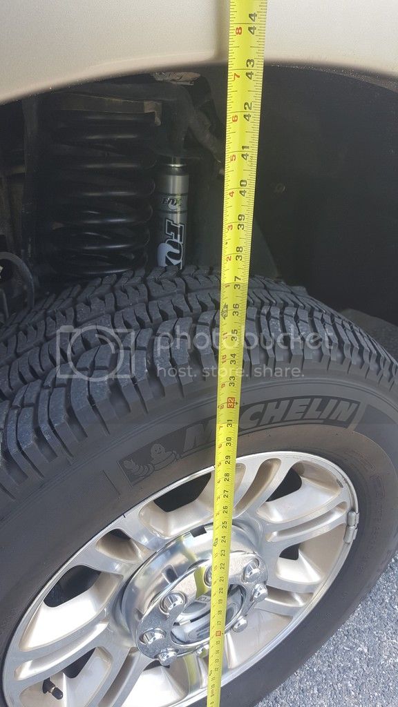

Lifted with stock tires:

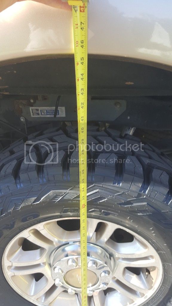

Lifted with 37" Toyo RT's at 40/35 psi:

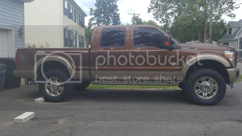

The truck is now 7' tall....just shy if I recall correctly. I'll update this thread with an exact height later today.
