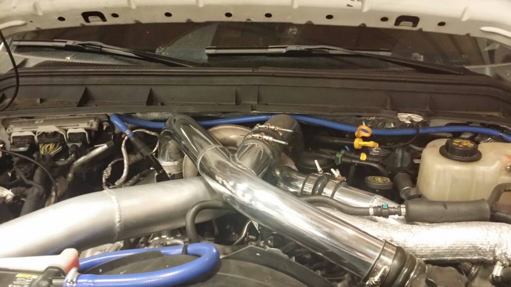

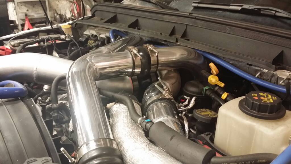

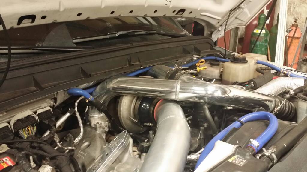

Here's a few pics of our s400 kit uses the same manifolds, pedistal, and y pipe as the s300 kits...turbo has be purchased threw us and as of now we can do 67fmw, 72, and 75mm
Right now our test truck is my 2013 dually with just deletes and torgue tuner..will be doing some towing this week threw the mountains so we will see how it does seems to spool very nicely as of now with no custom tuning uploadfromtaptalk1410829854218.jpguploadfromtaptalk1410829862864.jpguploadfromtaptalk1410829868558.jpg
Right now our test truck is my 2013 dually with just deletes and torgue tuner..will be doing some towing this week threw the mountains so we will see how it does seems to spool very nicely as of now with no custom tuning View attachment 30740View attachment 30741View attachment 30742
