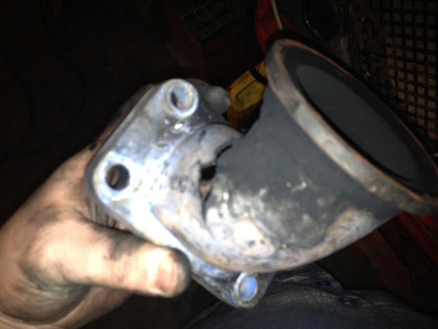

I blew there adaptor apart two times! Lol the second time it was too bad to weld ImageUploadedByTapatalk1336200184.477228.jpg
And the way the turbo just floated destroyed two sets of up pipes.

I blew there adaptor apart two times! Lol the second time it was too bad to weld View attachment 6020

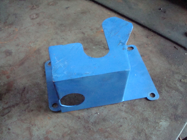

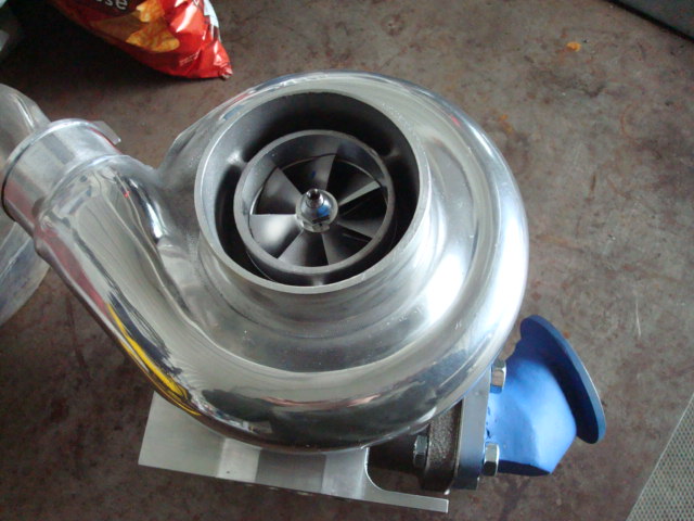

My TP has been flawless. I know what you're saying about the "so called" pedistal...i'm not sure i'd even call it a pedistal because the turbo doesn't even bolt to it. Didn't have any issues with the drain line. Chad said that he made my drain line a little different and when they tested it, he said it worked better than the others they made. Here's some pics of pedistal and drain line.
The only reason i got this turbo is because they were coming out with this new turbine housing that was supposedly change the turbo world for the 6L. However...i think we all know how that's turned out so far. I did however contacted Chad a few months back about the housing and he told me that they are getting very close with it and have made multiple changes with it to improve it and didn't want to release anything until they were absolutly happy with the results.

I would be right proud if my pedistal looked that good lol. My looks like Ole one eyed farmer John welded it together. It is the second one that I have had, due to me complaining about the first one. But looking at that one. How the hell does the turbo mount on it lol?
I have broken one adapter and destroyed 1 set of up pipes also. Haven't had any problems with the oil line.
I do like the turbo, it lites really fast and pulls hard with the 190's. I am going to try to come up with a way to secure it better than the pedistal it has, or it has to go. I can't keep buying adapters and crossovers. But like I said, the pedistal in the pictures is not anything like the one I have. Mine is just a home made thrown together welding job. It is a shame that such a good running turbo was sold with such a crappy pedistal.

haha that's the whole thing...the turbo doesn't mount it. The turbo only sits on it. Only thing that keeps the turbo from moving is it being clamped to the Y-pipe, down pipe and hot side CAC pipe.
