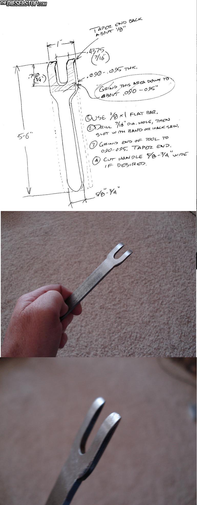

make or by one of these for the hpop line removal

neverkickn
2,692
AR
It is used to remove the hpo lines from the fittings. You will need something like that to remove the lines if you have to return your old pump as a core. Most places require you return the fittings with the core.
JHILL
124
NW Oregon
takes 5 minutes to make.
1/8" x 1" x 8" flat bar, drill 7/16" < 1/2" hole centered in one end, clean up burrs slide under fitting and pop off the line.
