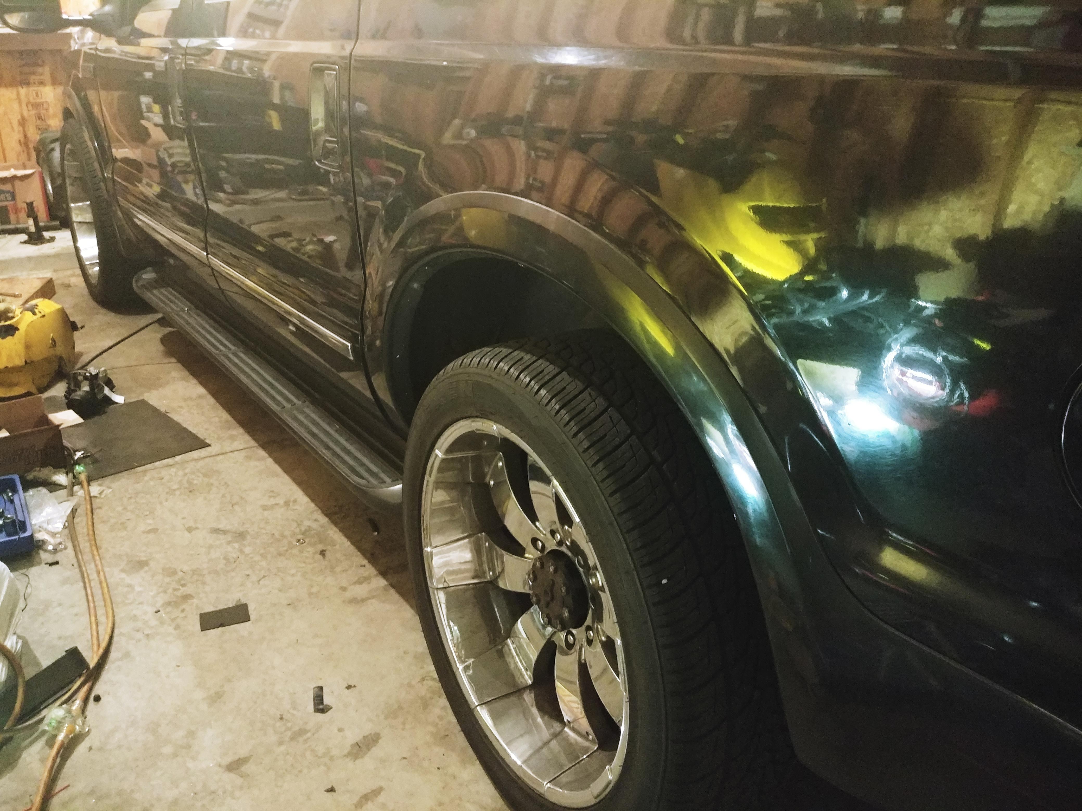

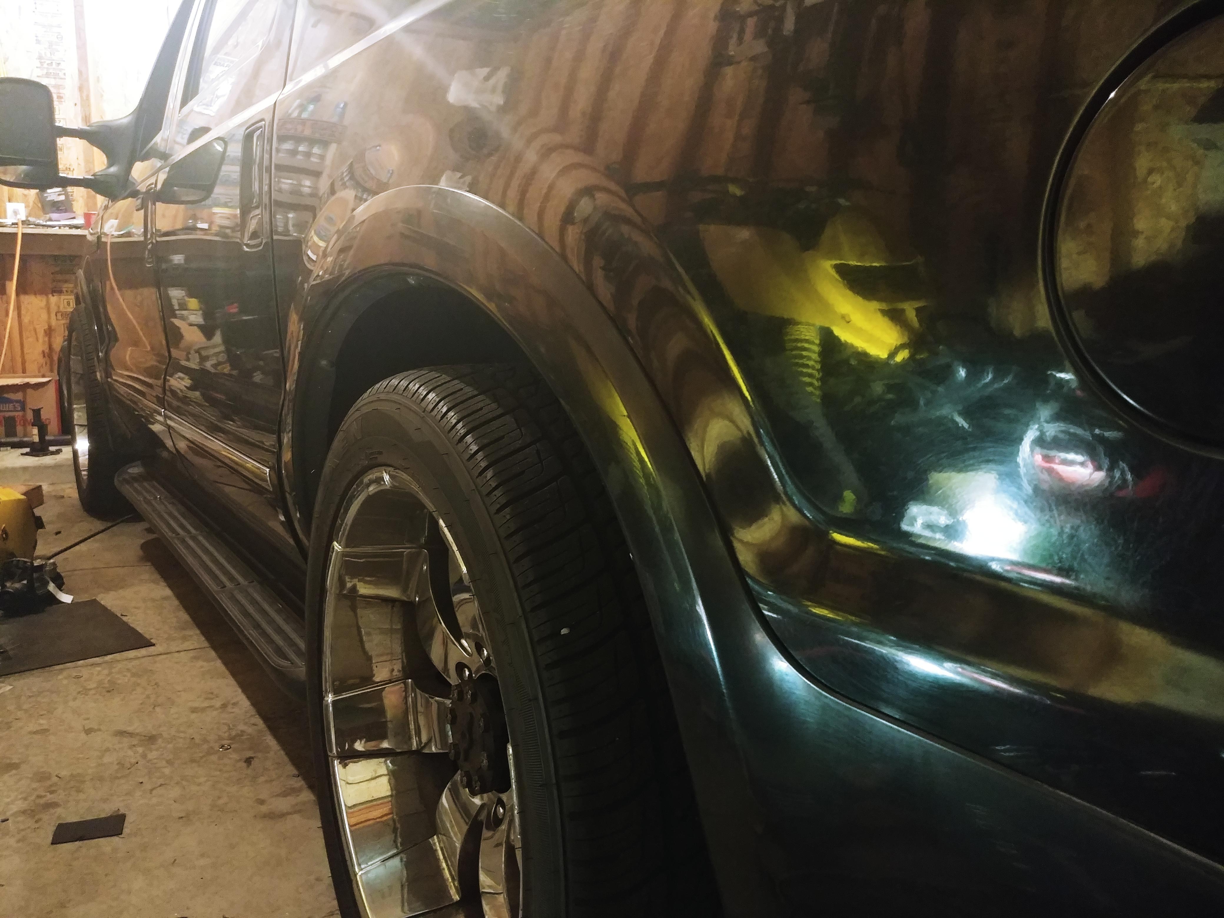

60 psi.

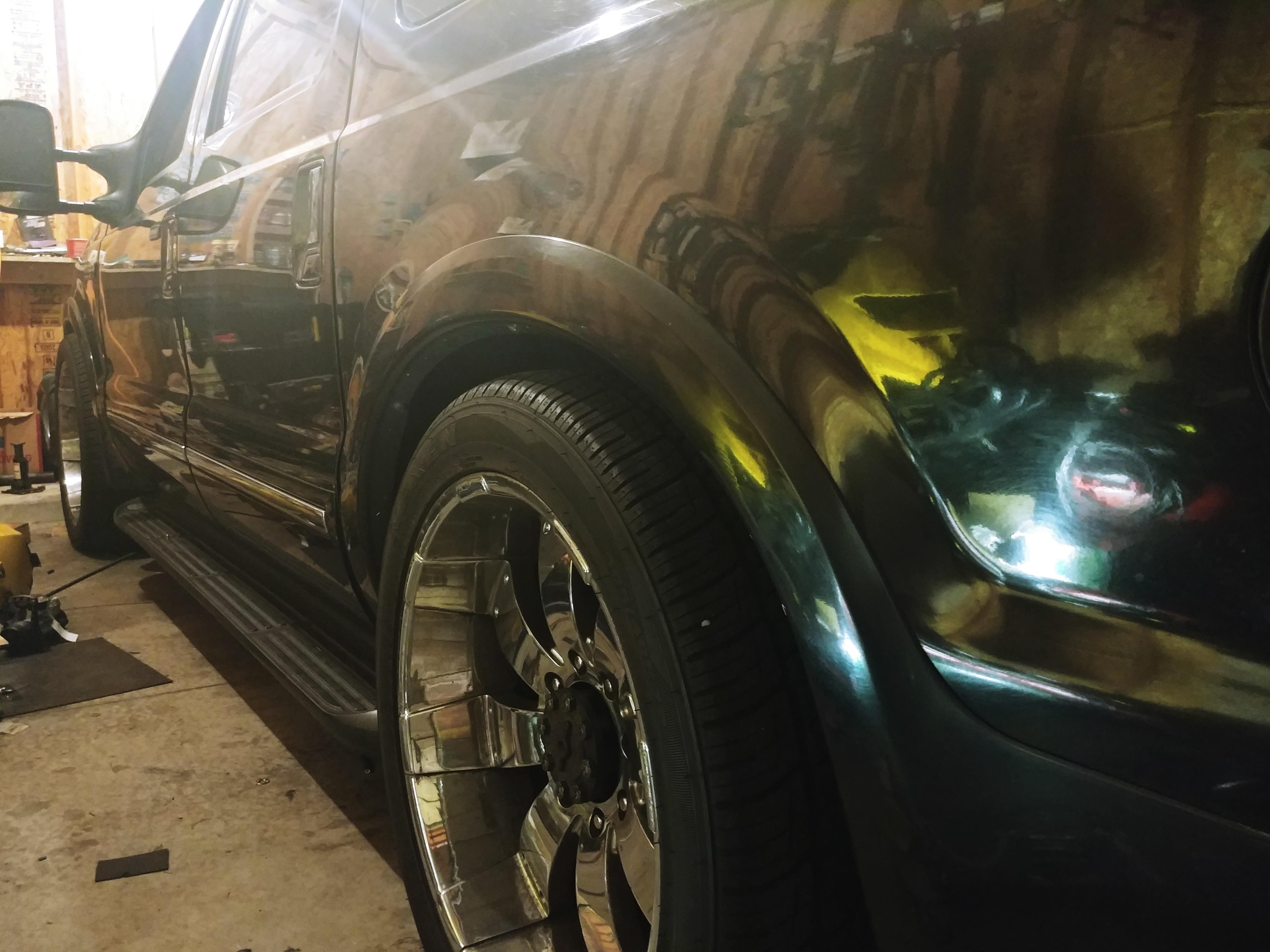

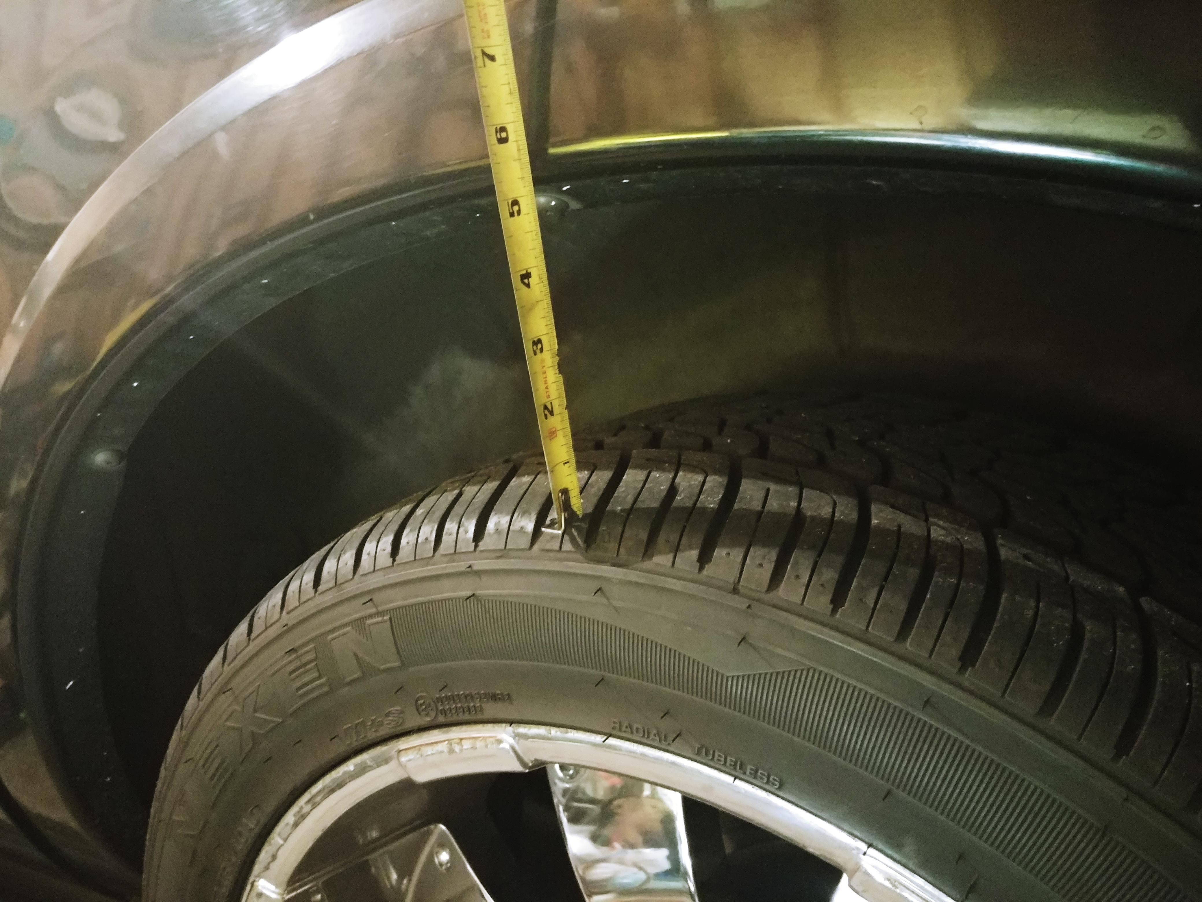

50psi

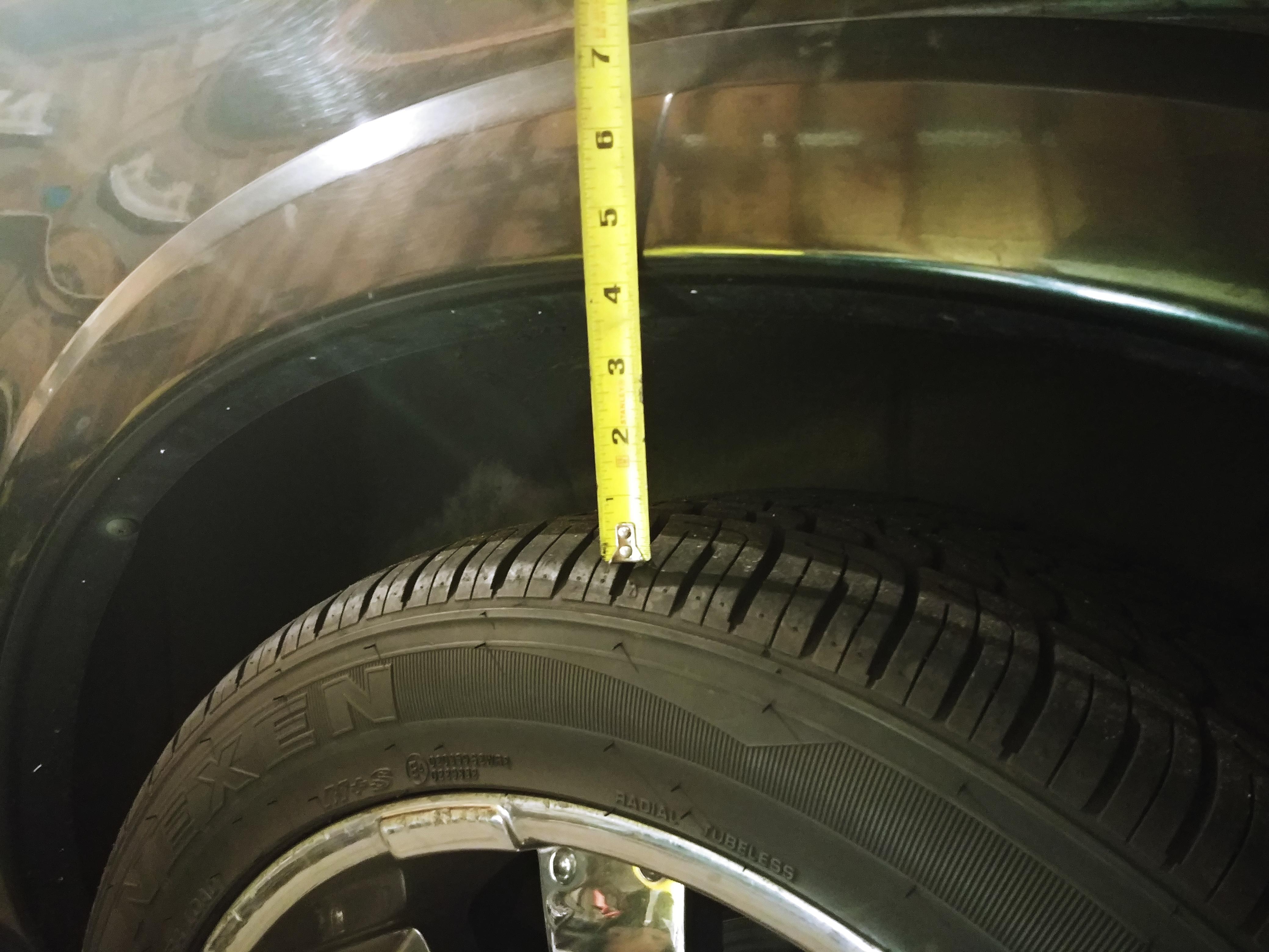

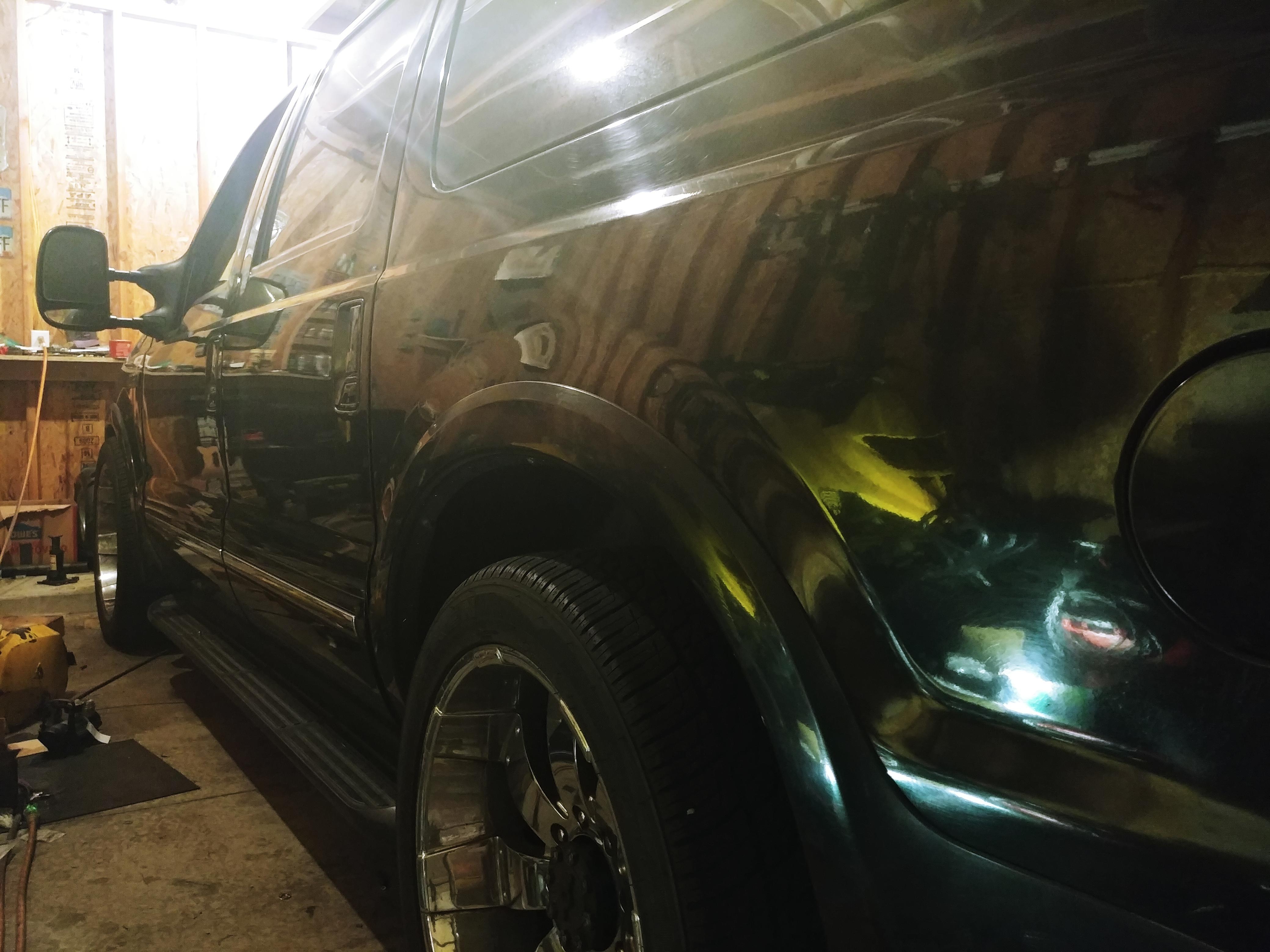

40psi... Drive height for the last 500 miles.
