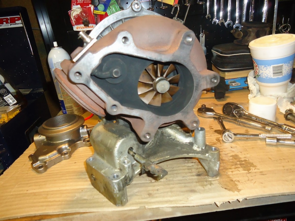

I've torn down 2 turbo's, one from an SD, and one from a van.
Both had the same internals - just the housings were different.
And I'm using the turbine shaft from the van's in my project turbo build.
I needed a gated housing - and managed to pick up a Banks housing on the cheap.
Here's the link to my build, (more like re-build+upgrades)
https://plus.google.com/photos/111707250377972824380/albums/5755962361649501393
and here's a photo of the van's shaft/turbine and the back side with the Banks housing.
No difference in the turbine side as near as I can tell, and it clearances the housing fine.
