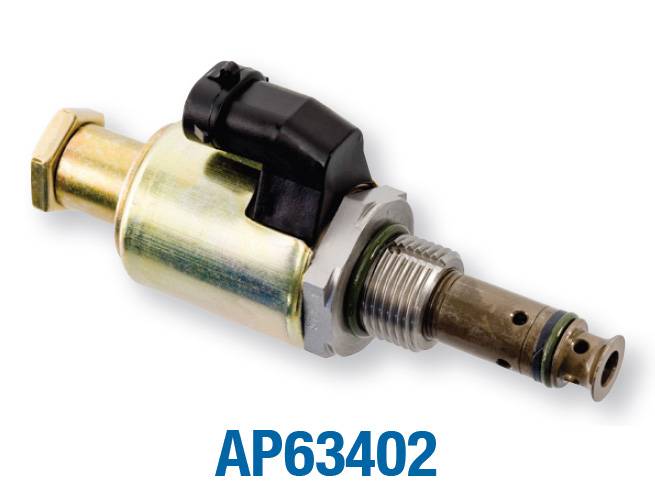

hpop was bosch and the ipr is ford I guess the only other thing that did baffle me and I just thought of the new ipr on the very nose that goes into the pump is capped off and the one that was in my truck was not and the one in my wifes is not maybe that makes a huge difference?

What do you mean its capped off? If there was a plastic cap on the ipr, are you saying you didnt take it off before installation?

well from my quick research the ( cap ) on the end is called an edge filter and is only for the model 94 to 95.5 so the mighty intelegent folks down at ford sold me the wrong one and I didn't think much about it they change designs all the time. I will change it and report back.

no I tried to post a pic but couldn't figure it out it seemed like a cap plugging of the end of the ipr I wouldn't come off it was metal and yes I removed the platic one that protects it before installation
What is the part number of the IPR valve?
Edge Filter
NO Edge Filter

Yep that was the problem i went and got the right ipr installed it and had 3500 psi in two cranks. I will have to put everything back together and i will post the results. I have to replace the furl pressure regulator on the bowl because it broke while taking it off but i should have it together in a couple days.
