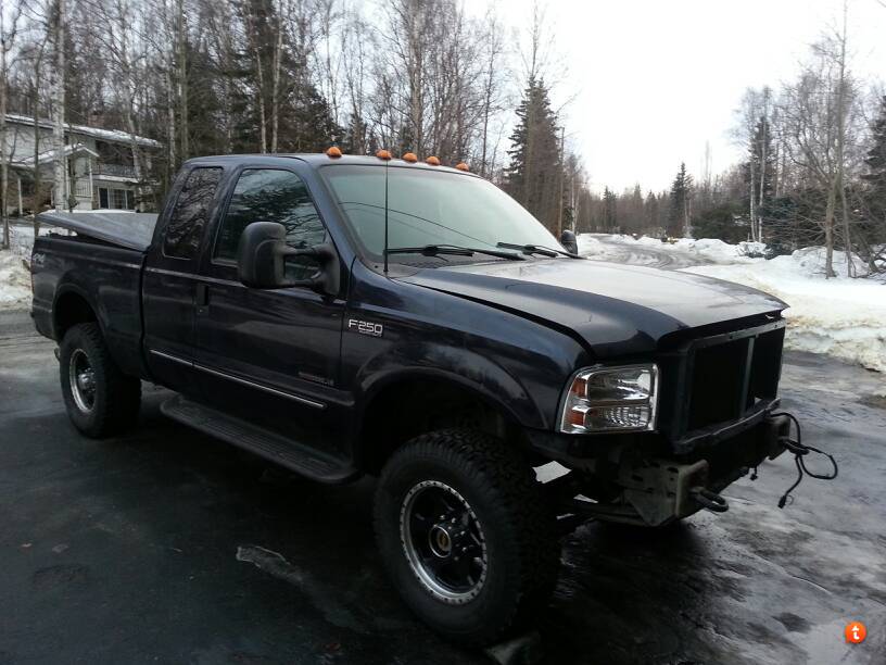

I'll post up vids and datalogs of the GTX4294R w/Garrett 1.15 just as soon as I'm back together too...05-07 front end swap...and I found I popped one of the pita freeze plugs on the back of the block when adding coolant the other day :(
