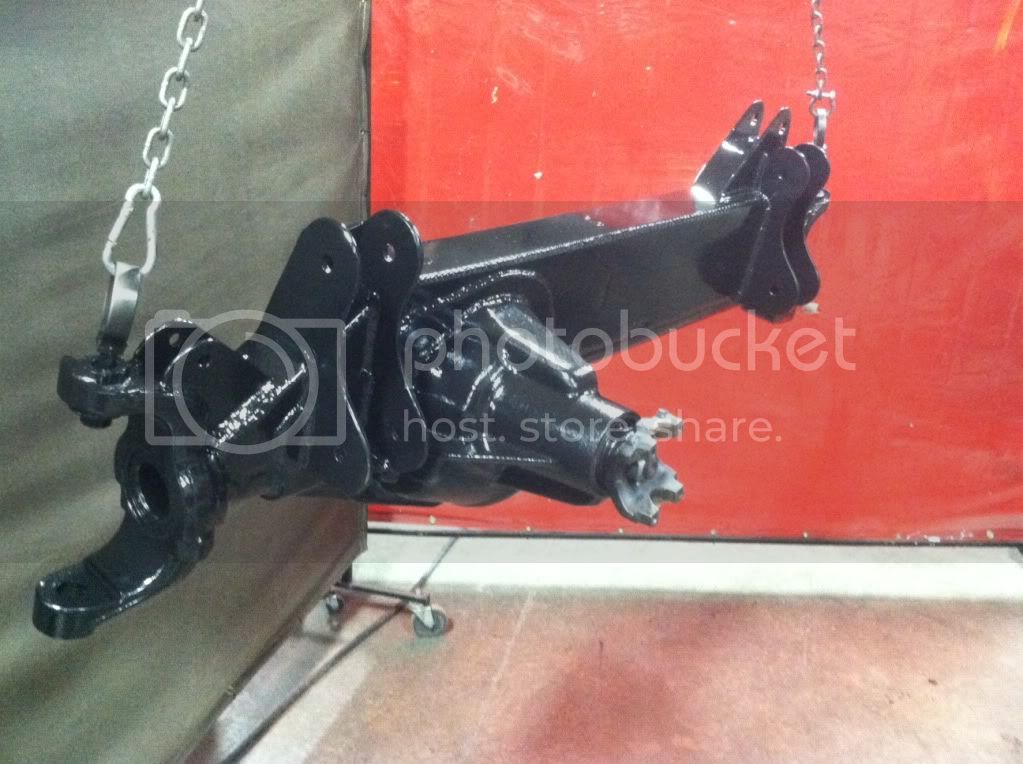

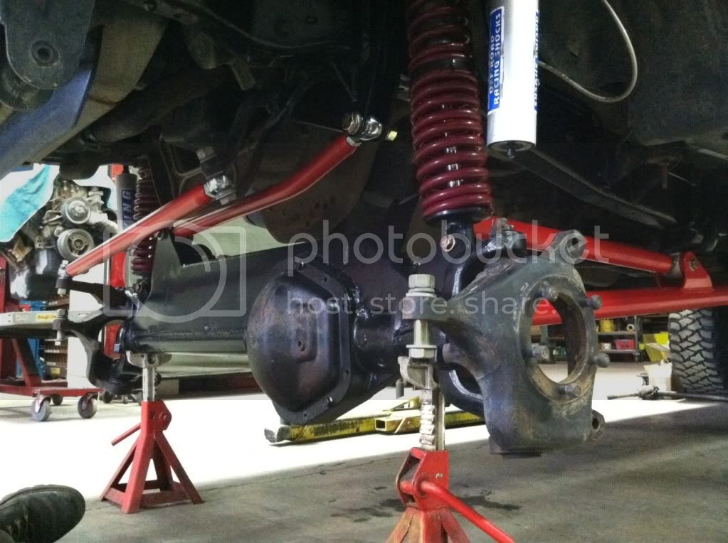

Like said, definitely get rid of the dana 50. If its anything but a DEEP mud truck or show truck dont use leaf springs because it will ride horrible having that much arch in them. When I did mine I just used King coilovers and built a truss and radius arms on my factory 97 dana 60 housing. If you are as proficient at fabrication as you imply then I would say this is your best bet because it is easier to find leaf sprung housings than coil sprung ones.
here is what I did

that is nice work. I agree that is the only way to go to have a big truck that actually works. leafs suck
