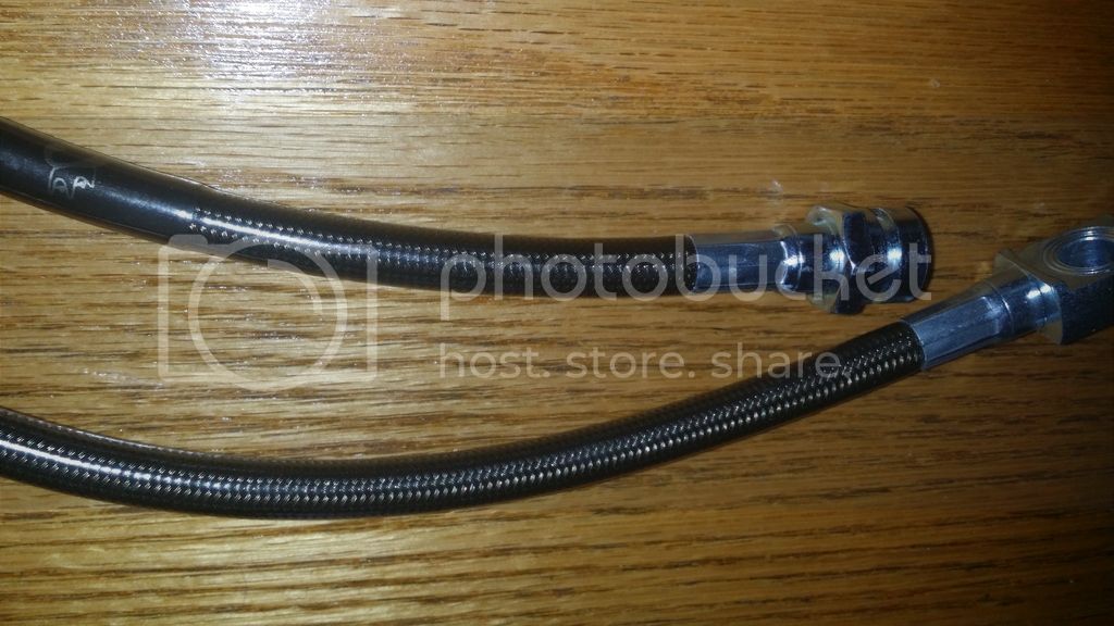

Holy ***k this **** is nice...
TyCorr
Jun 23, 2011
15,461

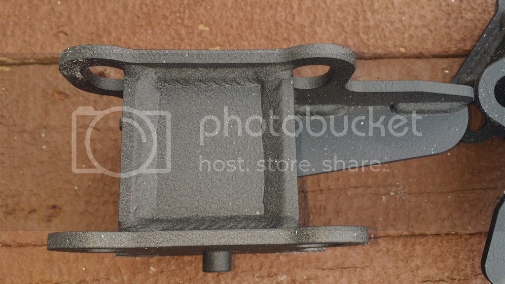

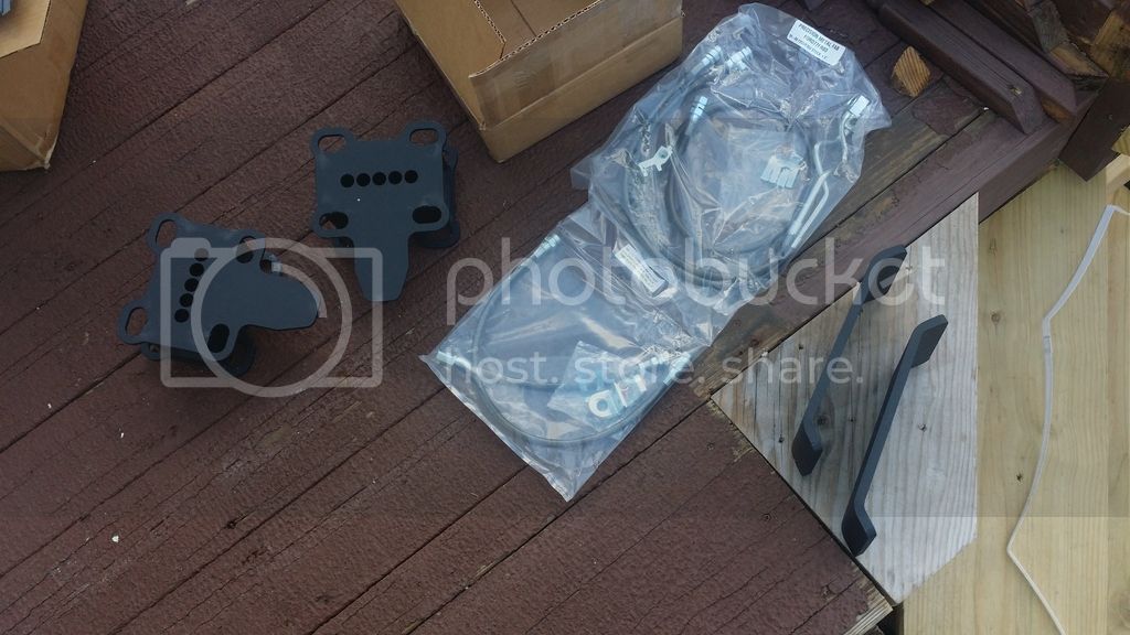

These brakelines are nicer than my truck! Smoke replacement for all four corners and the rear axle to the fitting on the frame.
I got a 3.5" block with airbag tangs welded on for an extra $70. I think the blocks were 135 (35 upcharge for 3.5") and 70 for the airbag tangs. God they're nice. They have a penetration through which you pass the ubolts to secure them. If you can see in the photos the block AND the top plates are adjustable if your axle doesnt seem centered.
Pmf=nice products for an affordable price. The value is outstsnding.
