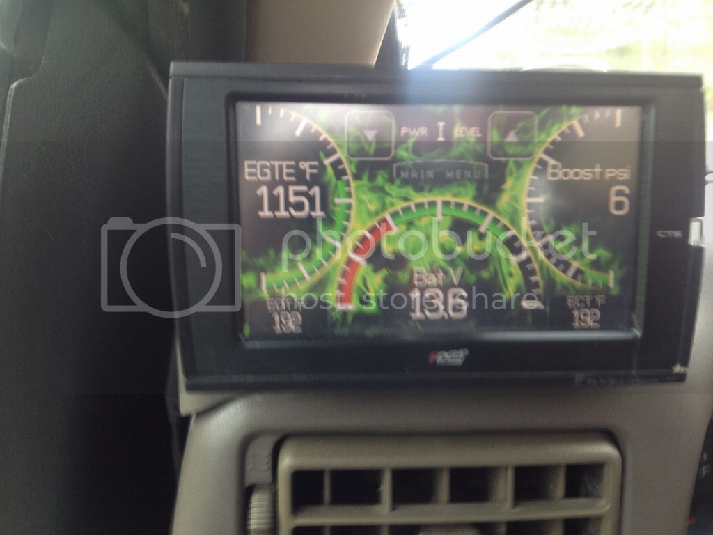

Stupid deltas from dumb non-working delta kit at 80mph, about 20 minutes of driving, about 60* outside:
imelmo
6,635
awesome deltas. toasty egts for just cruising, no?
Yeah, I believe it has some boost/exhaust leaks I can't seem to find. It's going to Truck Source Diesel in a few weeks to have a bunch of stuff done so I'm sure they'll figure it out. :D
