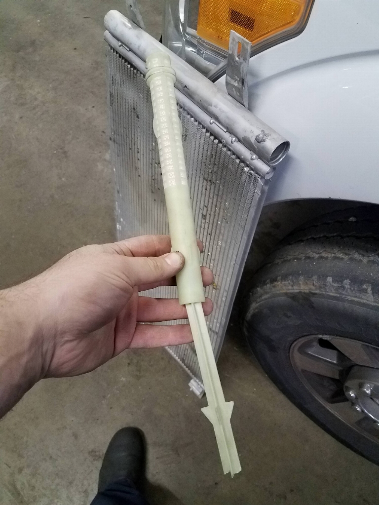

Ok what's the story here?
I removed a dessicant sac and am being given some filter cartridge that doesn't fit the original condenser.

Ordered from Ford and it came with baggie.. still.didnt want to fit in end cap though.
Just ordering entire condenser from now on

they updated the receiver dryer sometime around 2013-2014 requiring the replacement of the whole condenser... there was an SSM about it at the time but i cant seem to find it now

Just went through the same **** on my 11 after the A/C compressor bearing locked up. I figured I should just do a rebuild as I have had a slow leak that still does not show any dye. Every aftermarket sack does not fit. I even tried a Ford OE and it did not fit. Ended up just replacing the condenser.

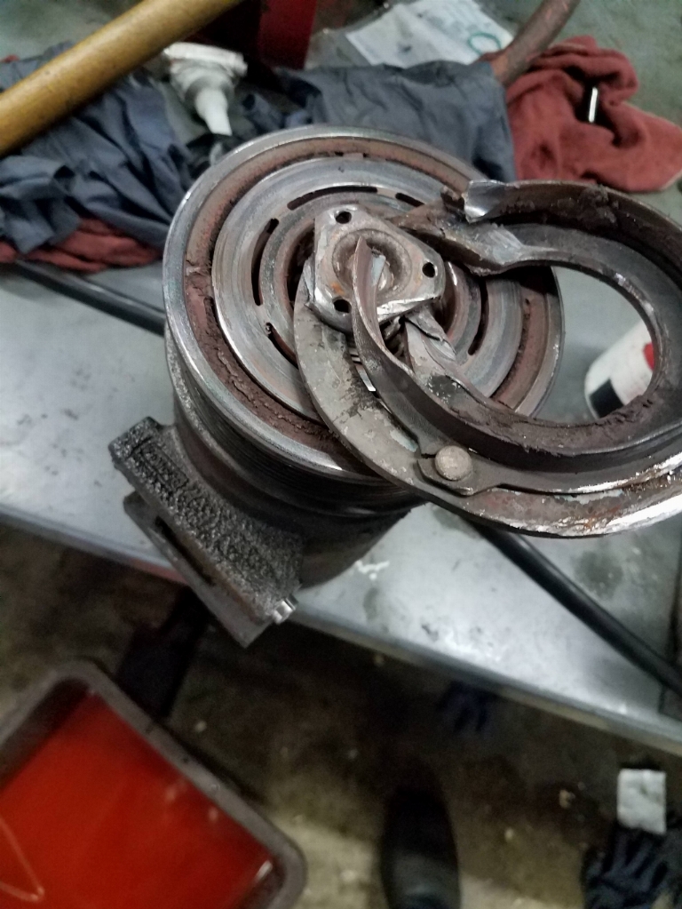

This was off that truck. It was bad dude. The belt rode off the pillows for a long time and actually ate through the tensioner and then when it broke it took out the fan too.

mine was not that bad as I caught it in time. Sounded like an old school roller skate wheel. When I got the belt off I could not turn the pulley by hand.
