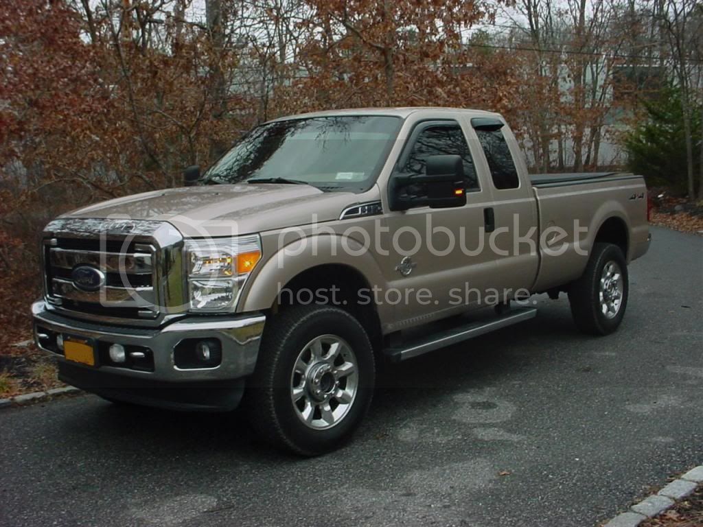

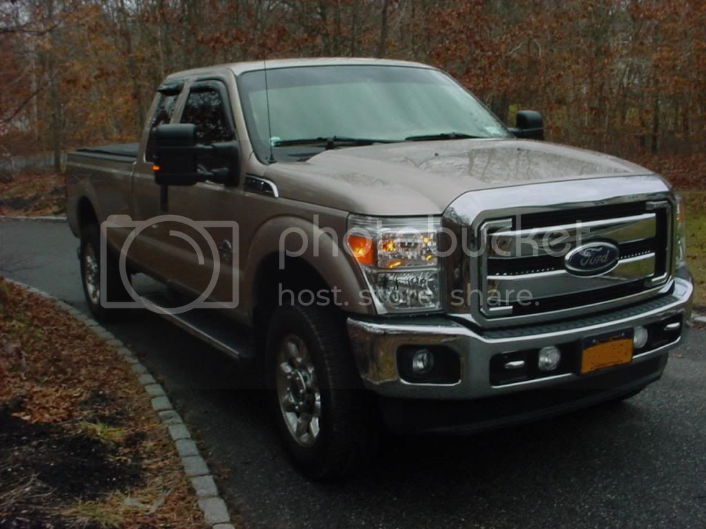

I finally got my hood and fenders painted to match the rest of the truck.
(1999.5 7.3)

Are those superduty fogs with factory brackets or aftermarket, iv had the same idea

Great job!! Real clean fit up, and it looks darn near factory to me. Anyone looking in their rear view would have no idea!

Good work man!

Great job man, looks like a new truck! I bet it freaks people out when they hear it...LOL

that is BAD ASS!!! I'm gonna show this to my uncle who has a 01 7.3 but doesnt want to part ways w/ it. awesome conversion!!!

Thanks If your looking for a chrome grille check ebay I've seen them selling from $400 to $500 in the past couple weeks.
I have a bunch of pictures of the install but I have to upload them. I basically modified a set of 2005-07 f250 fog lights. The best part is I didn't have to drill or make any holes in the bumper.I used the the holes that were already there on the stock ford bumper.

even though I'm not the biggest fan of the 6.7 nose this is still a great conversion, I know i'd be confused if I saw and heard it
