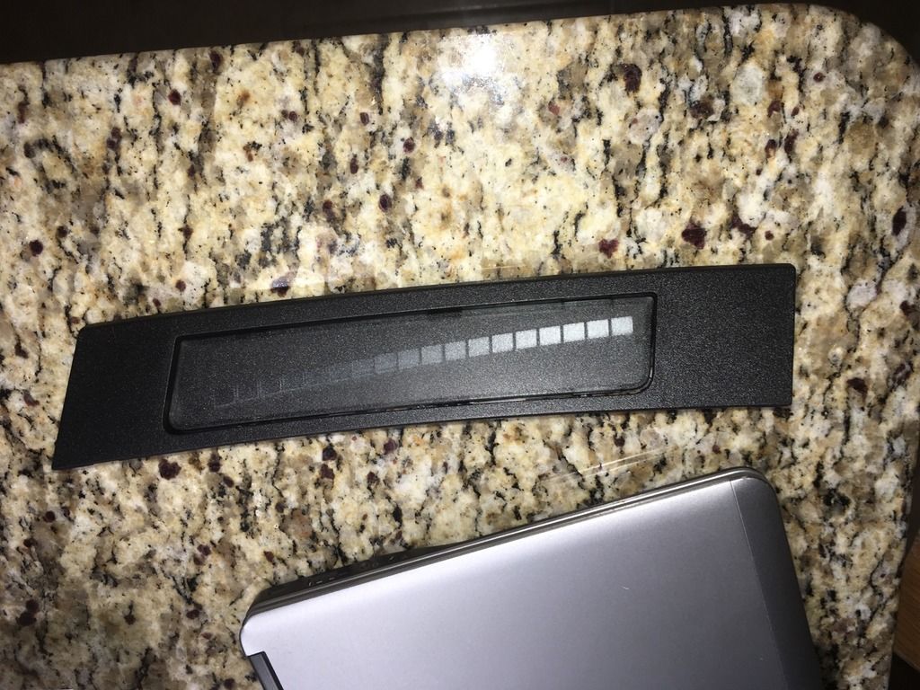

Just wanted to give y'all a little update guys.
We have some issues with programming hopefully in the following week we will get it lined up we got the IPC programmed but we cannot get the CCM programmed. We are trying to fine the proper value data to enter in the CCM manually.
We also arent getting communication to the adaptive cruise switches so possibly we dont have the right part numbers on the switches.
But so far we have programmed with the IDS not Forscan since we cannot write IPC with Forscan. Here are a few photos
Since I have a aftermarket bumper the mounting will be different.
