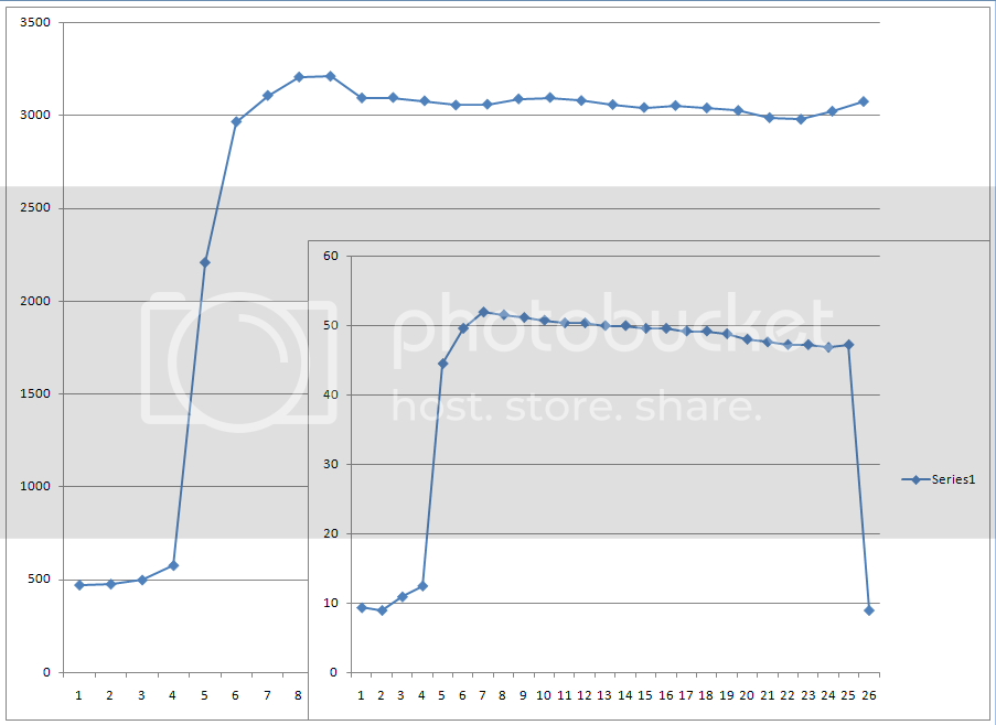

Here's a sled pull data log. Forgot I put it in photobucket.
ICP and IPR.

Chvyrkr
2,205
What did you log this with? I'd like to be able to do something like that...
AE, then I dropped it in a graph to make it look pretty like Tom did with all the different pumps a couple years back during Adrenaline War 1.
Awesome data log Tom. What sized injectors.
Just 160's. I thought the pump did a pretty good job building pressure as soon as IPR adjusted though.

Blowby
1,532
Autoenginuity 11-11-11
  • Logged in OD.
  • Swamps Stage II 175's.
  • 254,656 miles on engine.
At data log:
  • AD has 32,956 miles.
  • Rotela T6 5-40 with 2,479 miles on oil.
  • Temp 55 deg.
  • Elevation 5320ft.
