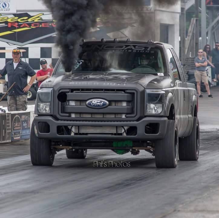

We do them for fun. Developing a billet bracket to eliminate the secondary water pump, but still retain the factory belts. Easiest way is to run 6.0 intercooler and radiator, and make custom piping. We are working on one right now actually. It's a bit of a project, but worth it for higher HP trucks. We never had good luck with factory or factory style intercoolers at 4 digit power levels. The one we ran on our race truck last year was a custom unit we made, but the truck didn't have a radiator so it was way easier.

Yeah let me get some pics. you can keep the Rad and pump in place, but the issue is that the stock rad is so wide, you need a custom IC to make it work and not look like dick. The removal of the pump and **** is mainly cosmetic, but i'm sure some science could be applied to make it sound better than that LOL

This is the best I have on short notice lol

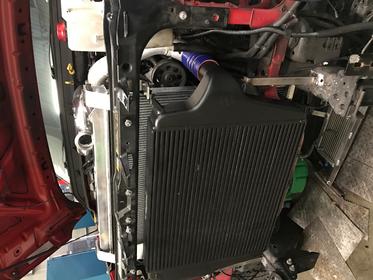

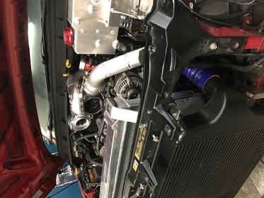

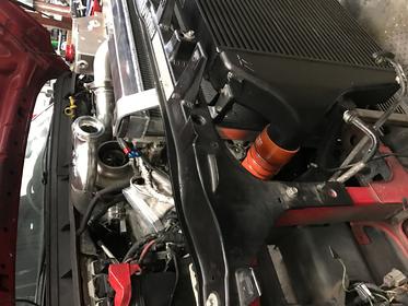

This is the one we are working on now with the 6.0 IC/RAD setup and secondary water pump removal bracket.
