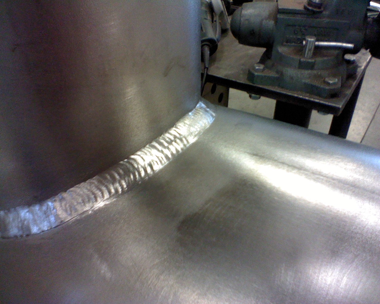

Here's some stuff I've done. Not the highest quality pictures.

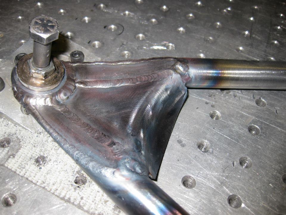

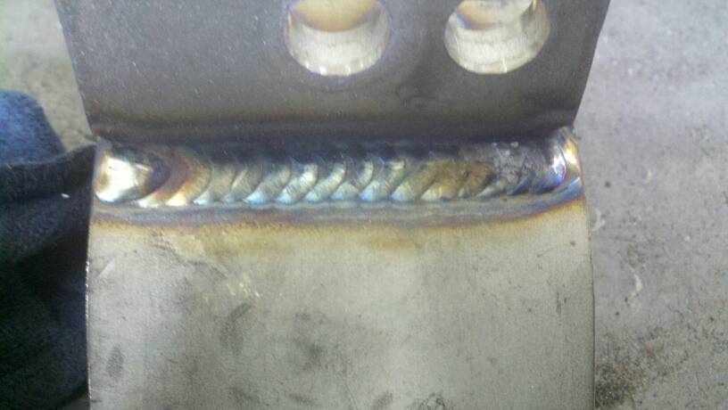

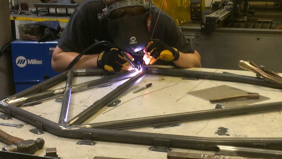

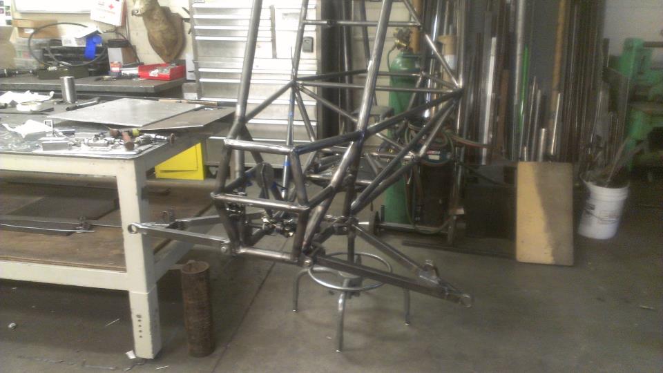

Ten characters.

That looks like a pretty sweet buggy. What are all the specs on it?
It's something I designed and built (well, myself and about five other guys) at school for the Society of Automotive Engineers Baja competition. By contest rules we're limited to a 10hp Briggs generator motor, but everything else is free game.
-CVT transmission
-2 speed final drive gearbox. 1 forward 1 reverse. Locked diff.
-Dual a-arm front 14" of suspension.
-4-link rear 14" of suspension.
Everything is built in house. We even cut our own gears this year.
Even with only 10hp to work with it will still chirp 25" tires on pavement with the CVT tuned properly. Weighed in at just a little north of 400 lbs, not including driver. Top speed is right around 30 mph.
Pretty fun little buggy. Even with only 2wd it will hold it's own on the trails against an ATV. Not much it can't go over/through.
We're doing a whole new chassis this summer, so the plan for the one you see in the pics is to slap a 700cc snowmobile engine in it and see what it does with some real power :D

With a new motor that sucker is going to be awesome! I've started studying some rock buggies and sxs's. With a little ingenuity you can build something that's almost unstoppable.

Yeah I'm excited to see what it can do with something other than a turd generator engine in it. I'm thinking with the low weight and 700cc's we should be able to outrun a 1000cc SxS once the CVT is tuned...at least in the bottom end.
