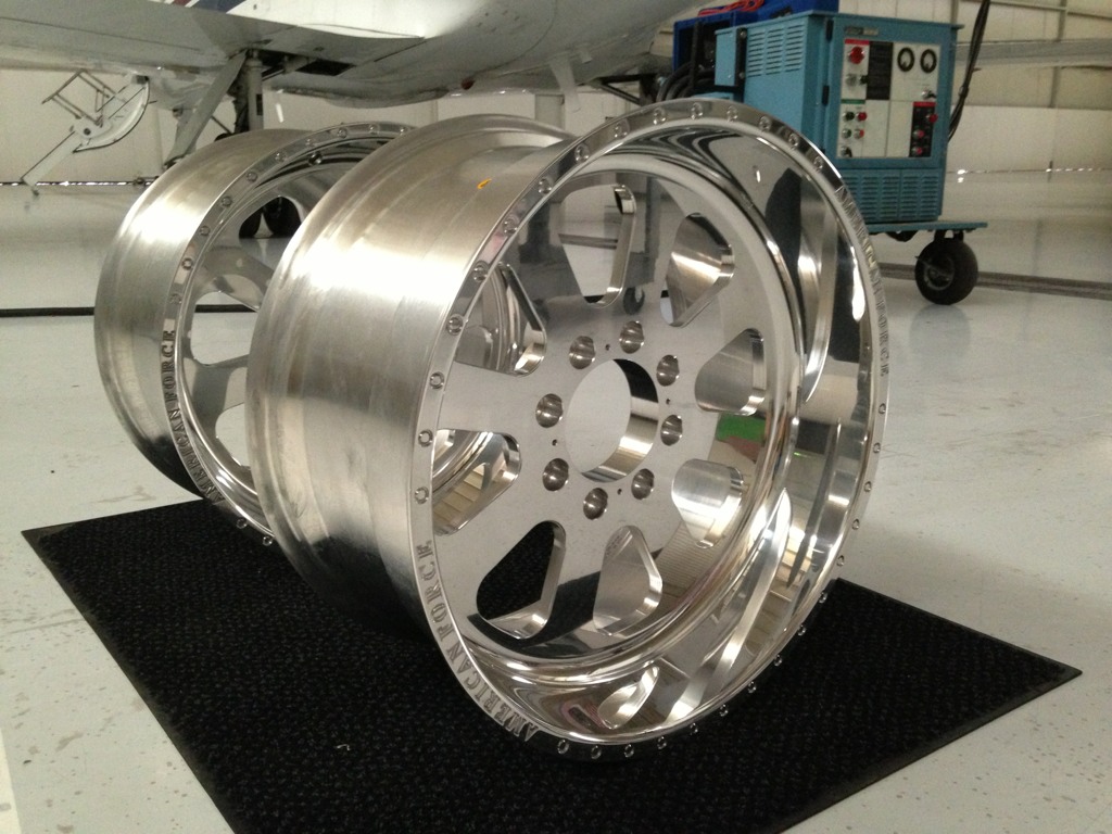

I spoke with AF techs today in detail about this and they assured me I would have no contact on the radius arms with the 22x11(0 Offset) and a 325/50/22 AT tire. They also said because the setup is less aggressive than the 22x10(-25 offset) there will be minimal trimming (most likely just inner fender) with a leveling kit installed and will stick out approx .5"-1" less than the 22x10. Just for reassurance he told me he just did a setup for a guy on his 2012 F350 with stock suspension using a 24x11(0 offset) running a 325/45/24 with no radius arm rubbing! That setup is I believe around a 35.5" tire vs my 34.8. I am going to be the Guinea pig on this one and go for it. As we say in the aviation industry P.O.O (Parts On Order)!
1) Ready lift stage 2 leveling kit - POO
2) American Force Recon 22x11 (0 Offset) - POO
3) Dynapro ATm 325/50s22 - POO

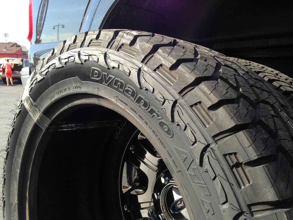

Tires showed up today. I hope they perform as good as they look. After calling around to about 20 different tire shops in the area I was able to score them for $371/tire... and yes they are 2013 s/n's.

I had the guys mount one of the tires this afternoon as a test fit before everything gets done tomorrow and I couldn't be happier. I will get detailed measurements and photos up later but here is what I have so far.
With the AF 22x11 (0 offset) and Hankook Dynapro AT 325/50/22's on stock suspension the only thing the tire rubs on lock to lock is a small portion of the inner fender liner! No front bumper mount rubbing, no radius arm rubbing. Of course this is all stationary without bumps and potholes and that is why I am leveling the truck. Here are a couple pics from this afternoon.
