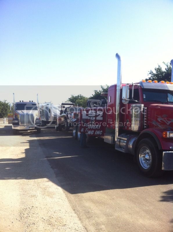

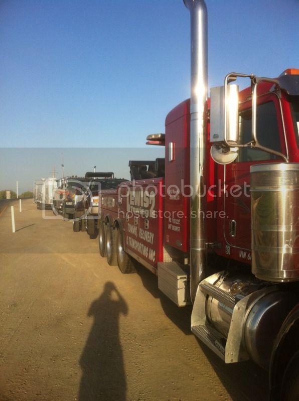

Thanks everyone very much for all of the extremely kind jesters to get me home but it worked out that AAA payed to get everything home. I guess the saying is Go big or Go home and I went big and went home but at least I went home big LOL
Then it turns out we were 17 ft over the legal limit so we had to have another wrecker come out and get the toy hauler

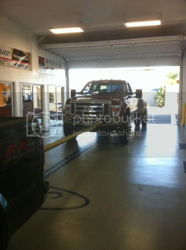

And then once I got home the next day my best friend friend pulled me from my house to Ford
But at least I get a OUO lifted truck as a rental while mine is down :rockon:
