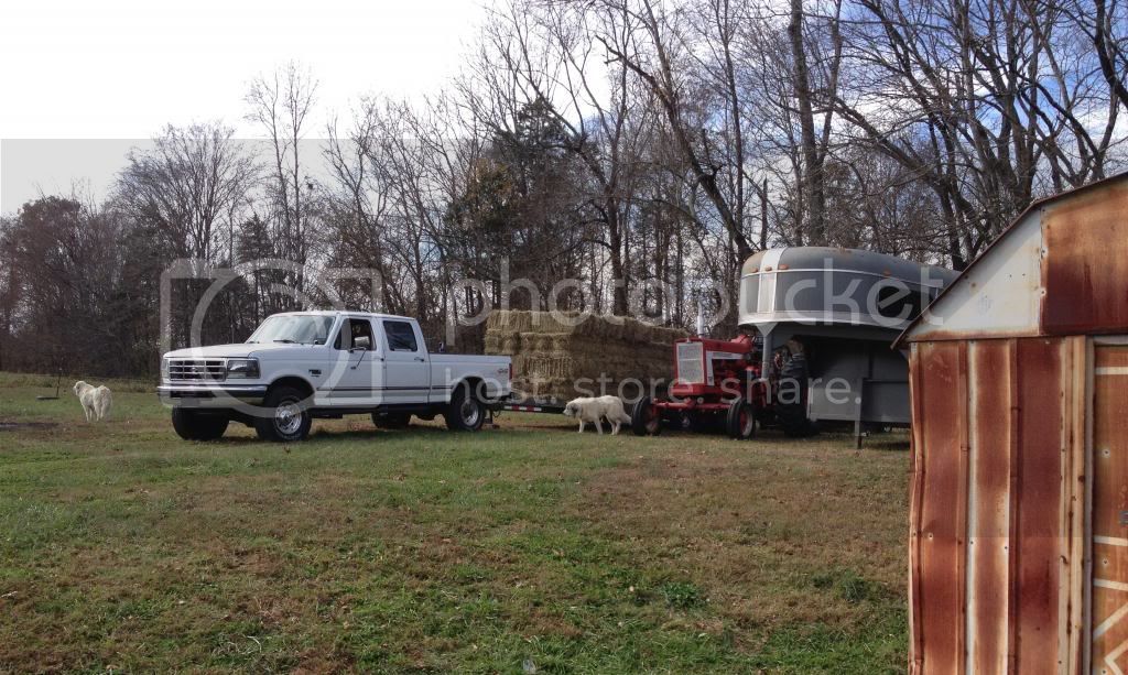

Just another thought, my OBS has 160's, an Adrenaline, and an Efuel system I built with my own three hands...
It's pretty damn fun, and without an IC and with the stock turbo, I doubt I'm much over 300, if that.
But at 7000 pounds...

Is it tuned?
Chvyrkr
2,205
Well, it carries the front end through the 2-3 shift, and blows the tires off if I give it even a small amount of boost on the start so, maybe a touch over 300...
Or maybe it's just a light truck.
