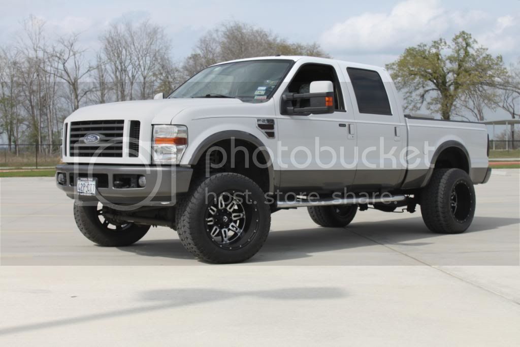

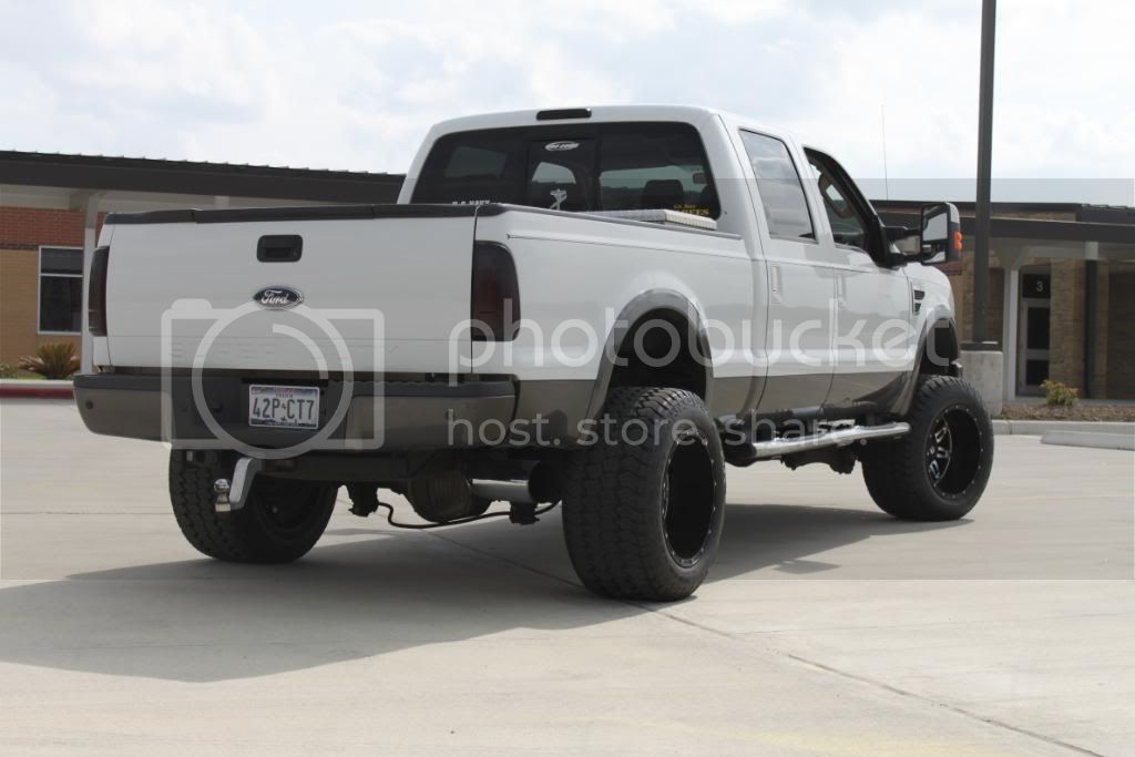

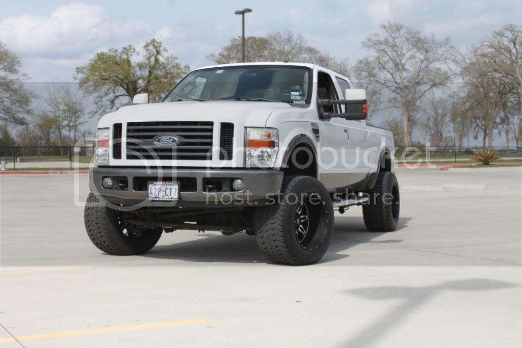

You could do it as long as you never had to make a turn, I just took my 20x14's off this week and replaced them with some 22x10's. I couldn't go any taller than a 34 without major rubbing, I ran 355/50R20 ( 34x14.50x20 ) and this was on a 6" lift. You can get the same wide stance look your going for with a 2.5" kit and some 12 wides and 13-13.50 wide tires. I'll be selling these 22x10's soon for a set of 22x12's since I just dropped it down to a leveling kit to achieve the same look as I had with the 14's. I was just tired of the lift and 5 point turns LoL.

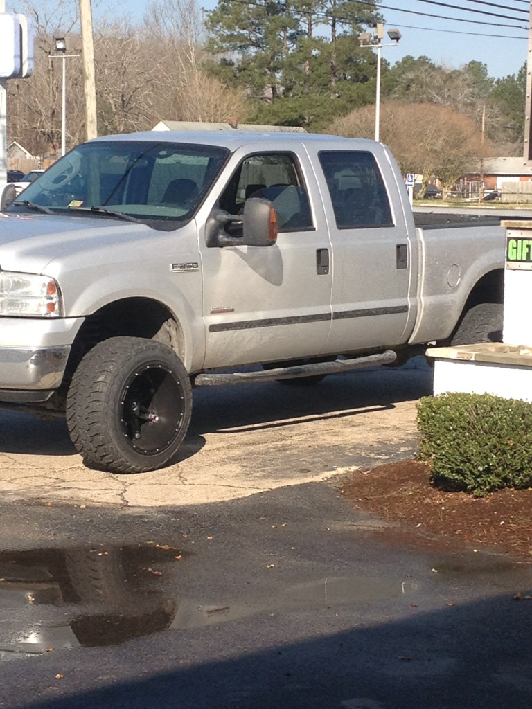

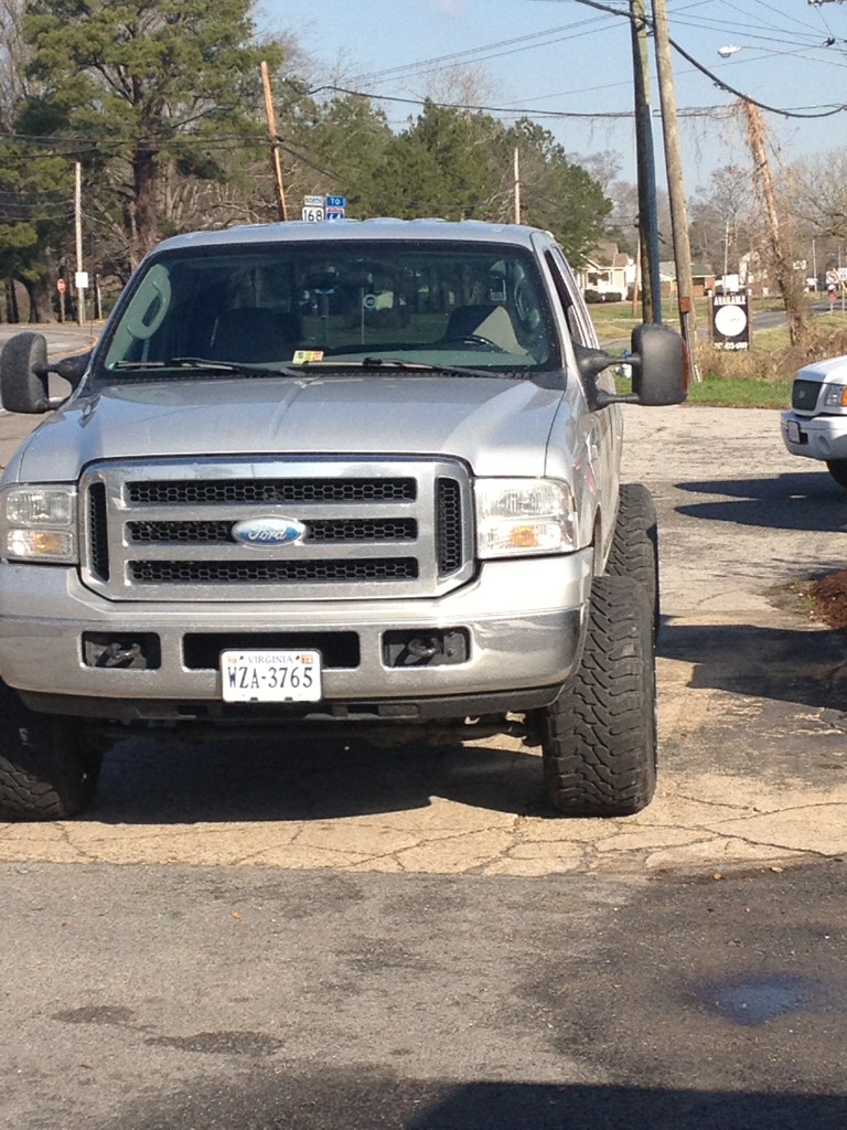

what size tires do you plan to run with the 22x12? a 35?
currently i have 35x12.5 on 20x10 wheels stock suspension with a fab four bumper and I only rub at full lock, the plan is to either go with a 20x14 on a 33x13.5 or with a 22x12 and a 35x12.5 with the2.5 leveling kit I have on order
