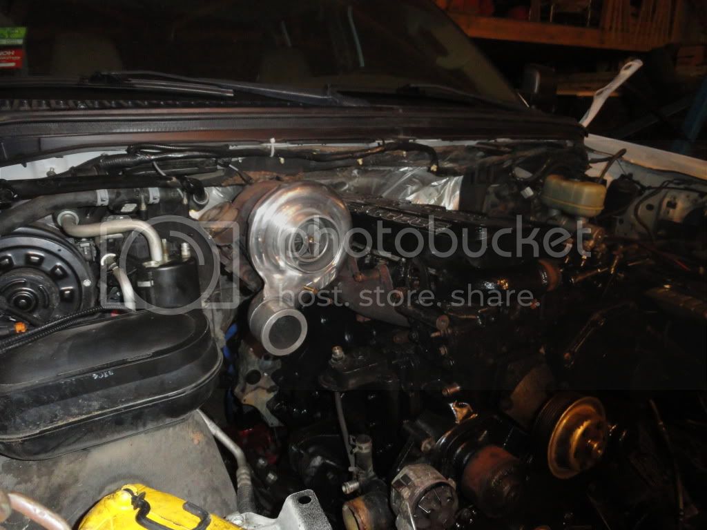

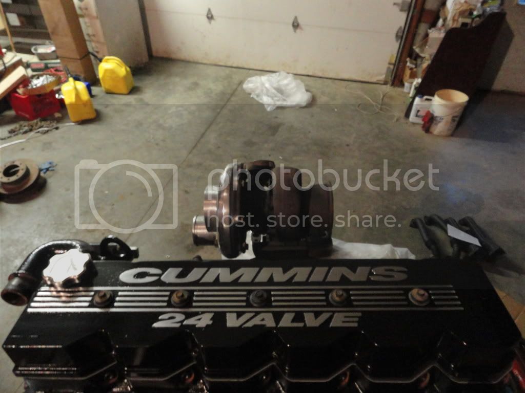

Mine isnt a mirror finish, and unfortunately its not looking as good because my dumbass forgot to clear coat it but I polished the cover on my 66, Jason polished my valve cover and cleared it and it still shines real nice.
My turbo was so dirty I started with a fine wizzer wheel on an air tool then went to 320 grit, then 800 grit then 2000 and then buffed it with polishing compound on a bench grinder, this was the outcome:
Like I said not the best by any means but it got me by on the cheap

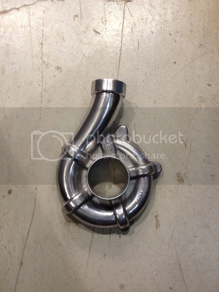

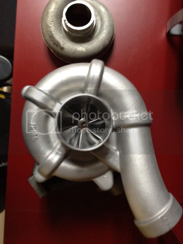

Anybody figure out a good way to get in the corners? There has to be a better way than just sandpaper and finger.
ColtonP
Sep 13, 2011
1,561
Tyler, Tx
I finally found a rock small enough to get most of it. Still have some I can't get to though.
