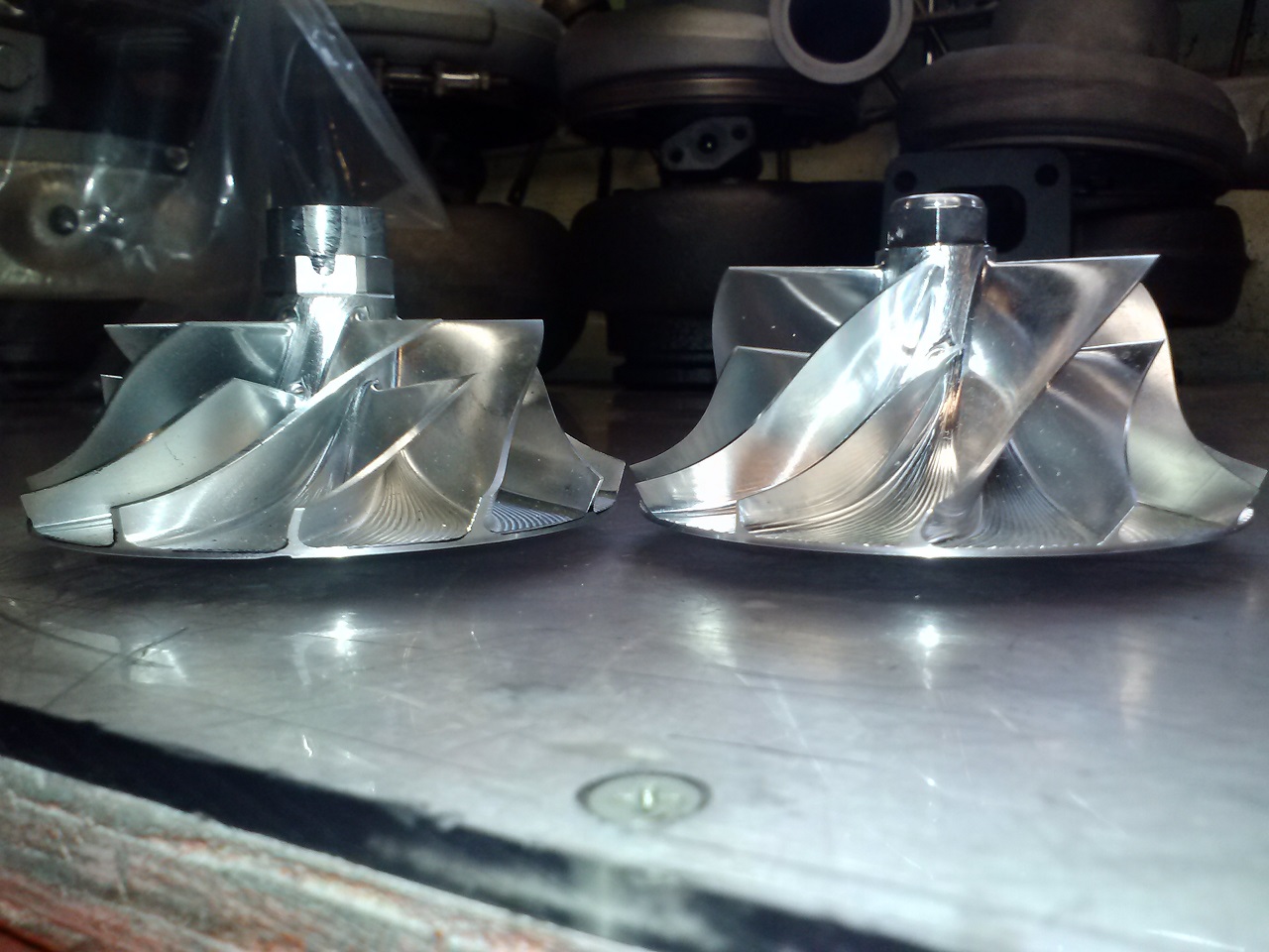

correct, dieselsite 38R WW, billet 66mm inducer, 92mm exducer iirc (dont quote me on that)
*the stock 38R wheel is 66/88
Barders wheel looks different, like a BW wheel with the extended tip, which does work well in BW turbos.
its the idea of increased cfm through the stock frame thats intriguing to me..... should be similar flow wise to D66 and BD thruster and easier on the wallet as any 66mm bolt on with a comparable wheel will be 1500+ $ (turbo and billet wheel)

Curious how a drop in replacement wheel can be larger than the one it is replacing.

Its the same exducer where the wheel is flat on the back, But the blades extend past the exducer base of the wheel to a larger exducer blade tip. Hard to explain but there's room to do it.
