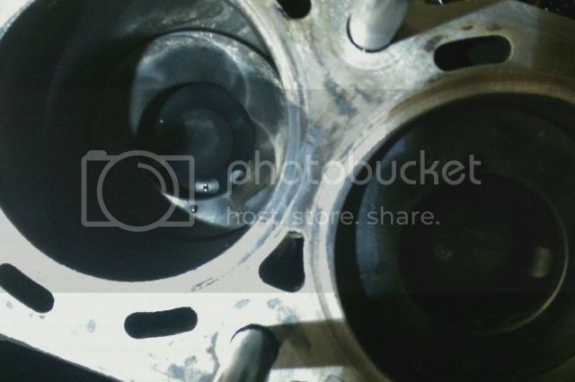

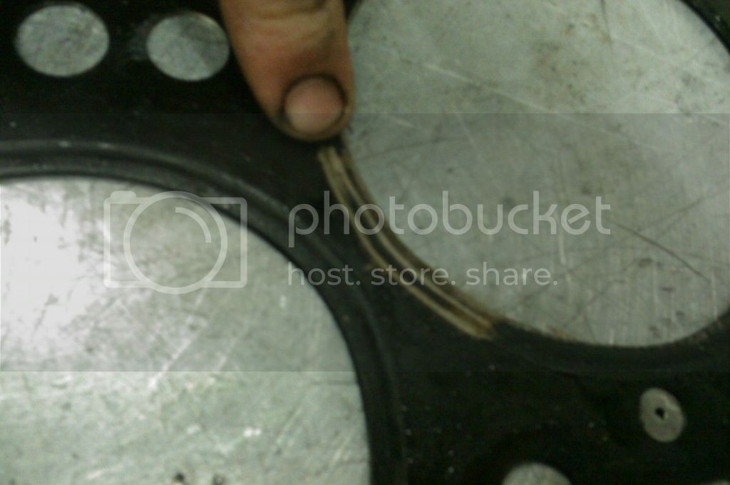

Note that the coating is absent from the failure point. Also note that the failure point is directly next to the exhaust valve on all but the end cylinder. I suspect the gasket can't handle the heat at the adjacent cylinder, explaining why the gaskets were blown in exactly the same relationship to the head on both sides of my engine. The drivers rear and passenger front cylinders not having lost their seal.
