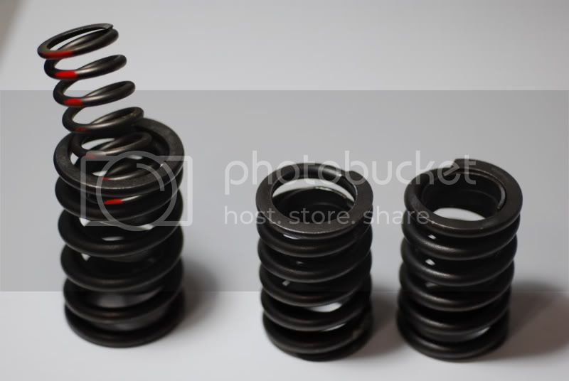

I remember that vid. I should be good, seeing as i have 910's shimmed to somewhere around 130lbs of seat pressure. Although that doesn't mean a stock rod won't bend under those forces.

I like the 910's. I didn't need to shim them as on the 2 cylinders I was able to test, they were close to 130lbs. Now days...
I got them from Nate or Hotrodtractor years ago. OMG. Talk about a PITA to get setup..
